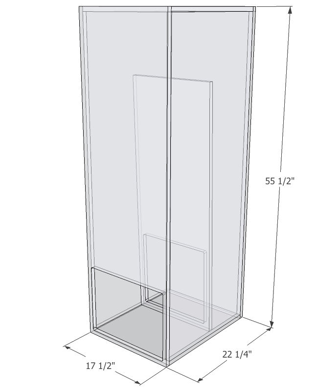

Here's a 285L positive flare TH. It's the same height as NEO Dan's negative flare 301L TH. It has a 17.5" W X 22.25" D footprint. The mouth is 16" W x 12" H. 285L TH = 121 dB's @ 30hz. 301L TH = 123 dB's @ 30hz.
If you can see the grey line, then that's the 301L TH curve.
LOL, Kawasaki Racing colors! I really like your box! I might build it for temporary use in my F150 Super Crew. I really want a FLH so I don't have to use a highpass filter for home theater. I can't match our 285 & 301L TH's. I'm at 375L & 120 dB's @ 30hz.
Grey = 285L TH.
Here you go. Simple build. No angles. 67.5" H X 17.5" W X 18.25" D. This Tapped Quarter Wave Pipe has a constant 8" x 16" diameter. The 15L7 has an 8 11/16 mounting depth. With 0.75" (19.05mm) stock, you have 1/16" left to clear the magnet.

I see this is an older thread but hopefully somebody that was involved will speak up. I have a early 2000s L7 15D2 that I currently have in a large ported box tuned to 25hz in my HT. After seeing this and another thread using these in tapped pipes I really want to try it too. I'm very new to this design. My question is would it be possible to move the tuning frequency down to 20 or 25 Hz by simply making the pipe length longer but keeping the cross section the same? And if so how much longer? I'm thinking 30hz is a bit high for HT use. Thanks for any help I can get!
