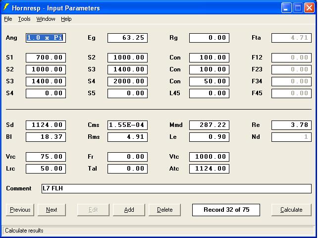

I know he has a L5. He asked for an extended version of my previous pipe. All he has to do is plug in the L5 speaker parameters and see how it models with the L7 enclosure parameters.
Hmm, he claims to have a L7 15D2, which has identical specs displayed in HR except with 6.28 ohm.......... As it turns out though, the 08S15L74 has some different specs, yet display identically in HR except for the 7.1 ohms. Wonder what the odds are on that?

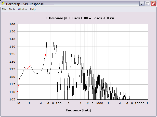

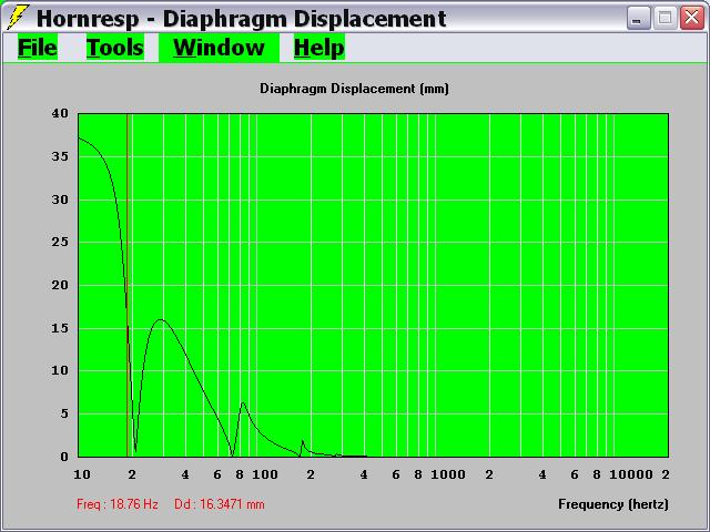

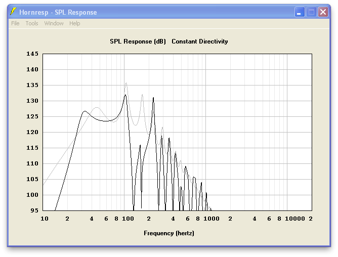

Don't know, you need measured specs to be sure, but based on the published specs I have, it has a horn BW = ~7 - 99 Hz, so can go lower, though don't recommend lower than ~13-14 Hz.
Of course the lower it's tuned, the less peak SPL across its usable BW and the lower the first notch will be, so tuning it lower may require a lower XO point.

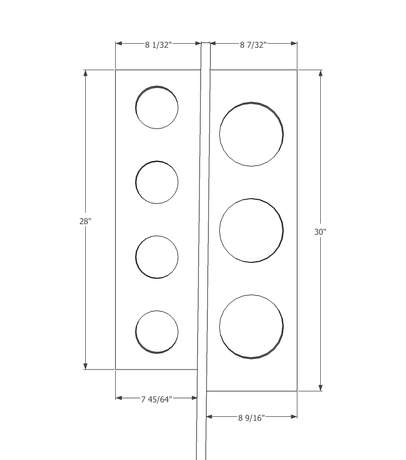

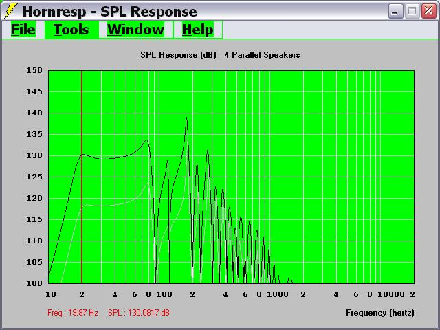

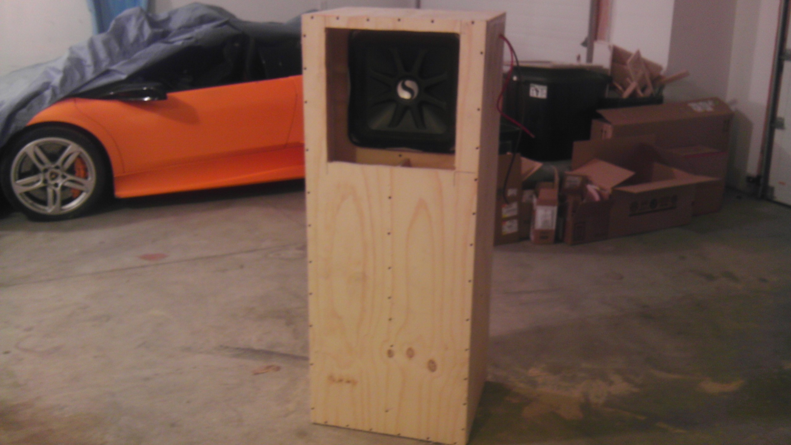

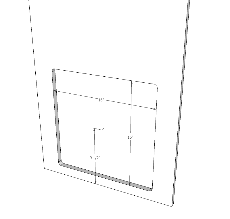

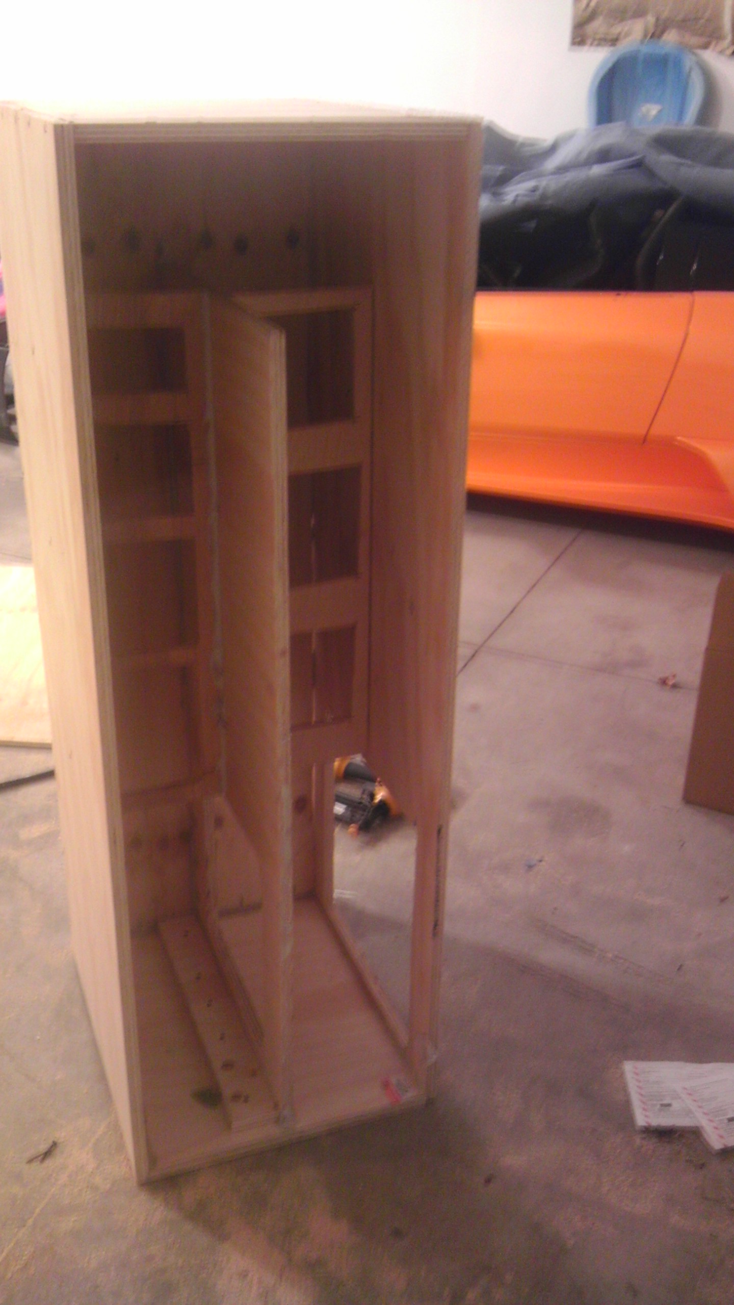

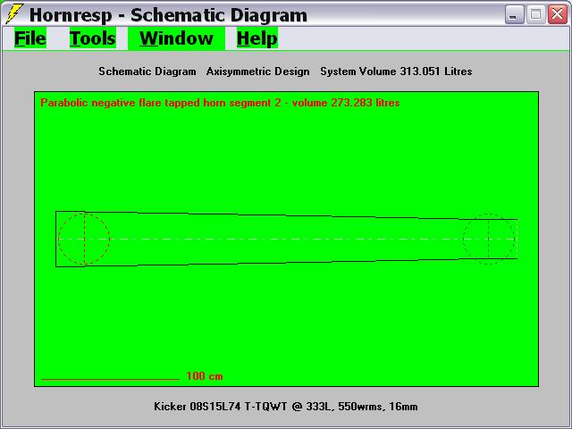

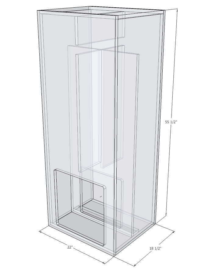

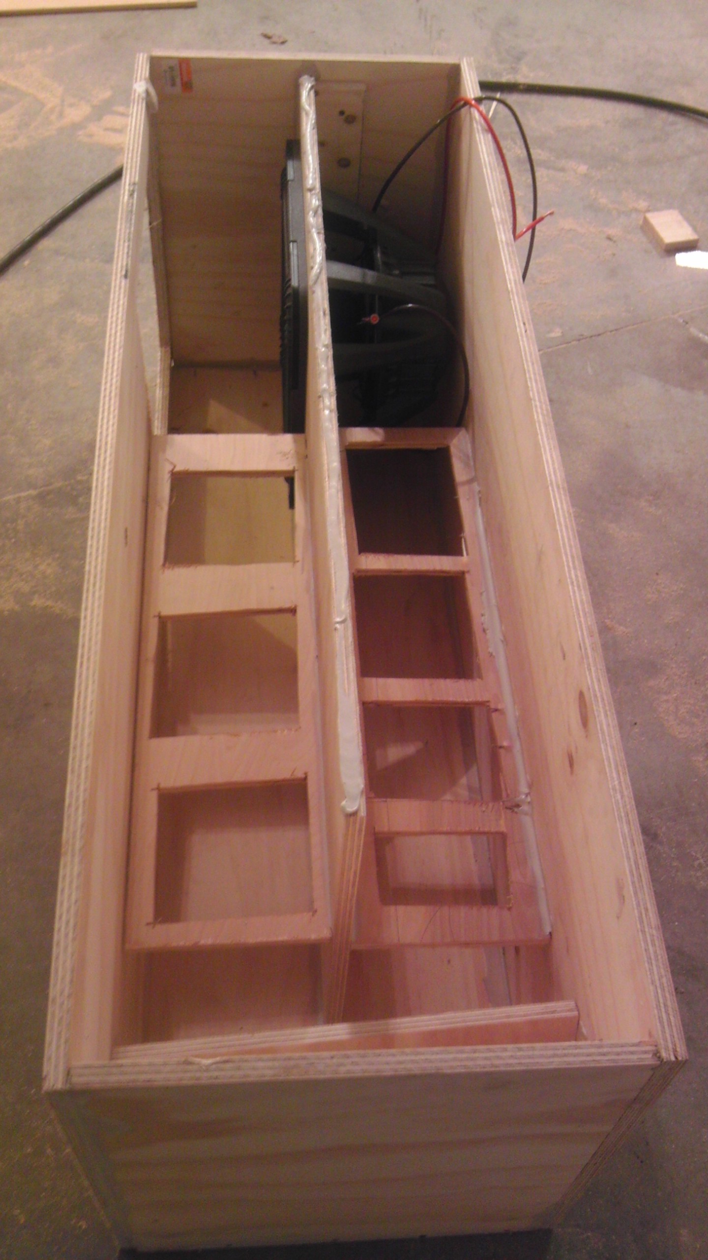

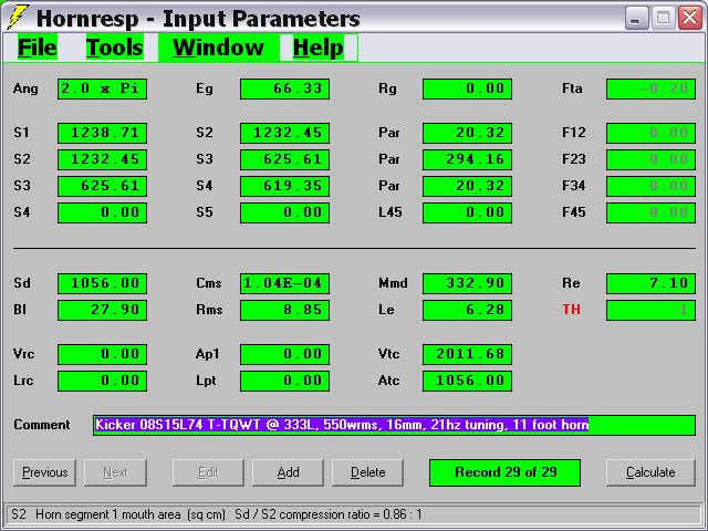

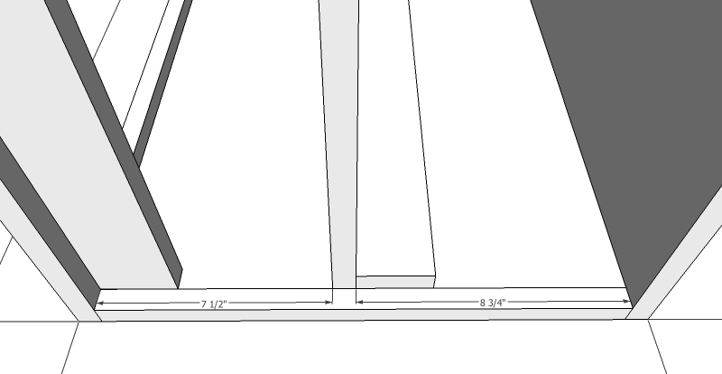

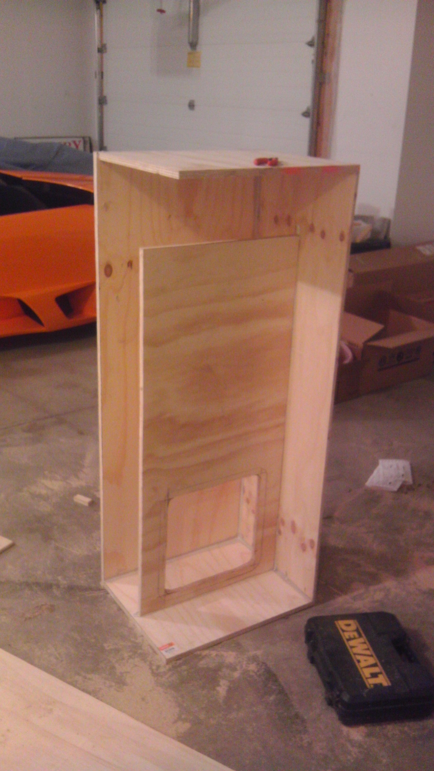

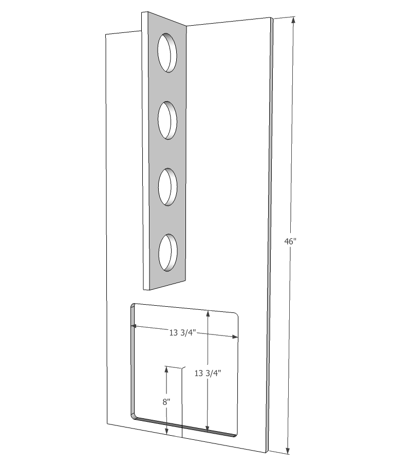

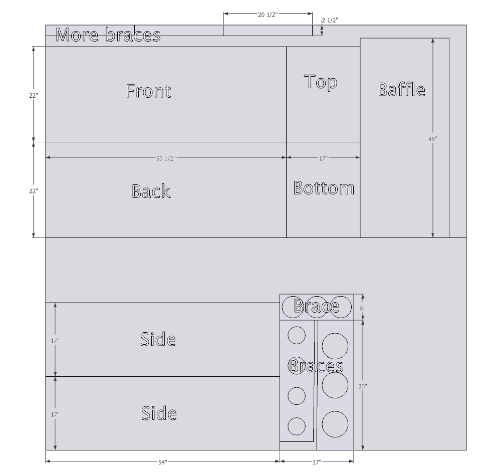

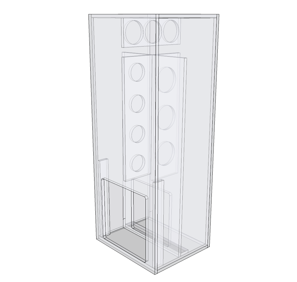

That design is not a true tapped horn. It's a tapped quarter wave pipe (TQWP), straight flare and EASY build since there are no angles to deal with. A true TH has a positive flare, is more efficient, and requires a bigger box for the same 19 hz tune. If you want a wide frequency response and smaller box, then a tapped-tapered quarter wave tube (T-TQWT) is what you want. T-TQWT's have a negative flare and are less efficient than TH and TQWP's. I built a T- TQWT for my L7 because I wanted 20-80hz. I would have built a bigger enclosure if I had bigger spare pieces of wood lying around. I'm cheap! My wife & kid bought the L7 for me for xmas in 2008. I would have NEVER spent $300 on a single sub for myself.
How about 130dB's @ 20hz with 550w @ 8ohms (1100w @ 2ohms) in a room corner or van/suv???
16" W x 12" H to 16" W x 6" H internally for 11 feet. Double fold box with 0.75" stock = 35.25" H x 39.75" D x 17.5" W externally.
