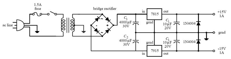

it needs a 15+15Vac 2A transformer (60VA), but this will not power a chipamp particularly well. Peak current ability is lacking.
post 22 works. But look at the ripple, 1Vpp, for an output current of 0.1A. Again this cannot run a chipamp.
Just go and buy the correct transformer. If you are patient you may pick up a bargain.

Both of circuits have disadvantages.doomsweek said:
The stabilized - because of useless additional power dissipation.
The second - because of unsimetrical positive/negative supply. The negative cannot deliver the same current. But if you use bigger condensers, it's possible to lower the difference in loadability.
