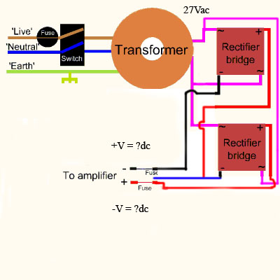

Like this?
I'm a little confused here. How much is the output voltage here? +/-27v or +/-54v?

your pic shows a toroid and your sizes seem more like a toroid.
The circuit shown in your pic will not work. Two rectifiers needs two secondary windings to give a dual polarity supply.
You can get a dual polarity supply from one rectifier with a centre tapped secondary, but your transformer appears to be single windings of different voltages and that is no good for power amplifier use.
For a split supply you need 2 seconadaries with the same voltage... which can be in the in the form of say 0V-26V-0V-26V, or a centretapped format 26V-0V-26V... or two similar single secondary transformers with seconadies in series to imitate the above..
