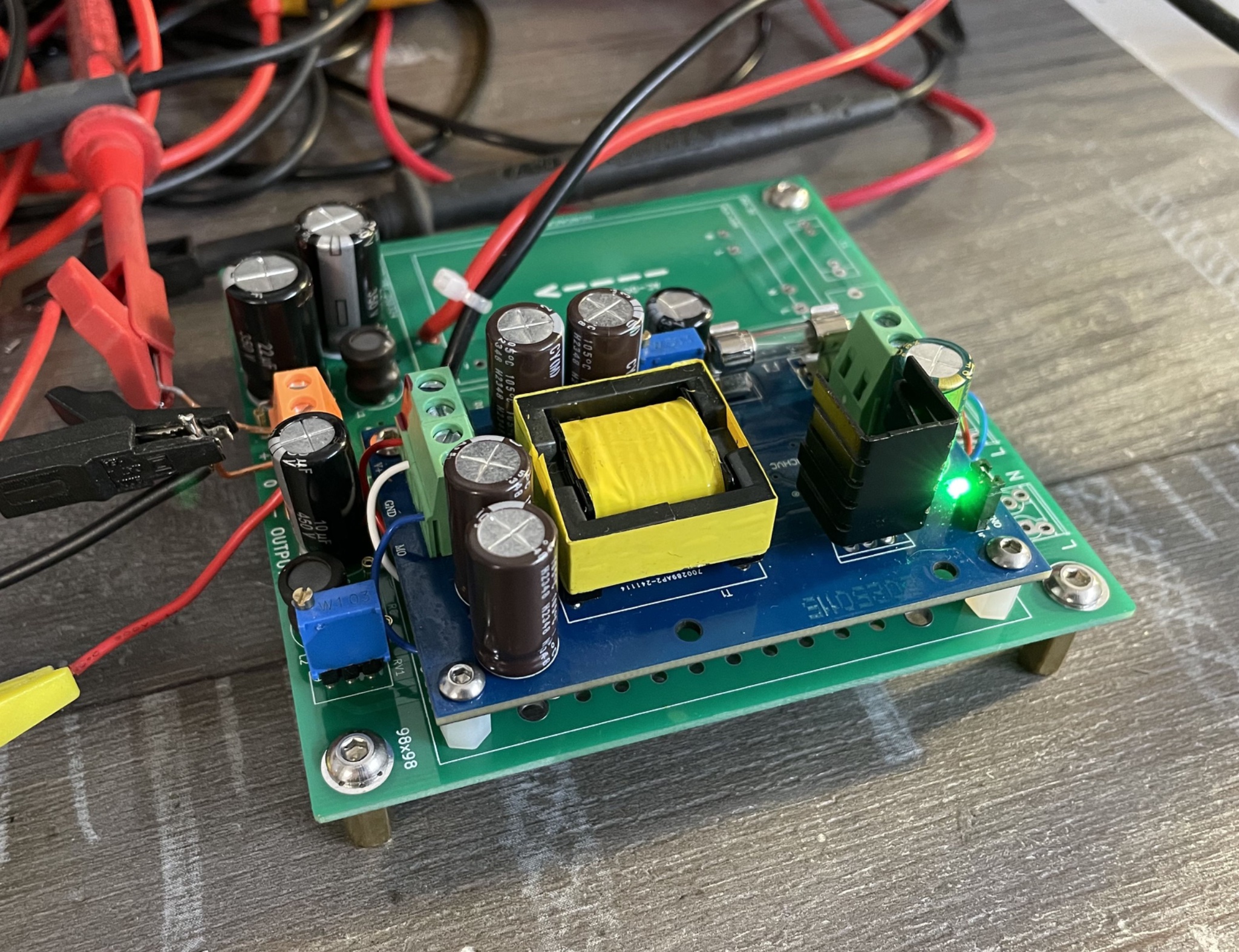

In addition to the HV module, I've also created a board to mount the module, add a 30 KHz output filter and manage the negative voltage for the BIAS.
https://github.com/stefaweb/audio-psu/tree/main/TUBE-HV-PSU-45W-1.0
So far, I've only tested it with HV Chinese modules at 350V/60mA and -60V.

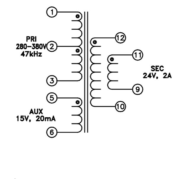

Red area: voltage regulator. But... why we need it? UC38xx allows for 36V max rating. We could use 24V directly. My project would involve max 18V.
Green area: why 2 primary in parallel?

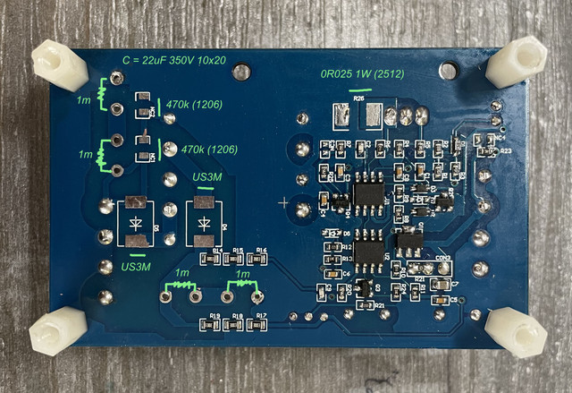

Yellow area: what is -HVo? Is it a predisposition to have 0 as virtual ground?
Why are these caps doubled with 2x 1M resistors? Why not just 1 cap and 1 resistor?

Green: look at the Wurth transformer specs. The transformer is upside down.
Yellow: the module can output more than 500V. It's less expensive to use low voltage caps. Caps over 500V are also hard to find. The 1M resistors are used to balance the caps.

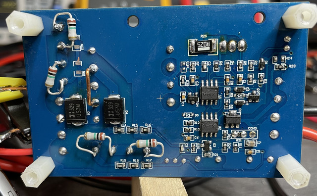

The "-BIAS" is used to output -150V/-200V to control a tube's BIAS (no load) with the second PCB which contains a divider bridge to go between -30V and -80V. It is experimental. I have not yet tested this configuration with my module. It works with the Chinese blue module that I tested as a prototype or I even put 2 diodes on the same transformer winding. The problem with the blue module that I tested is that the transformer is too small. We can only output 15W. The yellow module does not work and is even dangerous (among other things the overvoltage circuit is defective and it outputs 650V at times at startup).
The module's frequency is 47KHz, far outside the audio range. I added a 30KHz filter at the output on the second PCB to filter out anything coming from the AC-DC power module (as the IRM-45-24).
Finally, the schematic is one thing, but the most important thing is how the PCB is made (Look at the ground planes on the PCB around R5). Chinese modules are particularly poorly made, even though their schematics themselves are functional.
I still don't get it. That symbology means one sec is wounded around the other sec? What does that imply? Stronger inductor I guess. We lose half of the potential of the trafo if we skip one of these wounds.
So, D1 create an half wave rectifier.
D2 does the same but for the negative part of the wave (negative voltage) and I question if C12 and C13 polarity is right.
A SUGGESTION:
The 15V aux (Wurth pin 5 & 6) could be used to feed Tube heaters like with a LM317 @12.6V if we don't want to take it from UC3845 source.
