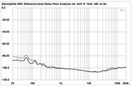

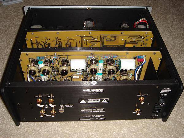

In my experience comparing the subjective results from various valve and Jfet, op-amp, BJT, phono I have made, although when covering the vinyl's SNR it will not obviously add noise when actually playing, the lower noise floor circuits pass more detail still. Could understand that also by comparing perfectly adequate regs with even quieter and more dynamic ones. Especially under 300Hz where the Riaa gain is high and the corner noise frequency of elements progressively worsens their noise curves, some readable noise floor lowering on the FFT comes across like easier to follow bass lines, beats, and male voices. A doubled up JFET 58dB (DT makes 43dB, less noise gain) shows -107dB @ 20Hz for -10dB 1kHz signal ref 0dB 1VRMS from a 15R 0.3mV source. At 20kHz it hits the particular FFT's limit at under -140dB noise floor due to the Riaa shape and better en higher up. You got to see some same conditions full sonic BW FFTs from best tube stages for noise to have an answer to the original question of how they compare. SY's is one of the best, I would recommend it as tube alternative, and it will be nice to see, if he will be kind to provide a full spectrum chart at 300mV 1kHz out Ref 1VRMS 0dB with good visual octave spread in the lows. An input transformer actually holds a benefit for both low en tubes and Fets since it shows them a higher Zo that they feel better with for noise lower in the spectrum. Alas, the secondary's resistance adds Rn, back to near square 1 at 1kHz & up, but the total noise floor curve is evener across the sonic spectrum. The 58dB double Jfet chart in is the green on black. Source 15R atn cable on input, I.e. almost grounded. Cable lends -90dB hum pick up. Totally open flapping about input is next green chart.
P.S. I found this on Stereophile for AR Ref phono ''While many designs (including AR's PH3 and PH3 SE models) use solid-state-based "head amps" to boost the ultra-low voltages produced by some moving-coil phono cartridges, the Reference uses a pair of premium Jensen transformers to give the High Gain input an impressive 69dB of gain (63dB is available as a factory-installed option) with ultra-low noise specs—and no transistors in the signal path. The Low Gain input, which bypasses the transformers, gives 48dB of gain (43dB is available as a factory-installed option). Both inputs are compatible with moving-coils, and while AR gives you a guide as to which input to use with an MC cartridge of given output, some models will fall in between, in which case use the input that sounds best.
"Eleven dual-triode 6922 (6DJ8) tubes handle the amplification. Passive HF equalization is applied to the first group of tubes, while the LF boost is achieved through an active feedback circuit.''
And its noise floor measurement, to get a picture for DT's question in general. Referenced 5mV input at 51dB measured gain (low setting). There is probably some triode paralleling going on in the head amp hinting by the number of tubes used BTW.

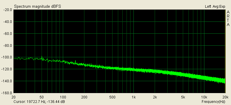

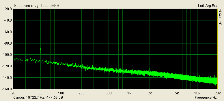

Salas thank you for your post including attachments. I will take it as a yes that valves can have respectable noise performance. Also thank you for reinforcing the importance of the power supply in the amplifier.
DF96 I am not convinced that a common cathode stage versus a cascode stage is a coin toss in the realm of noise performance (speaking theory). Given the same valve in circuit the cascode has higher gm. Could be using an RF valve in an audio circuit everything is low frequency with flicker noise (1/f) increasing in importance?
Looking at the FFT’s valve Riaa noise can be black as my photo dark room. Dark enough not to fog the Ilford film.
