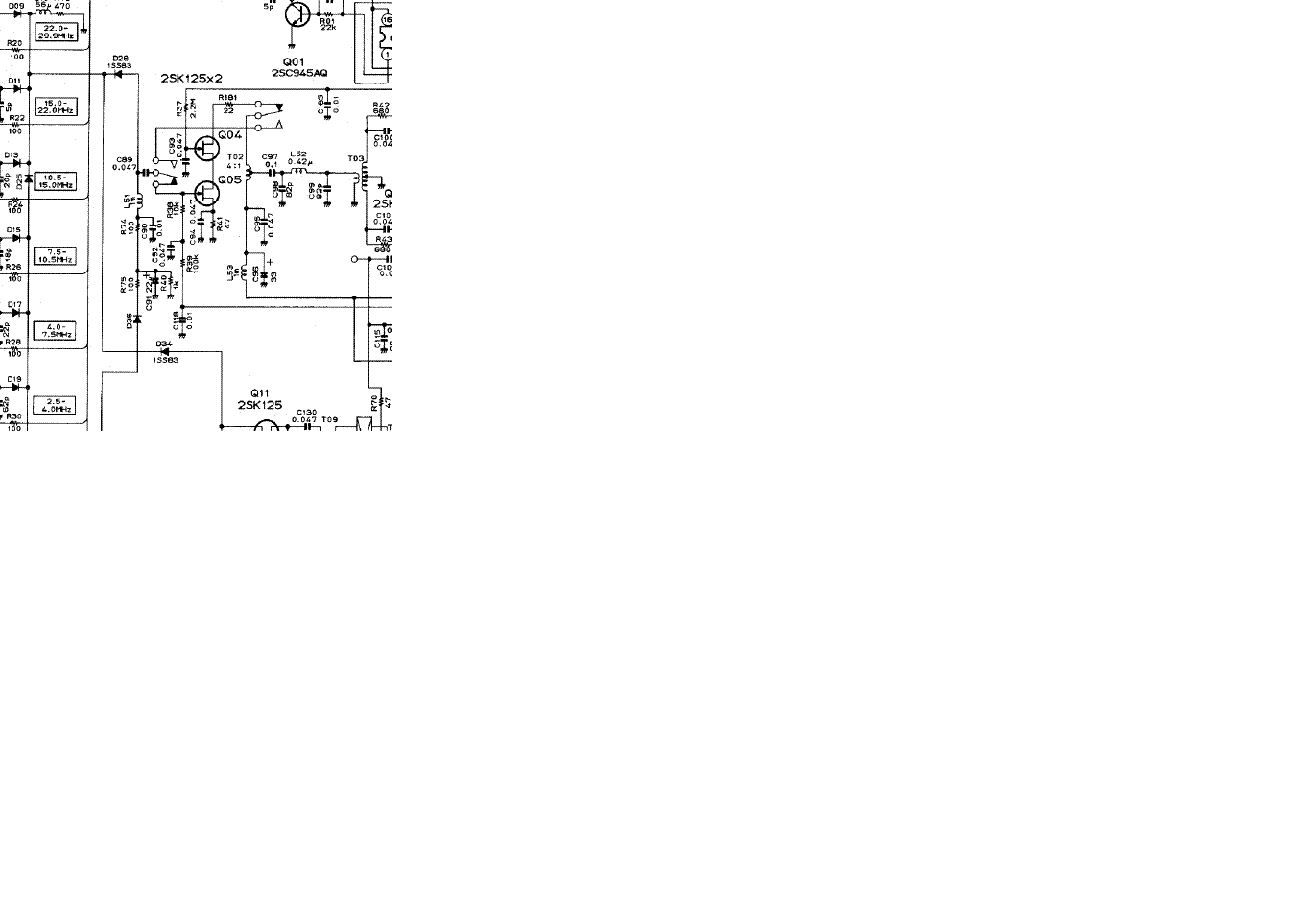

Cascodes has been used in front end of FM and TV tuners because of the low noise contributions (between other so important particularities), I also have seen it in some ham radio receivers, because of it important property (In fact, my Yaesu FT 767 has one inside it made with two FET´s). It is clear it laks the partition noise as pentodes have, but WHY is low noise, is still a doubt.
