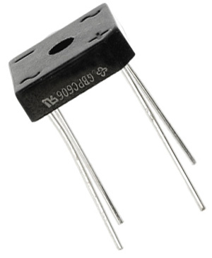

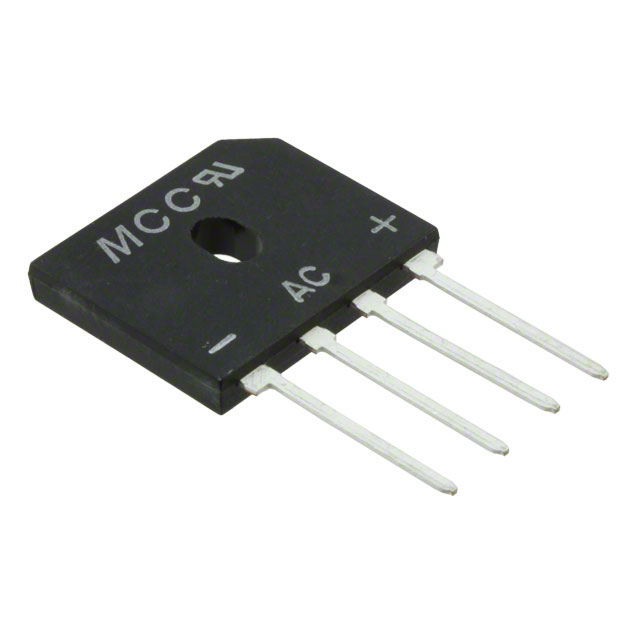

I guess my post was too far back (started this thread resurrection), I'm no EE, but pretty handy. I've got an old alt. rectifier which seems WAY overkill for such a project. Is there a rectifier that's usable in a garden variety PC power supply that I could use? I'm not exactly sure what I'm looking for, as the diodes will/should be different in the PwrSup than in the Alt. rectifier. Also, I thought I had to get a big cap (run/start) and connect in parallel with the A/C circuit, these recent schematics show the caps in series 😕.
Yes, the cap goes in series with either one of the AC lines into the rectifier.
The bridge rectifier from a PC supply should look like one of the images below and be OK to use...
