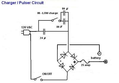

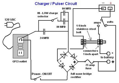

Try this. It worked for me.

Interesting schematic. Can you explain the purpose of that stainless steel bolt and what is that item in the upper right hand corner? A small cell battery?
Second question: does the GFCI trips when you accidentally touched the "target battery" desulfator tips? I assume it detects leakage current through your body to earth ground?
All the capacitor(s) do is to act as a "resistance-less" resistor, in the circuit.
1/(2 pi F C)
1/(6.28 x 60 x 0.000024)
= 110 ohms
Therefore, at 120 VAC, it'll pass about 1 amp. Substantially more than the original diagram with the 25 watt or 60 watt light bulb. But, the nice thing about using a capacitor is that it is (almost) lossless - not heating up like a bulb or resistor. Incidentally, one could substitute an inductor! (Z = 2 pi F L ... and if you want Z = 110 then 110 = 6.28 x 60 x L ... and L = 0.3 henry) Same idea, lossless current blocking.
