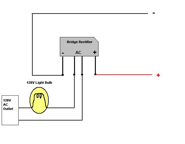

120V DC Lead battery desulfator! Lightbulb and Bridge Rectifier!
Hello folks. The lightbulb trick for testing amps is great, and familiar around here, but there's also other uses for them, along with a few additional parts....
(See schematic photo for details)
I wanted to share some valuable information with you savvy folks.
Don't throw away your old 12V car batteries!
When a battery is bad, it's because it won't take a charge anymore (AKA battery no longer conducts electricity) so the battery never gets charged. That's because a dead battery has insulating sulfated lead plates - from sitting around dead for too long. or never getting a complete charge.
However, that only applies to a regular 12V charger! A bad battery may only conduct a few mA, or none at all from a typical charger, so the battery voltage rises to 15V+, and the charger falsely detects a full charge, and never charges the battery.
Now if you force 10X the nominal voltage, and give the battery over 120 Volts DC, despite the sulfation, the battery WILL conduct electricity, and start taking a charge.
The bulb will glow when it conducts electricity, and starts flowing current, which makes a great indicator.
Once the battery starts conducting, the voltage will be about 25V for a split second, then drop to below 12V gradually, then start rising again as it charges!
Being the 120V desulfator is really low current, once the battery has been treated, you can put a regular charger on it, and monitor the battery voltage, and check for gassing. Or the best way, if you have the time to kill, is to leave the 120V desulfator on the battery for several days or even weeks depending on battery condition, for the best complete treatment.
Once the battery starts taking a charge again, it has to be left on a slow charge for a long time, then cycled just a few times to bring the battery to good condition.
The constant, unfiltered, nasty pulses from the rectified DC help to break up the sulfur, so the longer the treatment, the better.
A typical 60W bulb will use less than 500mA, and a smaller 25W bulb will use less than 250mA, so you can use a lower power bulb to save electricity for very long treatments, but for quicker results, the more watts, the better. These low currents pose no danger of overcharge or overheating for typical large batteries.

Does this really do anything but charge the battery? I mean point of desulfator is to send short pulses to battery that make sulfat or how do you say to resonate, and break it away from cells...
Eva wrote about this some time back, very great and understanding, what is the point and what is going on...
Steerpike said:
Looks worth a try! BUT noobies ought to be made aware that this sort of circuitry is exceptionally dangerous! A serious electrocution hazard.
True, very true.
It's obvious it has a potential for danger, which is why I never posted any warning.
I say keep the n00bs on circuits 30V or less, the big boys can play with high voltage. I recommend unplugging the cord whenever connecting, or disconnecting the leads from the battery to avoid shock. (as I have found out, lol)
Also, this circuit mainly charges the battery, but the high voltage forces current through the sulfur on the plates, which breaks it up.
I also have to add, the desulfator works great to start the charging/desulfating process, but works best in an overcharge state or on a full battery, because the very slow bubbling and gassing helps to chemically desulfate the battery.
Being that it's unfiltered 120V DC (162V peak) the pulses from the rectified DC do the job of desulfating. The battery voltage drops around 12V only when it starts charging again, and the internal resistance drops. A regular desulfator makes high voltage pulses anyway, just at a much higher frequency, but 60HZ line (120hz rectified) has been working just fine for me.
Also the high frequency desulfators don't always bring a battery from a dormant state, but brute-force 120VDC will. Heck, the 120V conducts great, even in plain water, and makes hydrogen bubbles on the clips, so it also will conduct inside a wet battery as well, forcing a charge.
You could try a regular desulfator once a battery is restored with the 120V cord, to even help further desulfate the battery, but in my experience so far, it hasn't been necessary.

Luka, The main goal is to make it accept a charge, more than just the desulfation itself. Because a sulfated battery won't charge anyway, but one treated with 120V will.
I also have an unregulated 12V charger, and I find just a few minutes on the 120V DC desulfator cord, will then allow the 12V charger to charge the battery. You just have to charge slow (2A or less) and steady to avoid excess gassing when bringing it back to life. However, it works best if used on the 120V for a few hours or days.
After a few charge/discharge cycles, the battery will gas less, and be very able to take high-amperage charges. One just restored may handle 10A, but after a while of use, I can give 60A charge without too much gassing.
seems a bit hard on battry if you ask me. I mean 160Vpk, it is limited, but still...I look on scope, and if it was pretty bad battery, it wouldn't be more then say 30v max... I gues since you have light in series, voltage willl never be higher then id needs to be... I just didn't know [never tested] you could do this with mains..
luka said:
seems a bit hard on battery if you ask me. I mean 160Vpk, it is limited, but still...I look on scope, and if it was pretty bad battery, it wouldn't be more then say 30v max... I gues since you have light in series, voltage willl never be higher then id needs to be... I just didn't know [never tested] you could do this with mains..
I didn't know either, or I wouldn't have disposed of 4 bad batteries over a year ago! :eek: It was just an experiment to see what would happen, and so far, so good, now I'm collecting as many lead-acid batteries as possible.
You got it. The lightbulb is a convenient series resistor, and if the battery is truly worthless or dry, the bulb won't light at all and you will have 120V at the battery terminals, but it's very rare that happens. The voltage on a workable battery doesn't stay over 20-28V for more than a few seconds at most anyway, before dropping immediately down to below 10-12V, and lighting up the bulb.
It's still only 250-500mA, so it's actually not very hard on the battery. However, charging on a regular charger after a fresh restore is, but IMO it's well worth the risk of possibly damaging a "bad" battery to try to get some use from it.
The battery holds its own terminal voltage pretty constant, and as the mains wave peaks, it just causes higher current to flow - most of the voltage is dropped across the series resistance. It doesn't seem to upset the battery at all.

One bad thing about this way of "charging" is, if your voltage is 14.4v or more, battery could overheat or even explode. So keep an eye on voltage
If the current is low enough (which it would be except for really small batteries), it will not be enough to be any safety hazard. In fact, "equalization" is often done on lead acids, which simply involves intentional overcharging followed by adding distilled water to replace the amount lost during equalization.
Exactly, the current is too low for any danger. I Desulfated a small lawnmower battery, and it actually went to a full-charge state after 12 hours, and it was slowly bubbling and gassing, but not so much to where it's dangerous.
Also on some bad car batteries that only stay up to 12.3-12.5 after sitting from a full charge, the 120V Desulfator eventually brings that sitting voltage over 12.6-12.8, because of that slow pulsating overcharge. After that, the battery will charge up to that higher voltage each time.
The battery doesn't usually get to over 14V unless it's small like that lawnmower battery. Usually it sits in the 13's because of the really low current. So far, so good.
The isolation transformer would be GREAT for safety, although not required. One problem with rectification off the mains, is either the positive or negative lead is able to make a path to ground, which can be a shock hazard. An isolation transformer would take care of that for sure.
Even on 240VAC, you would do the same exact thing, using a 240V 60W lightbulb, and a bridge recitifier. The amount of voltage doesn't really matter, because the lightbulb in series drops most of the excess.
