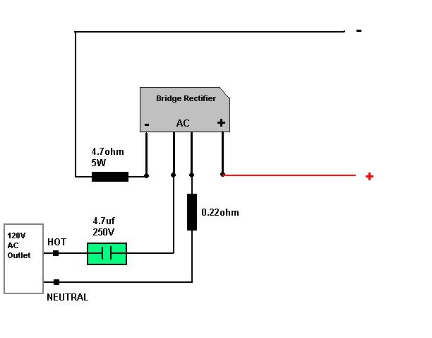

Update on the 120V desulfator charger.....
I built a new one out of different parts, and put it on some batteries.
This new one uses a 4.7uf capacitor on the AC side of the bridge rectifier. I also added a large 4.7ohm wirewound resistor for reverse-battery protection, and a 0.22ohm metal-film resistor on the AC side to act as a fuse under any faults.
I love the new capacitor desulfator. NO wasted heat!!!! No excessive power usage either!
I notice, the capacitor charger has a higher peak current than a lightbulb charger. When you put the clips to the batteries, I get a pop, like a small arc! I guess that's the capacitor charging, and that may help on stubborn batteries. I wonder if the peak pulses from the Capacitor on 60Hz, may desulfate a battery better than a series lightbulb that soaks up most of the energy.
I tried this new desulfator/charger on my lead batteries, but I even fully charged a small Ni-Cd with it. This seems like a rather safe charger, being there's no heat, and it charges with such a low current.
Now this one can be left on for hours and days, without energy waste.

The battery could have a single short-circuited cell. If so, no amount of charging will fix it, because no charge voltage can ever appear across the dead cell.

Just built desulfator second version with capacitor and resistors; use it on an other(not used for 8 months) battery: start at 11.2 v and 2hours later it is 12.25. This time seem to work ! But now what next ::: I wait until voltage reach 15/16 v or ?

Check the liquid levels. Add distilled water up to just above the plates if needed. Then leave the circuit running for a long time.
24 Microfarad capacitor per amp
Hi
This is a great idea. If you want the maximum voltage and at least 1 amp of current flow you can use a 24 microfarad capacitor per amp. If you connect them in parallel you can increase your amperage. Just be careful as you are dealing with live 120volts. Please enclose in a metal box with a fan with a cut out door switch. Sounds like an old microwave to me. You can also use the timing controls on it.
