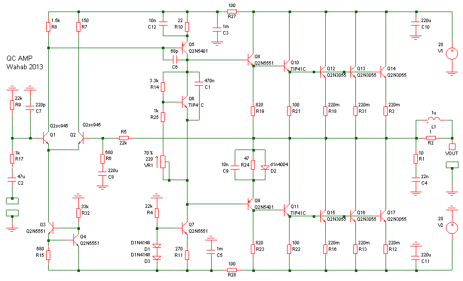

There has been a few schematics proposed , i will add this one
considering that it use what is available for the OP.

Exactly. It should work. I would make R1 4.7 ohms (or even 3.3). Adjust R8 - trim the resistor then put in a fixed value, do NOT use a pot - for best differential balance (equal current in Q1 and Q2). It will work with any reasonable value, but it will have lowest distortion when set properly. Adding a current mirror would help here but increase open loop gain and invite stability problems.
If there is a stability problem it likely will NOT blow anything and the usual fixes should clean anything up. Play with Cdom, add 100pF c-b an the predrivers, etc. On lower VCC's like this usually there is no issues. When you go to +/-80V is when things that used to work.... don't anymore.
Yes, the outpout RC network can be trimmed.
The differential current balance should be good enough with the values
selected such that no trimmer is needed for the purpose while as you point
it adding a current mirror deacrease stabilty with not that much improvement
linearity wise.
At 1khz THD should be at most 0.02% rising with frequency to 0.1%
at the upper side of the audio extremity but i doubt that this amp will
ever see a full swing at 20khz , wich it can accomodatre despite a 7V/us
slew rate , actualy with the considered devices one can hardly do
higher without running in instability.

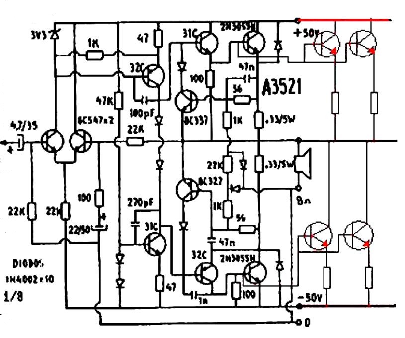

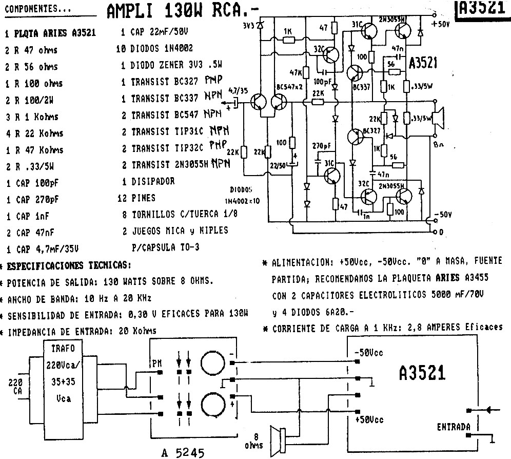

RCA 2N3055H Amplifier.
Here is RCA 2N3055H amplifier,
I made it in 1983 with 6 pairs each channel,and used up to 12 nos.12" speakers on one channel direct for open air programmes,All that is needed is a nice heavy duty Transformer with lots of uf capacitors in filter and large finned heatsinks with force cooling, Voltage mentioned 50-0-50 is for RCA2N3055H transistors only, other transistors will tolerate maximum 42-0-42 volt d.c. only.I have included extension diagram also ,one can add more transistors same way.

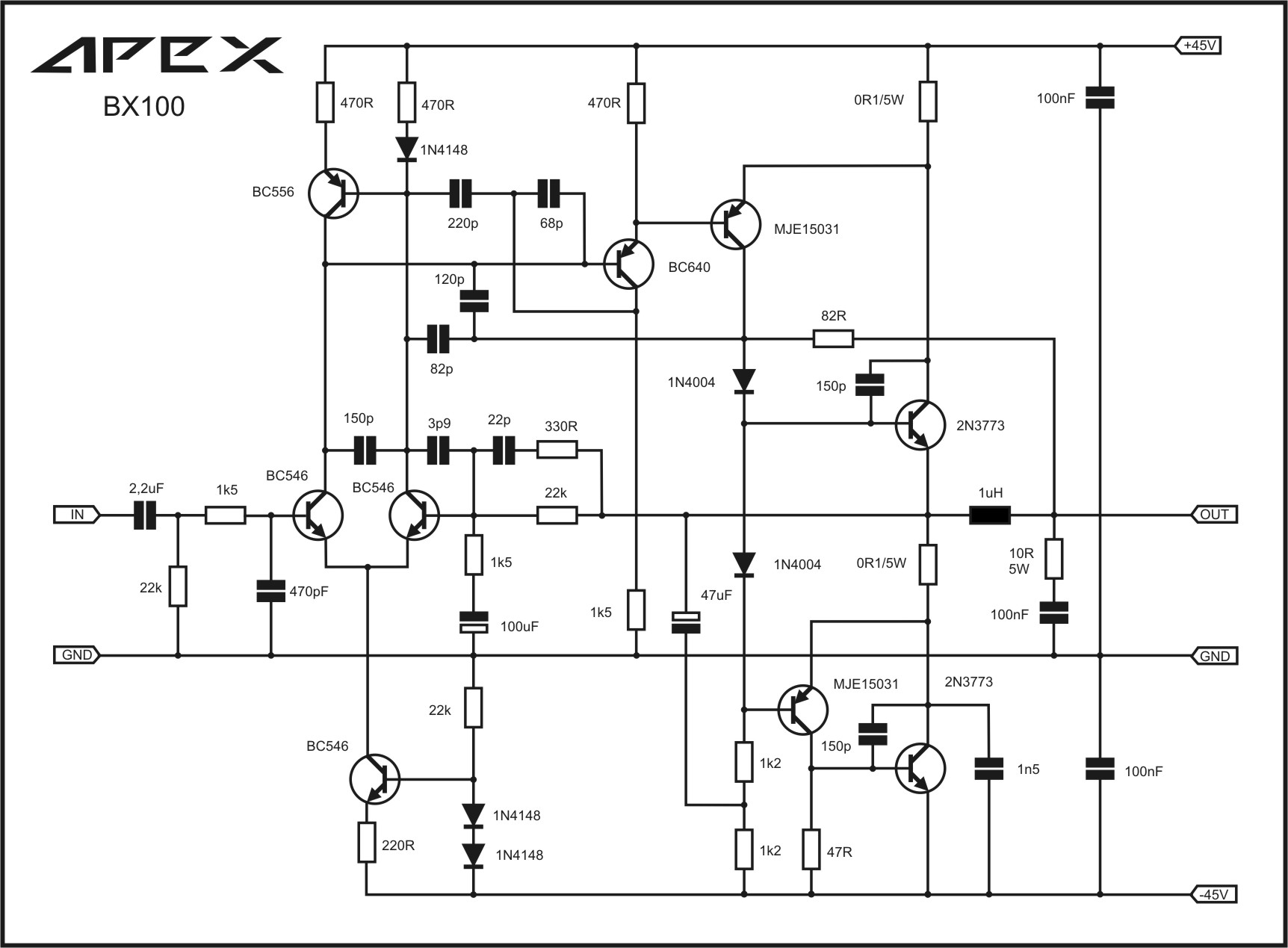

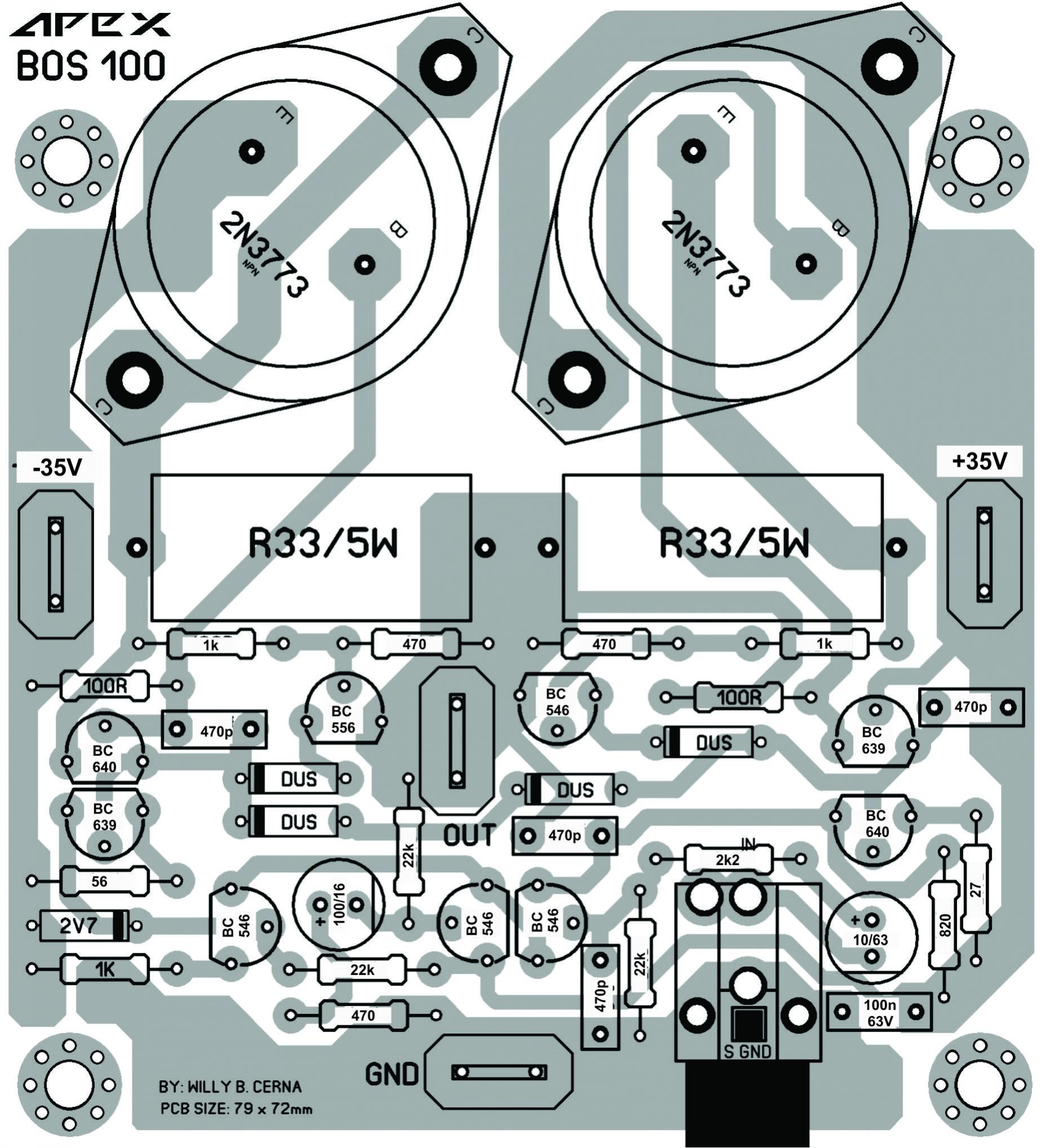

Apex Quasi, from this forum only
Apex Quasi, from this forum only,
can easily use 2n3055 with this voltage, but offcourse with nice heatsinks and force cooling.

Apex Audio's designs here are pretty much what you may need as posted earlier with about 3 or 4 pairs of output devices as mentioned.
You can also check out Rod Elliotts site for some design ideas as well,
Elliott Sound Products - The Audio Pages (Main Index)
It is a great site and it is very informative and explains the how's and why's of power amplifier design and workings.
He also describes a massive 1500watt into 4 ohm amp and is basically a similar design only he uses both, NPN and PNP devices, in the output stage.
A wide variety of output devices will work in the Apex design, I have thought about such a beast myself.
That is what the schematic I posted was derived from "The Apex design" and my plan was to use a bunch of 2N3055's as well or the 2N3772's or 2N3773's.

I threw the circuit of post #26 together the other day - just to make sure it works. It does. No extensive testing yet, but the plan is to run a pair of my 2x15 3 ways (which dip to 2.6 ohms each in the midrange) and see how it drives them. I added SOA protection using the "standard" circuit. 220 ohms from Re to base, 3.9k (plus steering diode) from base to GND. On the negative side, it needs a 0.22 ohm in one of the output transistor collectors to tap the sense voltage (same as on the PL400/700).
