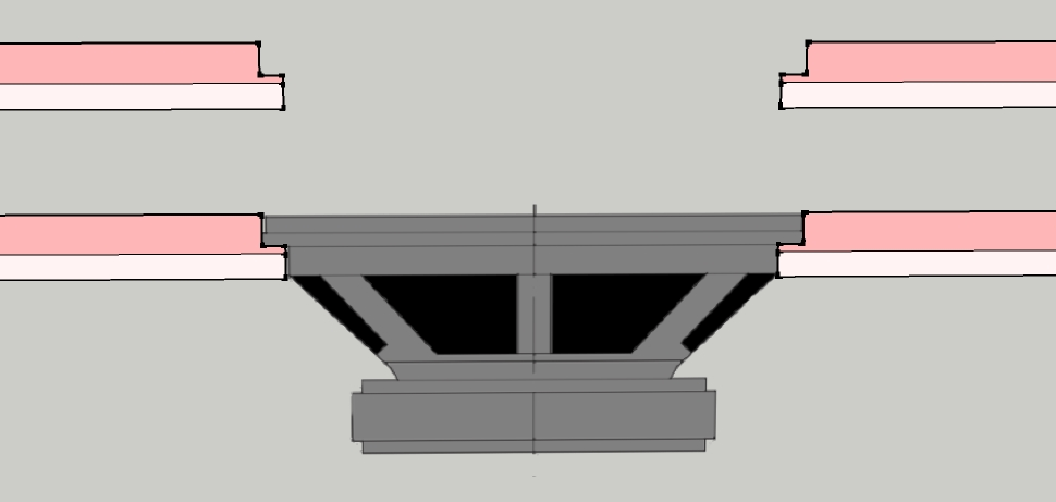

This case the baffle is double layer and is 38.5 mm thick.
So front mount with countersink, likely be much easier.
Also a rear bevel is possible but not full bevel.
Because the driver spacing is so close and mid chamber.
it is XPS so, in theory be easy to do since rear bevel could be done by hand.
Quick rough drawing, sure youll get the overall concept.
its flush mounted with outer countersink so the gasket is flush to baffle.
You just do first circle cut to outer edge to the right depth.
Then second smaller circle for cutout.
This driver has deep ring shape to the rear basket,
looks like rear bevel not needed. Seen it on few drivers
almost like they intended it to be simple for rear or front mount

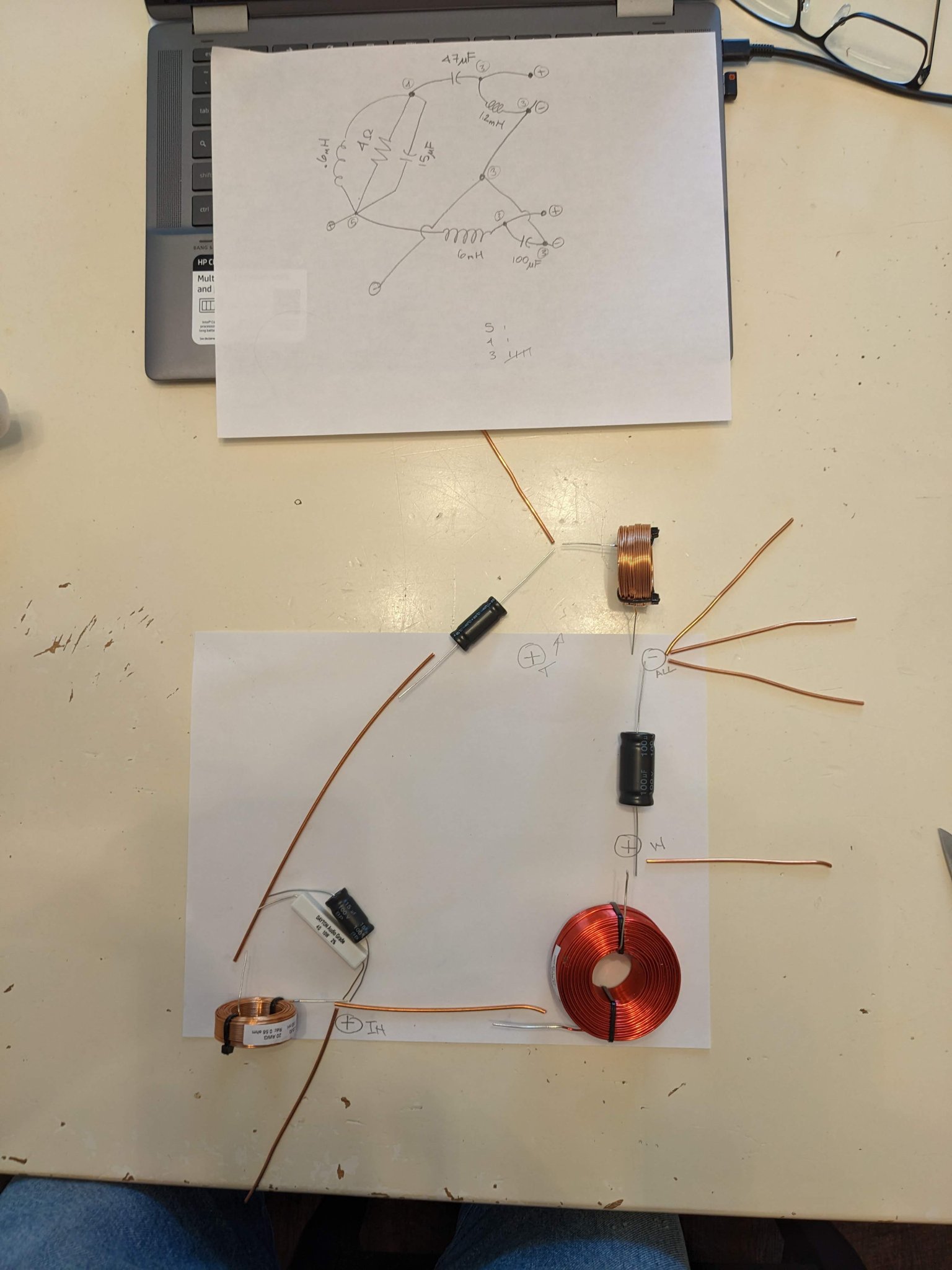

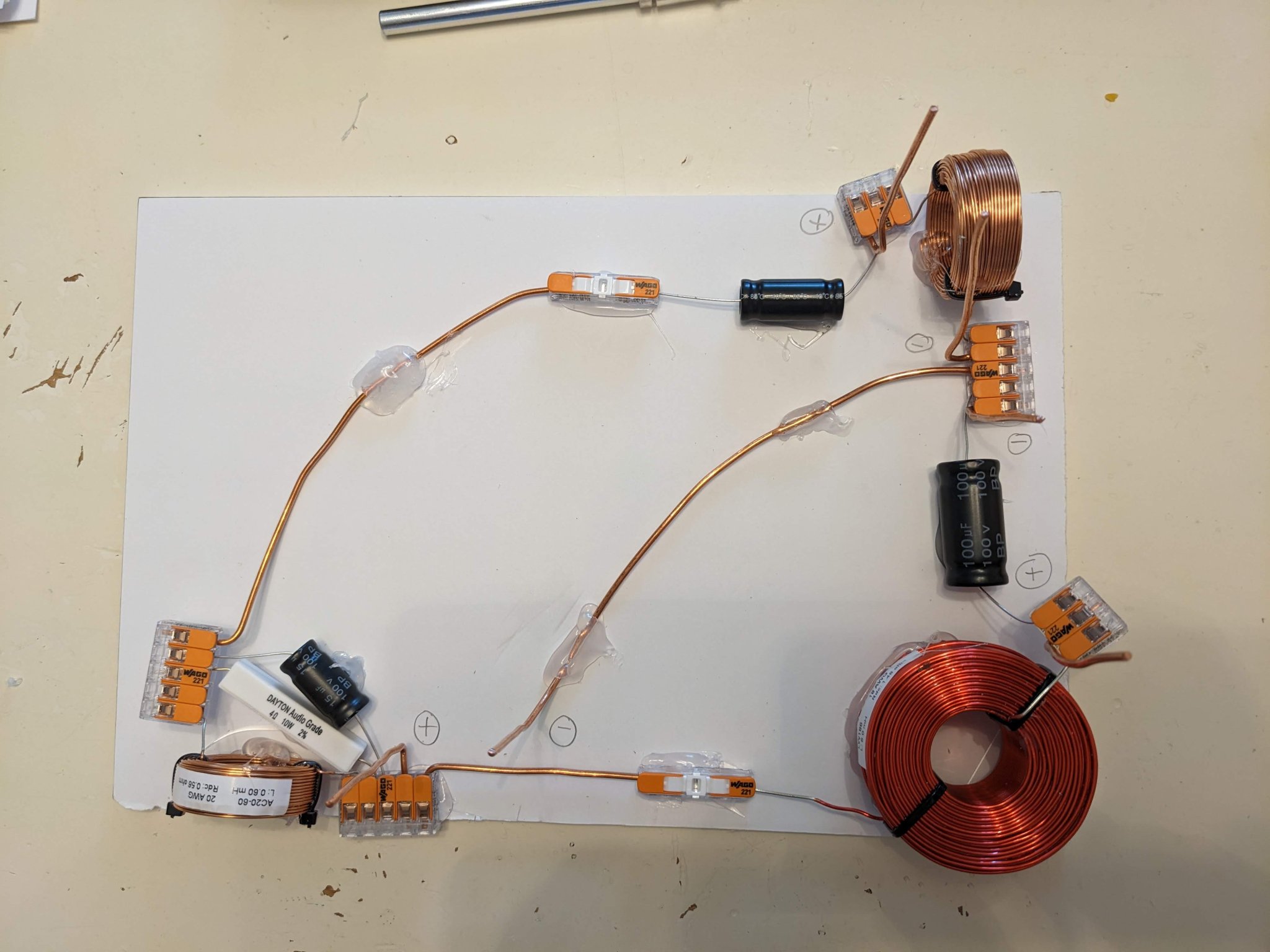

Here is what I was thinking in terms of layout. I don't (edit: know) what is audible, so I am trying to avoid a naïve decision with impacts or a undocumented tradeoff since I promised measurements. The copper ground wire bits are illustrative, but if it works I have plenty of insulated romex off-cuts. Or 14 ga stranded automotive wire. I have some wago connectors for the initial connections, not sure if wire nuts, crimped connectors (I have the basic, not the fancy compression pliers), or soldering is best here for the final version (I crimped everything before, but not sure that's the best way if someone is looking at the measurements).

Quick way to move forward and be able to hear things.
Once you have a more permanent layout connections can be soldered
and drill holes around components so zip ties can add additional hold down
strength.
for the most part you got working test rig.
position.

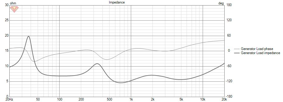

Impedance curves are really my pet peeve. I shoot for flat as friendly as possible
and amplifier friendly. Some people accept 50 ohm peaks and 3 ohm dips.
absolutely not gonna be found in my designs.
He mentioned the amp overheated, so concern is some anomaly.
Which I doubt. Getting a 8 ohm woofer and 4 ohm wideband, some would assume
a possible dip.
But at high frequency or low frequency where class D's love to shut down.
I made sure the impedance curve was graciously friendly to a amp.
The impedance curve be even very friendly to a transformer tap.
pretty much sits around 7 ohms and just the woofer peak, nothing i can do about that.
any other dip in bandwidth is 11 to 5 ohms. pretty darn friendly curve.
shouldn't overheat a amp at all.

Anyhoo point is the bottom of the cab with the large high braces.
kinda a idea to be able to stuff the krap out of it only if needed.
otherwise the impedance peak was at 39 hz and Q pretty darn good.
in 140 liters
So was hoping for decent bass

(1) go ahead and run the DATSV3, just to confirm the impedance trace. Probably tomorrow afternoon.
(2) Try the main chamber without stuffing? If so, I can probably get the laptop set up and some nearfield microphone at baffle REW traces tomorrow as well. The outside far-field runs are weather dependent (still periodic rain here).

ahhh thats right lighting strike amp LOL
keeps on ticking. but hopefully.
I had to double check parts list make sure everything was ok.
Switching to different amp should be good good test.
and impedance curve really show any issues.
either way moving forward, pretty good got sound and crossover.
