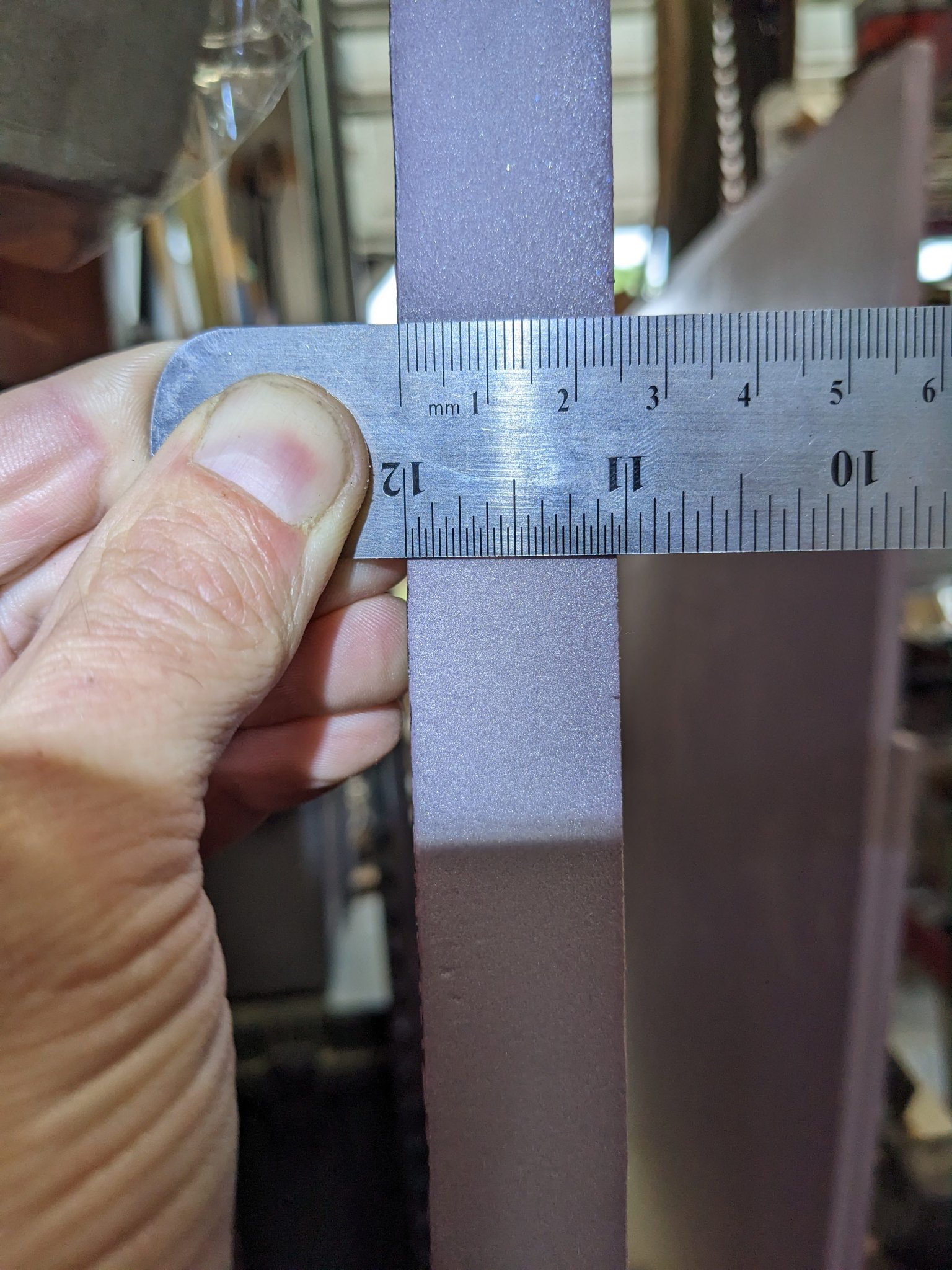

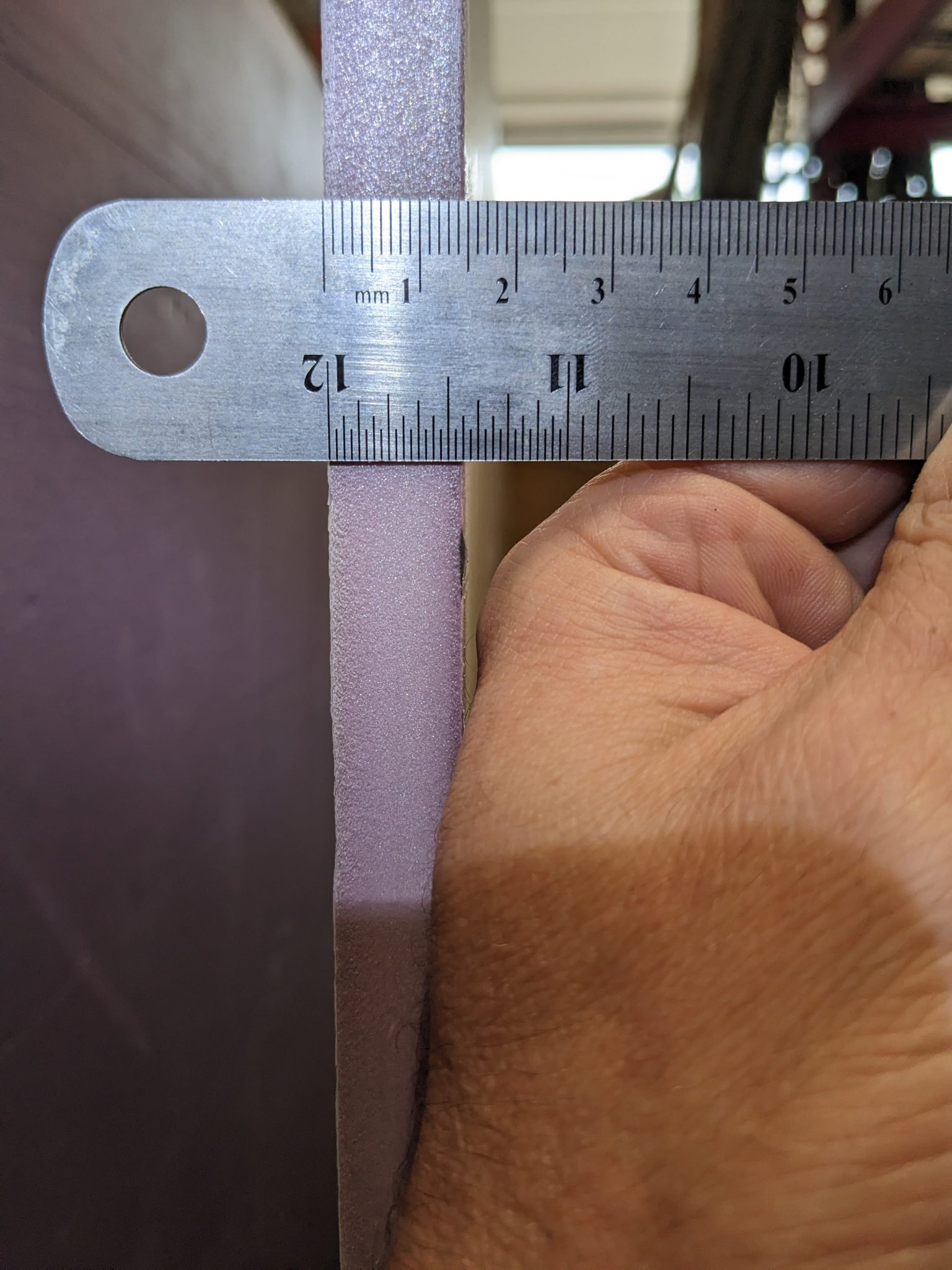

The nominal 1" XPS measures ~31/32" and the nominal 1/2" XPS measures ~9/16".
I probably have some 2" around somewhere if necessary.

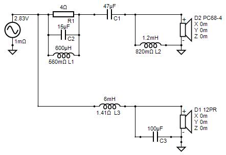

Updated Crossover for 4 ohm PC68
These are suggested components for a low cost crossover.
R1 4 ohm PEpart # 004-4
C1 47uF PEpart # 027-352
C2 15uF PEpart # 027-344
C3 100uF PEpart # 027-360
L1 .60mH PEpart# 257-040
L2 1.2mH PEpart# 257-050
L3 6mH PEpart# 257-850
people will increase gauge for coils at substantial cost
capacitors can use metalized polypropylene, again at very
increased cost.

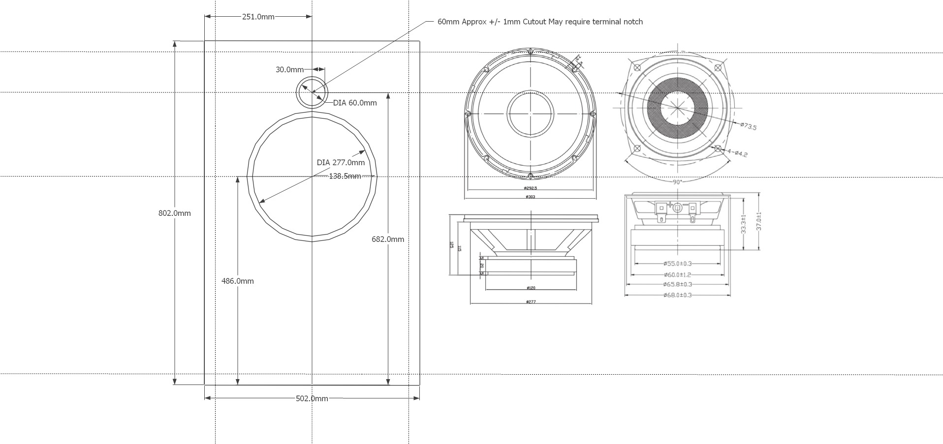

That was quick.
Im working on some more detailed drawings for the cabinet.
I'll do something for 19mm ply and double baffle.
Your case take into account
1" and 1/2" XPS
AKA .96875" or 24.6mm
.5625" or 14.2 mm

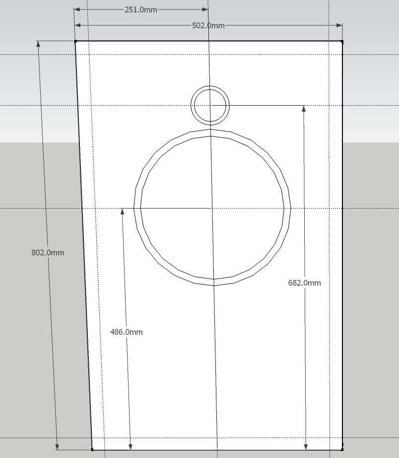

there is gonna be a 2.6 liter chamber for wideband .707 Qtc
approx 140 /150 liter for 12"
believe Qtc is a intentional .9 ish
500mm x 800mm Baffle
250mm / 486mm woofer center
250mm / 682mm wideband center
dont hold me to driver centers yet.
will confirm
will confirm
That may be hard to reach if the GRS specs of Qts = 1.06 is accurate.approx 140 /150 liter for 12"
Have a feeling the XPS is 24mm or 24.5 mm and 14mm
could confirm.
Otherwise was using the imperial measurements you posted
31/32 and 9/16
likely manufactured to a metric

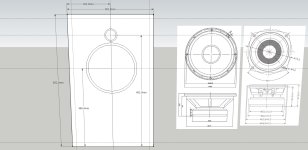

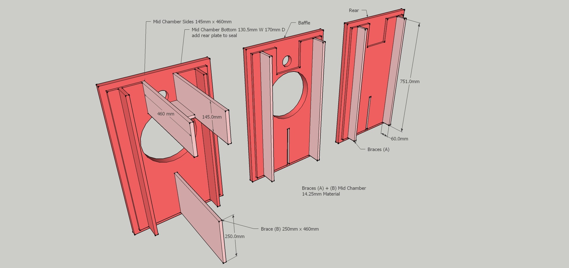

@CANNON-FODDER

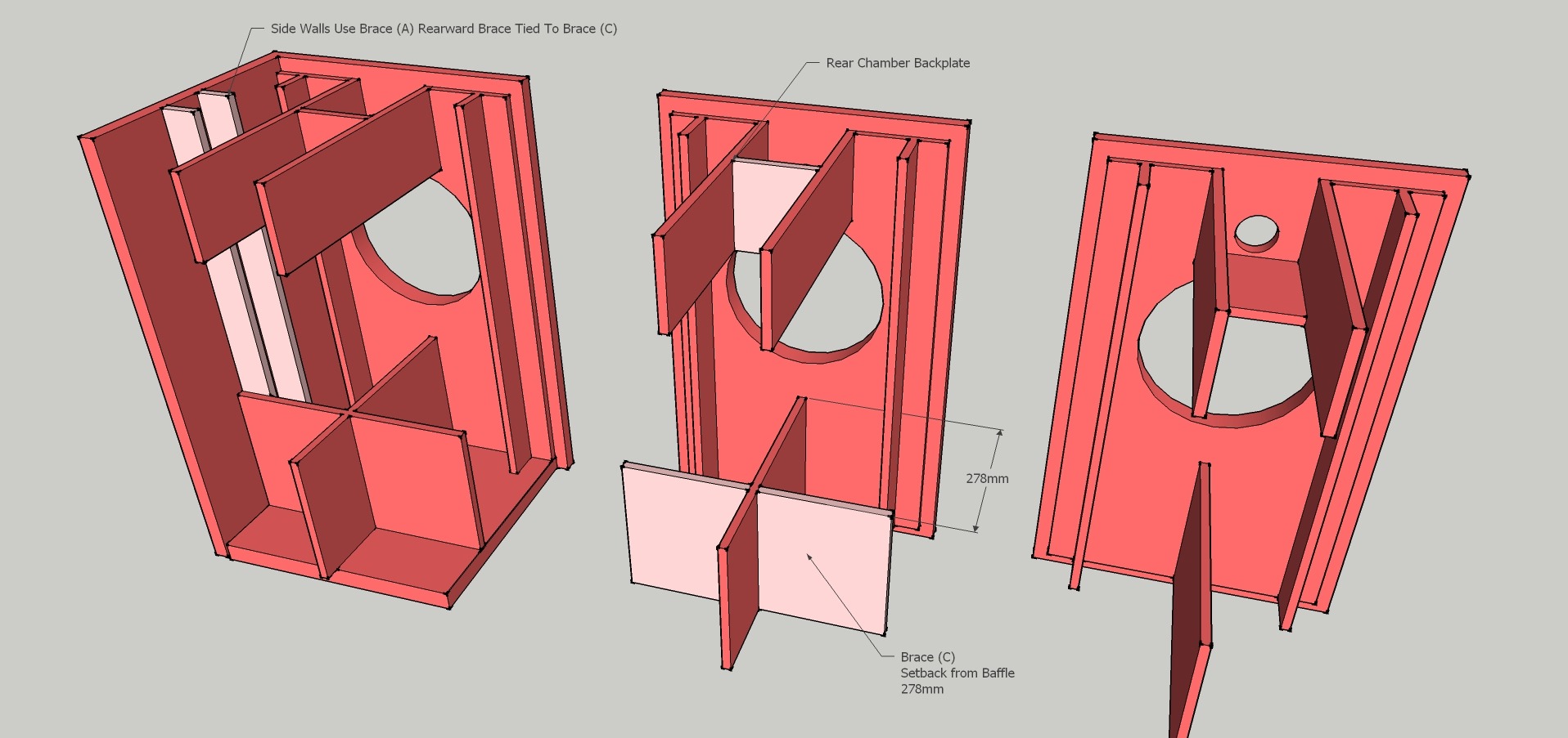

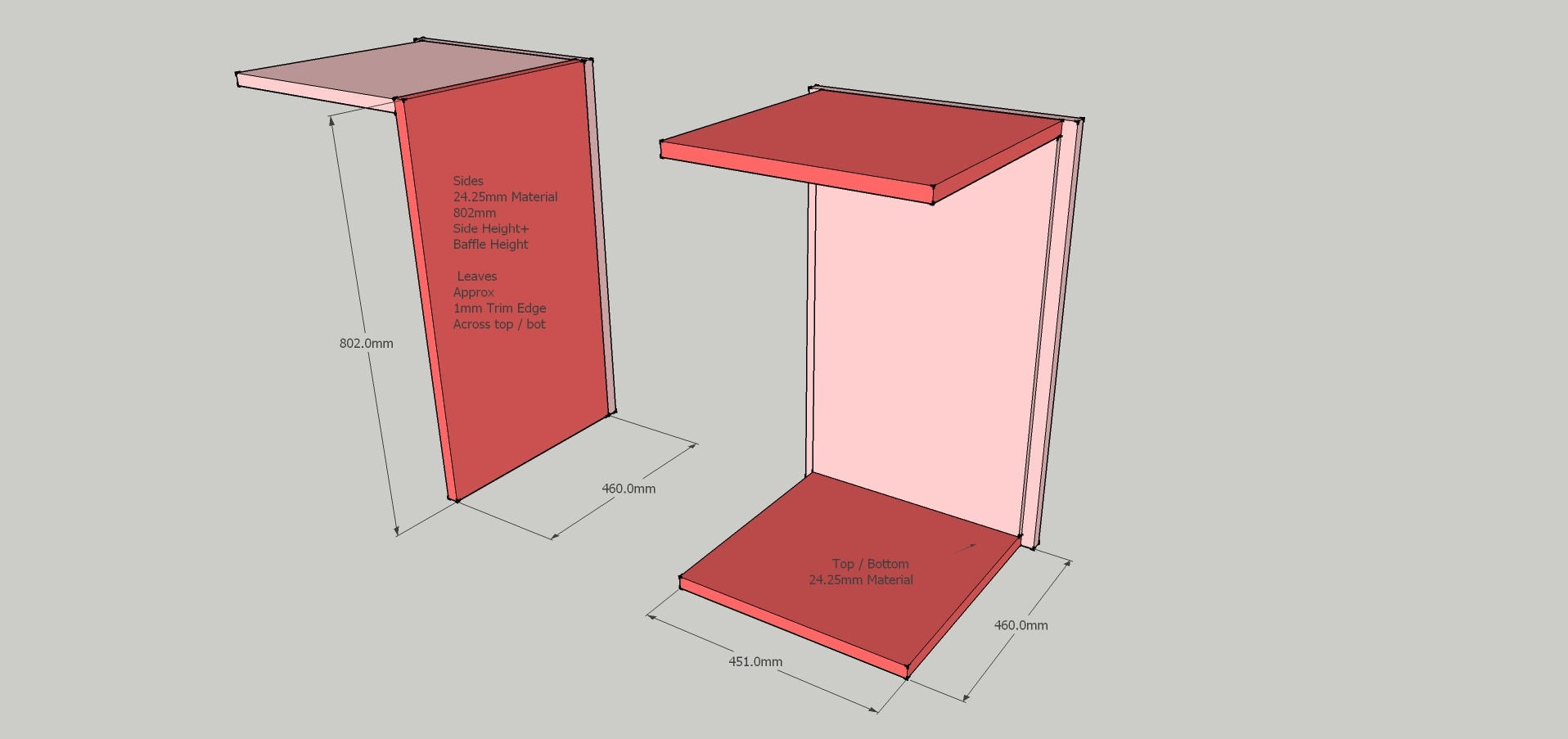

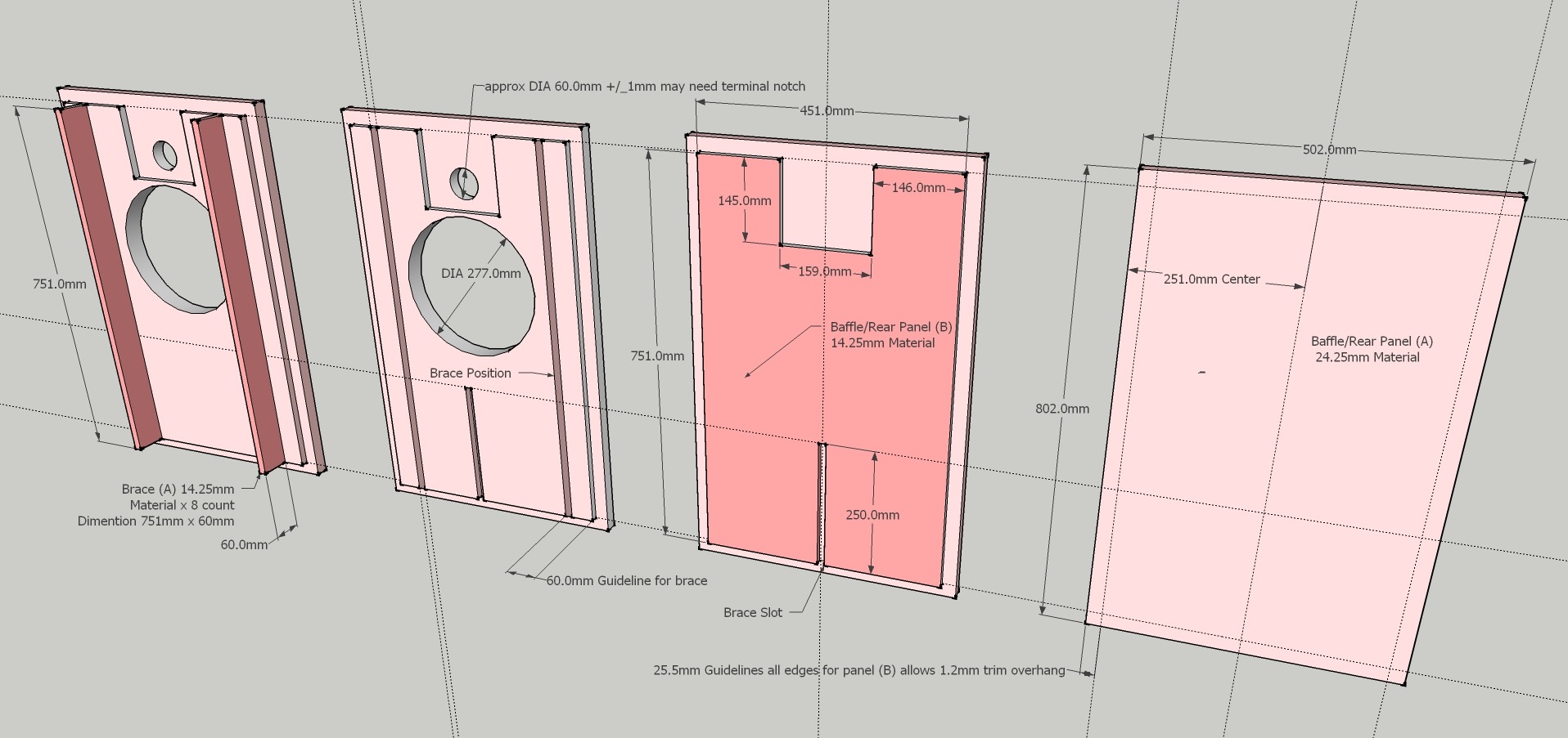

I wasnt sure how you usually do XPS cabs
Have this design using both size materials
Overall gives volumes needed / WideBand Chamber/ Baffle position
Baffles easy numbers to find centers/ then after assemble gives a small 1mm
edge to trim. Bevel edges to taste, round - 45 degree etc

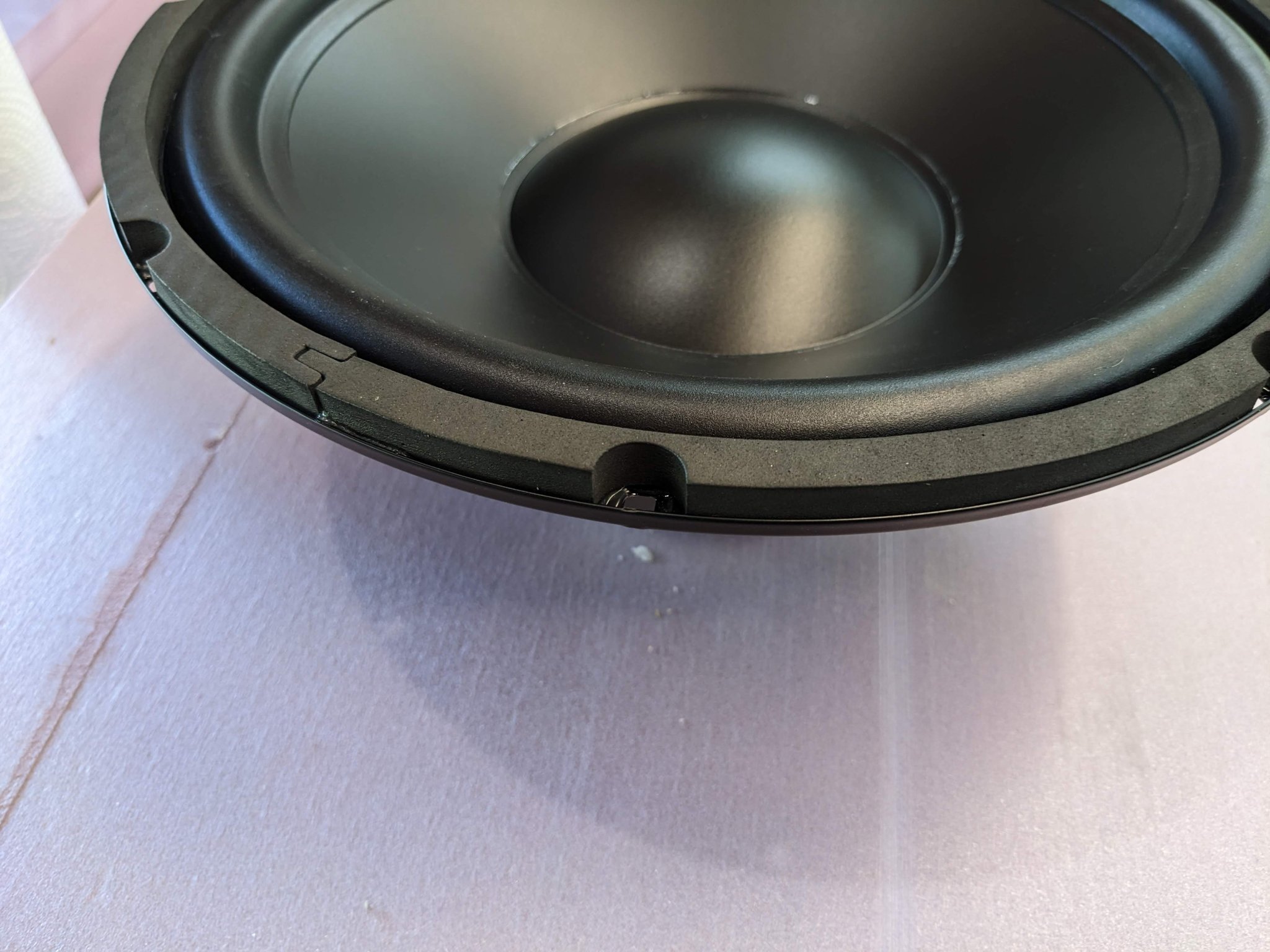

Question: The speaker appears to be configured for rear mounting with a front mounted foam gasket inside a raised lip of the frame. I wasn't tracking that was your intent.
It will be a day or two before I size the panels and start cutting the speaker openings.
If that area is significant and needs a XPS or some other treatment, please let me know.
Otherwise, if it's just a beauty ring, I am currently debating between
-- just removing the foam gasket - which leaves a trench there (assuming I recess it that depth).
-- cutting a foam ring at an angle (a door seal or something) and just gluing it in the track.
-- seeing if the Library printer could 3-D print a ring that size.

It can be a reasonable option to rear mount and radius the baffle edge. Historically, rear mounting is often for horn mounting and rear mounting a direct radiator was considered worse than front mounting. Nowadays it's generally accepted that with a radius and perhaps careful shrouding over part of the surround it can be done well.
