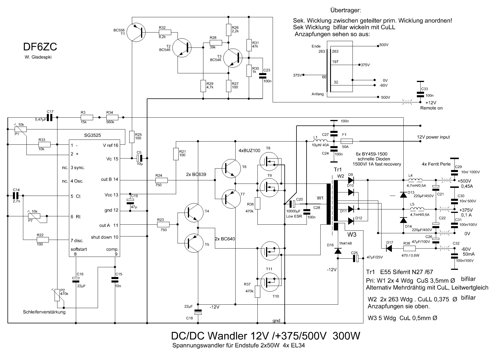

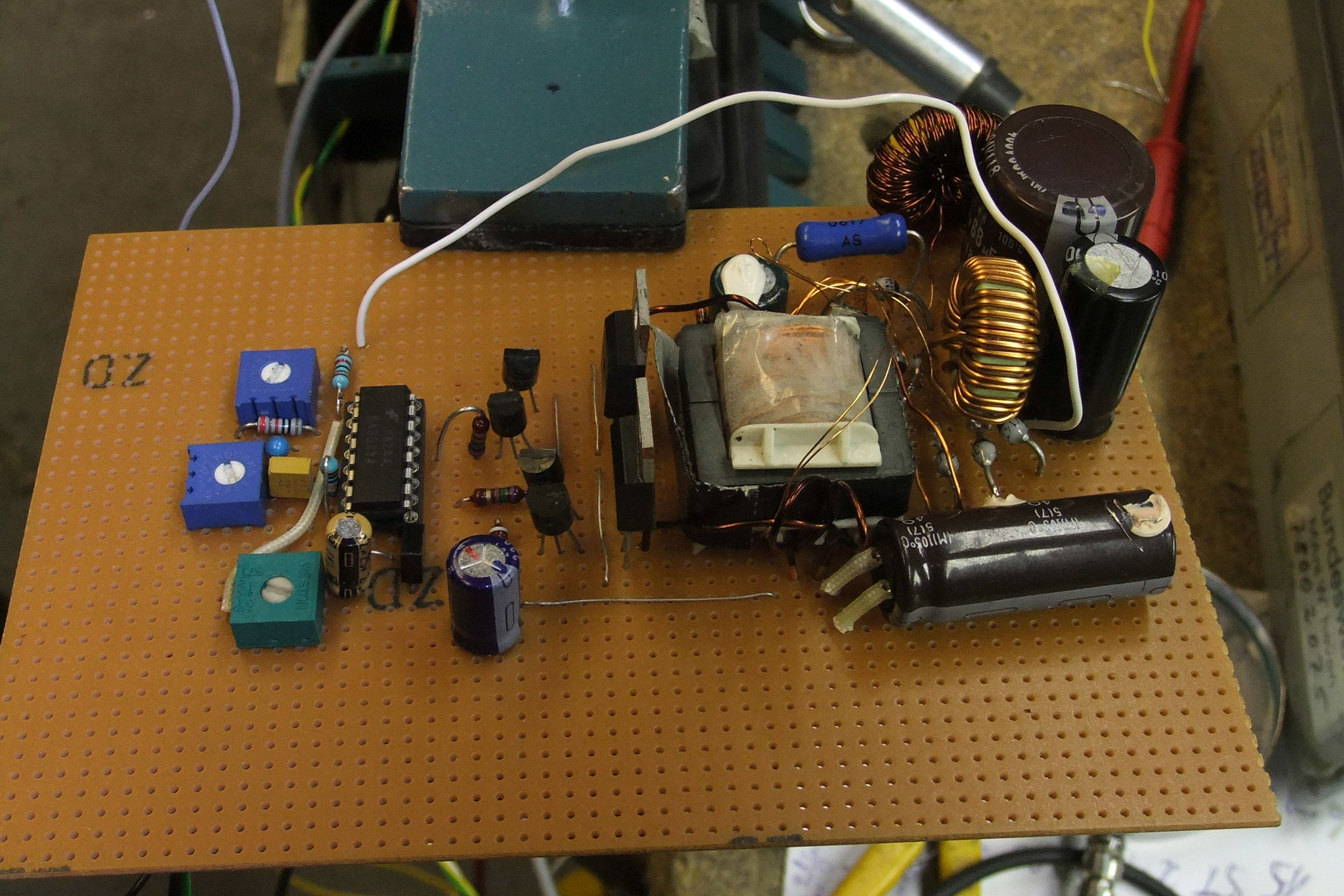

Inverter for battery operated tube amps
Hi folks,
I posted a Circuit in thread #17 the other day. I found some pics I´ve made during the setup. As I said this work in a portable guitar tube amp with EL84 and ECC83. So after all the time the guy who use this amp for street music, he is quite satisfied with its performance . The amp run with a brand new lead acid battery 5 hours.
The iron in this one came from scrapped electronic ballasts. The power Mosfets from motor controllers.
I made another inverter which give an amazing output of 350W from a 12V source. This Inverter shall power up a 2x50 Watter with 4 EL34 for car use.
From left to right:
schematic of the 350W inverter, plate voltage of the 20W inverter, heater voltage of the 20W inverter, setup of the 20W inverter.
73
Wolfgang
