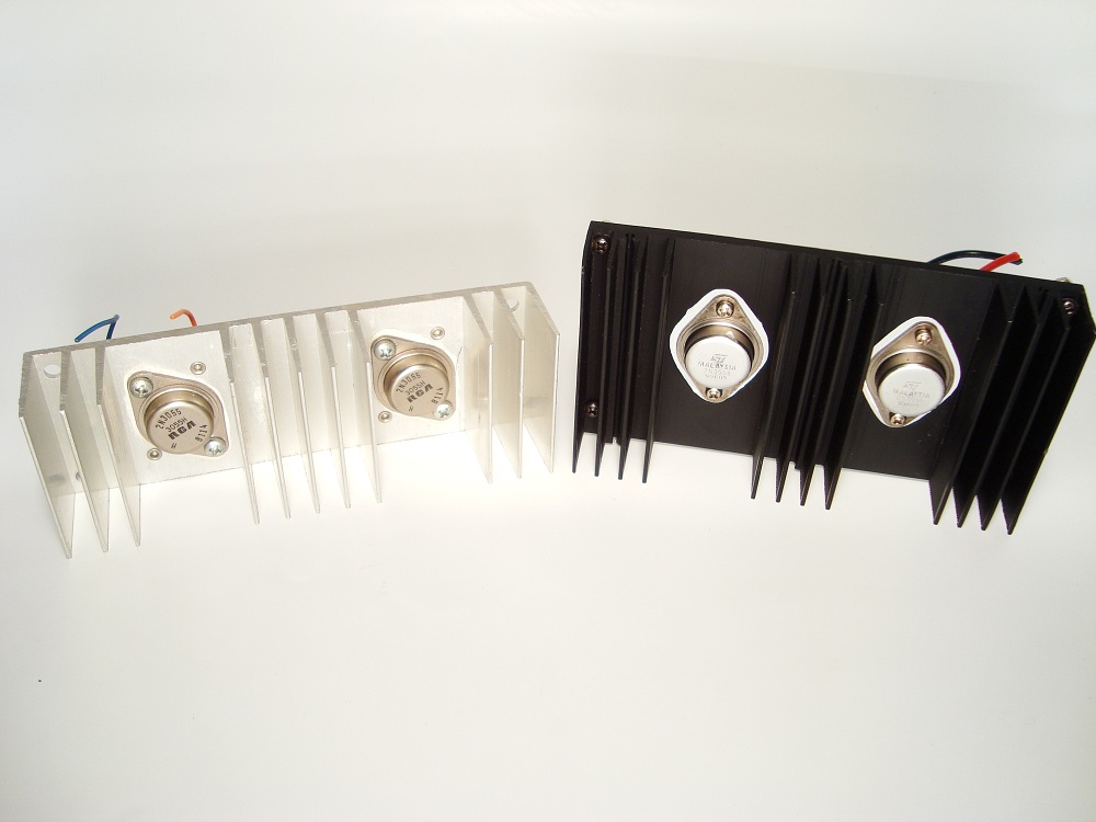

Used to be a local surplus house that got a lot of surplus from Sperry Univac (Now... Lucent? Whatever.) Used to get these loaded power supply boards with 10" x 3.5" finned heatsink and 3055-2955 tab packs Strip off trannies, use heatsink for amp builds. Throw the rest of the board away... except maybe a few caps. I recall them being maybe a buck a piece. Ahh the good old days when local surplus houses abounded....
