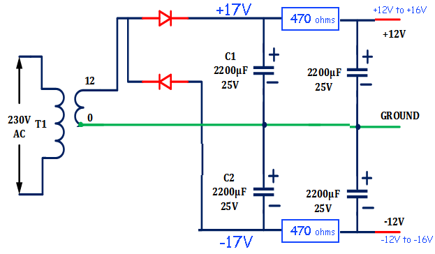

All posted plans are over-complicated, IMHO.
First time I did what you are doing, I did this, and never regretted it. (The console was used by dozens of people for dozens of years no complaints.)
You do not need regulation. Your likely chips will work as low as +/-6V or to almost +/-18V. They will reject huge ripple. The large caps put ripple down near 1/4 millivolt; add the 60+dB PSRR in any good audio opamp, the buzz is below the hiss.
Large supplies "like" full wave rectifiers to reduce cap size/cost. But at this power level the 2-diode plan reduces cost and simplifies wiring.

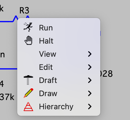

For some strange reason I can't seem to change the values in the model, I am right hand clicking effectively with an apple trackpad and all I get on screen is this image? I am sure these were accessible to change when I first started playing?
^^^^^THAT
Personally I´m Cheap/Minimalist (pick one or both 😉 ) and never ever use regulators with Op Amps, they simply don´t pick (reasonable) ripple.
My typical supplies are either derived from +/-V power amp rails (and you very well could/should do that): 2 resistors 2 15/6V Zeners 2 capacitors (100uF are enough, remember main supply is already filtered) OR a single or dual 12VAC winding, 2 diodes (doubler) or a bridge and 2 caps, which in this case yes, need to be "substantial" (2 x 2200uF 😉 )
An added RC net is the icing on the cake.
PS: remember Zeners if used also *chop* ripple off.

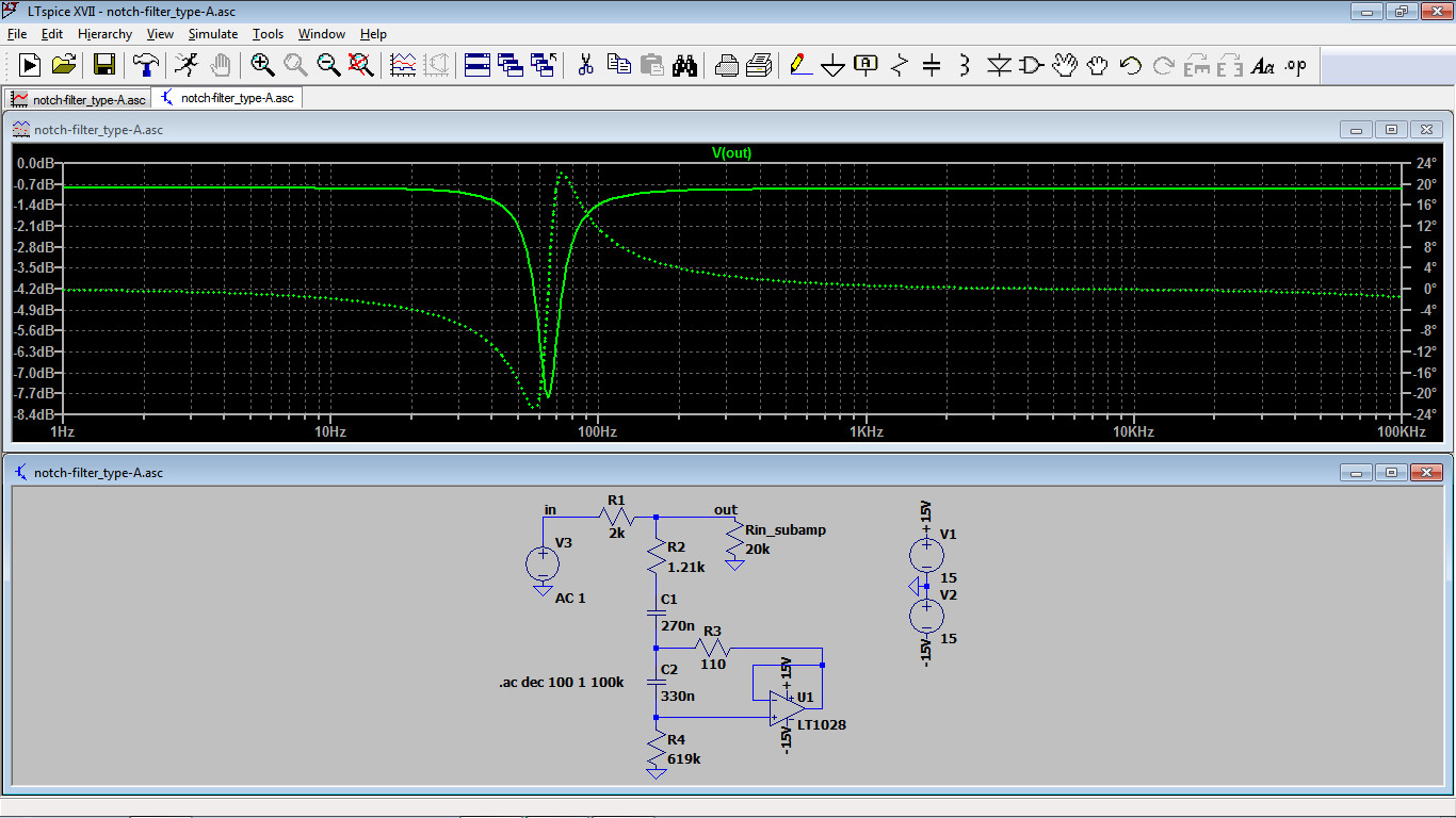

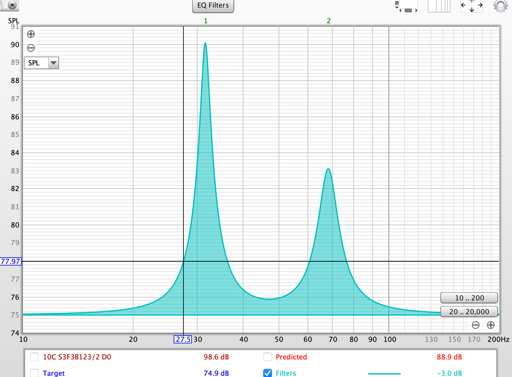

Ahh ok, think I am getting somewhere....does this make sense as a pathway.
(I am not sure how to calculate the Q in REW mathematically)
I create a filter like this in LT spice, and then compare to the filter selected to work theoretically in REW (dB at frequency) to see how to build the filter in LT spice that matches the REW curve.....that removes the room mode mostly from the measured room response.

I´d guess the notch has to have the same shape as the resonance.
So you would need the absolute attenuation and the "width" of the resonance.
Look at the definition of Q for the notch on Linkwitz drawing.
Determine delta-f at -3dB down. Then Q =f0/delta-f.
You can put these numbers into the spreadsheet I linked above, then put those part values in LTSpice.
And yes, the rest is fine-tuning I suppose.

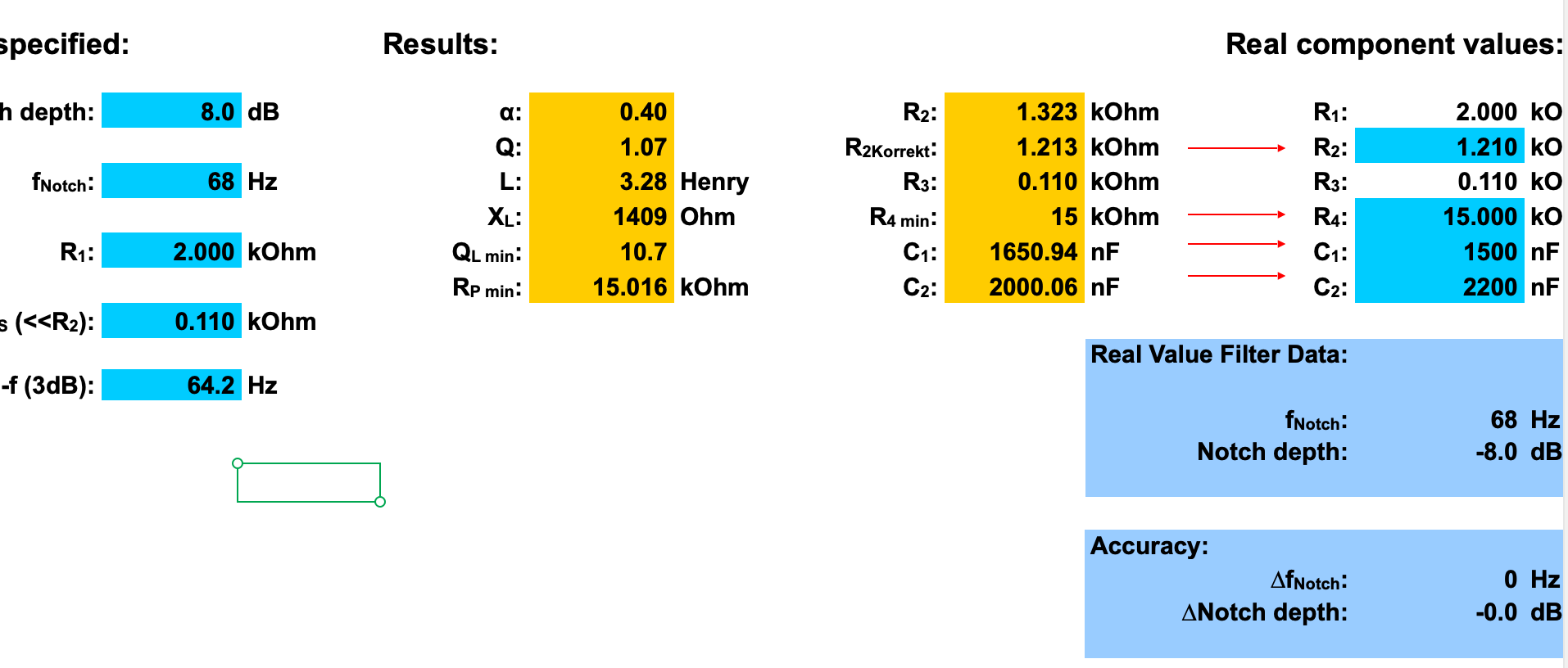

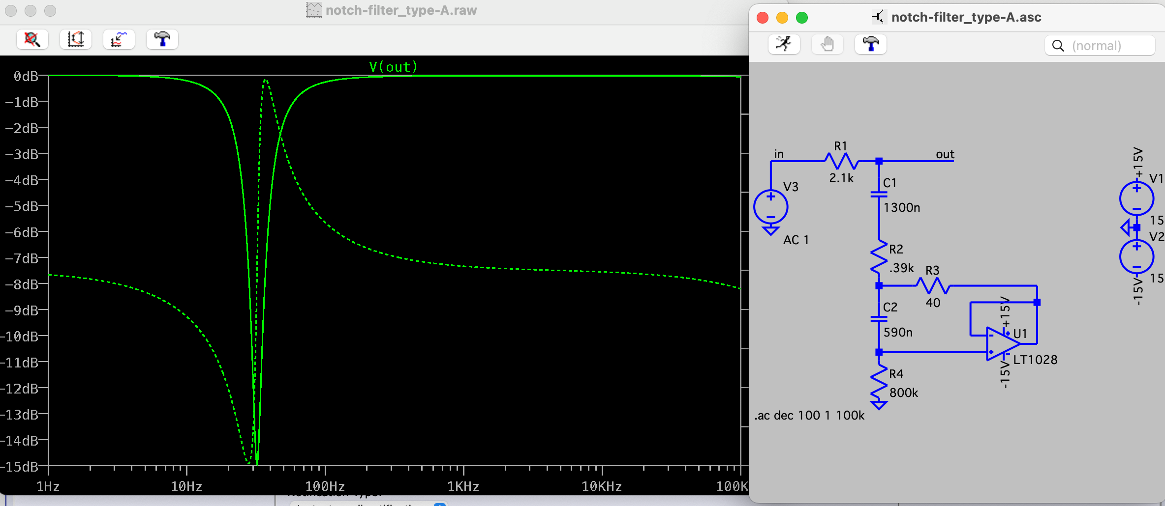

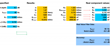

Yeah I get a value if the notch design in REW playing with F(notch) dB and Q and look at the filter design to match -3dB frequency in REW and creating the equivalent in LT Spice.....then checking on the xls calculator.....and thinking through the accuracy/sensitivity analysis.
For some reason I struggle to get a high Q on the LT Spice, but I am just empirically guessing.....
Why estimate when you can use the spreadsheet?
One of the parameters you have to give is the delta-f.
Those values from the spreadsheet should fit.
For whatever reason the spreadsheet in my hand does not predict the right Q

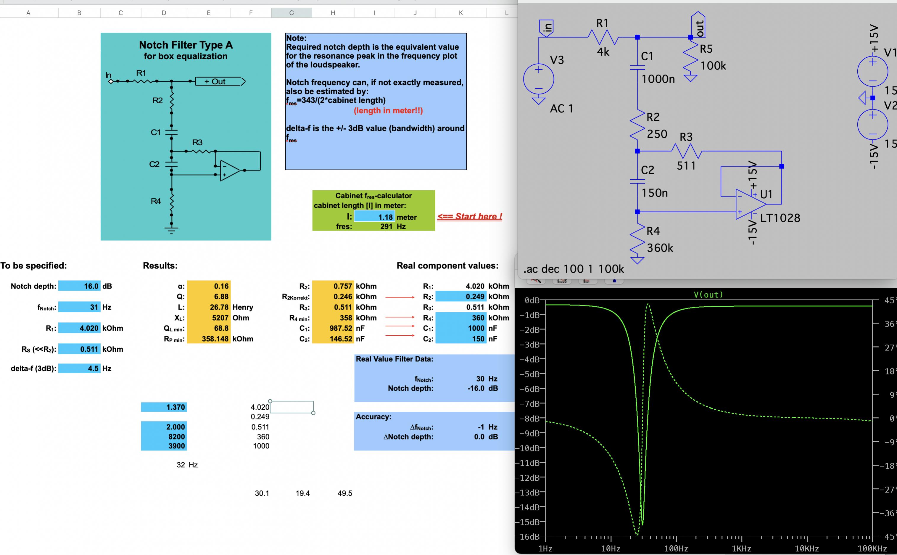

See comparison here with LT Spice?

Judging from your REW plot in post #32 your delta-f is ~10Hz as far as I can make that out.
You should put that into the spreadsheet (where do the 64,2Hz come from?).
To complicate things a little more, this circuit assumes an input source with 0R output resistance and the following amp with infinite resistance.
You will have to put in an Rload which represents the input resistance of your sub-amplifier.
Just add an "R" by pressing R, add GND by pressing G and wire after pressing F3 (in my windows version at least).
Also, if you notch your signal in order to get a flat response, you might end up finally with a notch that isn´t quite as deep but I´m not an expert on room resonances...
As I said, the final tuning should be done by measurements.

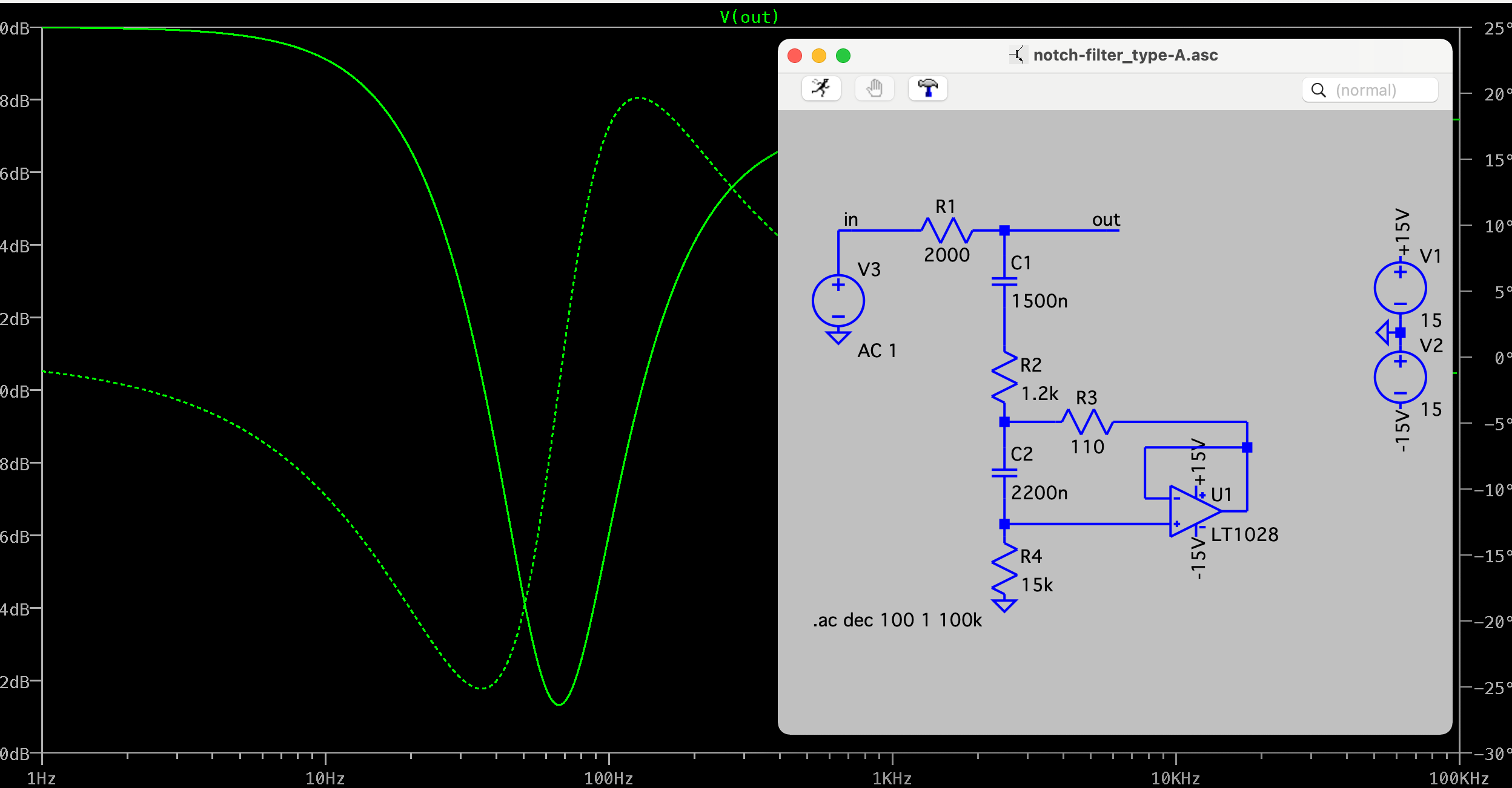

I have realised the way to get the right Q in the excel calculator, I was just being dumb, but the model in LT Spice still creates a much lower Q value than the calculator?
Maybe I am still missing something?

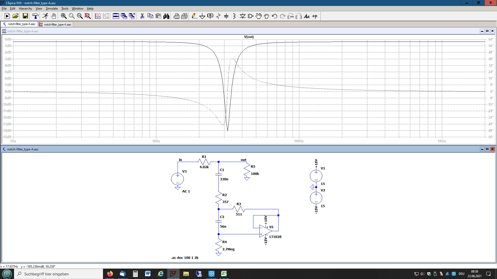

I think your delta-f is again somewhat wrong.
If you look at the peak at 31Hz (@~90dB) you "go down" 3dB.
At ~87dB the width of the notch is ~1.8Hz.
Putting this into the sheet and LTSpice I arrive at the attached plot.
I put the following values in the sheet:
Notch depth=15dB, fnotch=31.8Hz, R1=4.02k, R3=511, delta-f=1.8Hz
Ahh ok.
So delta-f on the spreadsheet is the 3 dB down point from the peak (15dB-3= 12dB point), not the -3dB from the base of the profile?
