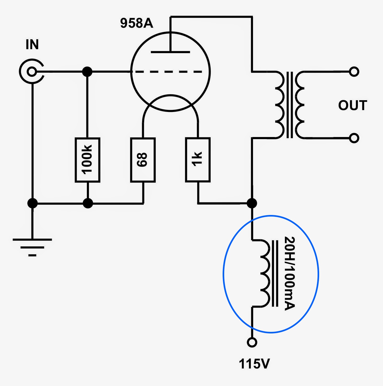

A choke can be inserted between the last power supply cap and the output tube, correct?
Wouldn't this minimize / eliminate the sonic impact of the last power supply cap in the signal?
Also, I am not using a grid stopper in my design, so this is not an issue.
Here are 3 examples (see attached) from Thomas Mayer's designs that illustrate the choke after the last cap.
Regarding the gridstopper, I have been using my amps without them successfully. Am I missing something?

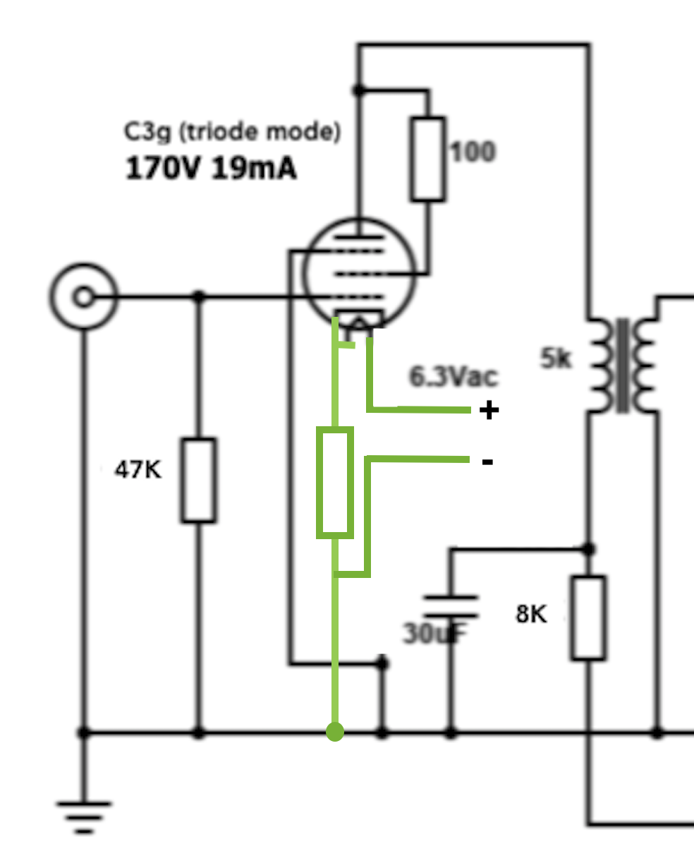

Cag - In the other thread regarding heater bias, you state "I have connected the positive terminal of the Rod Coleman regulator to one side of the heater and the other side of the heater is connected to the cathode. From there a common resistor goes to signal ground. The negative terminal of the Rod Coleman regulator is connected to the signal ground."
Please see the schematic below. For my C3g (triode), is this correct for heater bias?

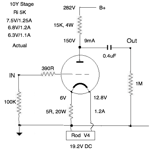

Right now I have 10Y in filament bias driving 2a3 outputs. Very nice too. You will need some kind of step-up for the gain. I'm using a Hammond 1140-LN-C broadcast transformer in 1:4 and it sounds pretty good. It was surprisingly cheap as well so I bought 2 more pairs.
Things you will need to consider for the 10Y is a good size heatsink for Rod's regs (now V9) and where to put it. And where to put the cathode resistors. They get hot, and I had to move them to the top of the chassis.
The 10Y stage I've built is for a Pass F4 input for a friend, and doesn't need a step-up. With the 1140 SUT in 1:4 I will need at least 10V bias for my own use, so I'll rebuild it with a different operating point. My present B+ is 282V and anode resistor is 15K but the B+ needs to go higher for 10V on the cathode.
I've also built a 112A and a 46 stage in filament bias, both good. The 10Y has the most inner detail - you will hear things that were hidden with other tubes. But the 46 has such good piano tone that I'm not sure I can live without it.
I attach the 10Y circuit I'm using, but this is to drive an F4 as said, so the circuit will be revised for the 2a3 amp. I'm using the 10Y at 6.8V and 1.2A filaments.
