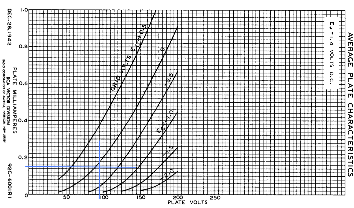

Regarding the implementation of the 1LH4 tube, the initial operating point I am targeting is what is published as "typical operating conditions" for class A. 90V, 0.15mA and 0V bias. See attached.
To get the 0V bias, is any resistor and/or cap needed for cathode bias?
