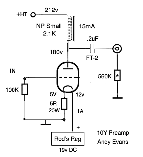

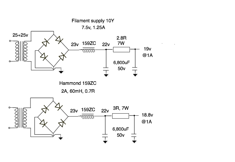

These are preliminary numbers. I haven’t finished the amp yet. But that’s in the ballpark.
The filament R is 5 Ohms/50W.
Definitely DC on the filaments. 7.5 V is far too high for AC.
I use choke input everywhere, HT and LT. For filament supplies i use Lundahl LL1694 as the first choke.
The type of resistor in the filament supply matters. I prefer vitreous enamel.
Hi - I dug up some old designs I made and built. These are from a few years ago - I might modify them if I rebuilt the stage today, but they're in the ballpark. The resistor is definitely important. Vitreous enamel is the right kind. I actually use some Russian military resistors I found on eBay. Not vitreous enamel, but I like the sound of them. Looks like I was using starved filaments then - you can try that or use the full 7.5v as in the data. Regulators are always Rod Coleman's.

I haven't read through the thread very closely, but wasn't it determined that a 10Y or similar low mu tube wouldn't work? The discussion seems to have come full circle back the the 10Y mainly because other alternatives can't use filament bias.euro21: thanks for the explanation. I may have to find a new driver tube, as I am trying to find a DHT driver that I can use with filament bias. This will allow for the removal of the cathode bypass cap. I am trying to eliminate caps from the signal path.
My primary challenge is that I need a medium or high mu driver. mu > 30 is my best guess, given that I am driving the amps with a 2V source into a passive attenuator (EMIA Elmaformer). Any thoughts on DHT's that might work with filament bias and also have a mu > 30?
I would think that the ability to provide enough drive would be more important that the ability to use a particular bias scheme.
If the object is to eliminate the cathode bypass cap and the use of filament bias limits your choices, why not try battery bias using a tube that can provide adequate drive?
All the "usual suspect" DHTs seem have a mu of less than 10 but there are some that have a higher mu. I haven't tried them yet, but I recently picked up a few 1G6GTs which are dual DHTs with a mu of 30.
I have no idea if they can be used as a driver, though, since they are designed to operate as Class B outputs with 0v grids. Any thoughts on their feasibility?

I think this is a "no no", but I will ask anyways. My power transformer has 2.5Vac that are currently used for the output tube (45B) filaments. IF I replace the C3g with a DHT that also uses 2.5Vac filaments, can both the driver and output tube share the same filament power supply?
As an alternative, what is the best way to drop the filament voltage to 2.5Vac if I use the existing 6.3Vac?
I think this is a "no no", but I will ask anyways. My power transformer has 2.5Vac that are currently used for the output tube (45B) filaments. IF I replace the C3g with a DHT that also uses 2.5Vac filaments, can both the driver and output tube share the same filament power supply? As an alternative, what is the best way to drop the filament voltage to 2.5Vac if I use the existing 6.3Vac?
A DHT needs its own supply - you should not share supplies.
Surely you need a gain of 30-40 for the input tube? That's not a DHT unless you use a step-up input transformer but that will affect the purity of the sound so you're probably better off with an indirectly heated tube. Anyway, with a DHT I'd use Rod Coleman regs and they need headroom to work, so you might need more than 6.3v in fact when converting to DC. If you have 6.3v as a starter voltage you can top it up by connecting another transformer in series. e.g. 6.3 + 6v takes you to just over 12v. If you do this you need to check that the windings are the right way around, or you'll get a much lower voltage.

EML 30 have a gain of 33, with 2V input its useful

I am thinking carefully about the EML 30A. Andy is correct: expensive. That said, I am pursuing my personal all out assault on a DHT --> DHT monoblocks, so the EML 30A is within realm of possibilities. I was checking the price of 10Y tubes, holy cow. Very expensive.
Ale Maglia has a very nice article (EML20A driving EML45B – Bartola(R) Valves) on 20B --> 45B. He states " EML20A. With a gain of 20, it’s a good candidate but it hasn’t got just enough gain to drive the output stage to full power... The EML30 is an alternative...With the voltages involved and swing required, probably better to run it with choke load."

The 10Y doesn't have enough gain. You are looking for a triode with mu of 30-40. Or a pentode like C3m. Or a pentode in triode like C3g. I haven't tried the EC86 yet or the Russian 6S3P equivalent. They would work but be careful to avoid oscillation - search on EC86 for how to attach 3 grid stoppers together like a tripod.
