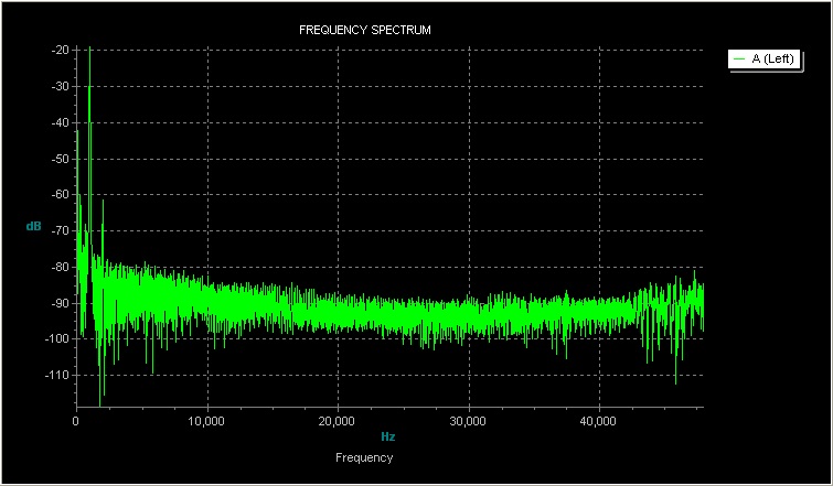

Yesterday I blew up one 10m45s 😀😀 Nothing bad happens in the amp, just the music disappears, and a soft humming comes from the attached speaker.
It short circuits, which in my opinion is better than open. Especially for self induction spikes by choke and power supply transformer.
I blew it up when I was doing distortion measurements, and the multi meter attached to the anode of the 2a3 (525v) got into auto-power off mode. Without thinking I turned the knob of the multimeter to the off position, and then immediate back to V. I heard a little spike in the speaker followed by the aforementioned hum. 10 minutes later the ccs was replaced by a new one, and the amp played again. What I didnt expect was that I had to readjust the amp, (cathode potmeter on d3a) to trim the Va-2a3 back to 525v.
I guess there is some difference between them....

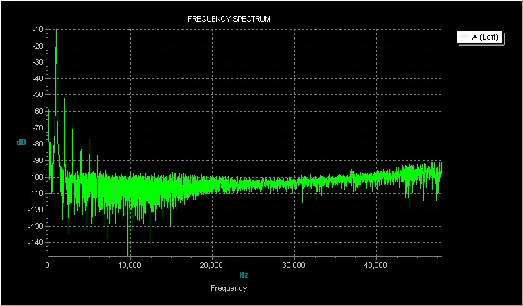

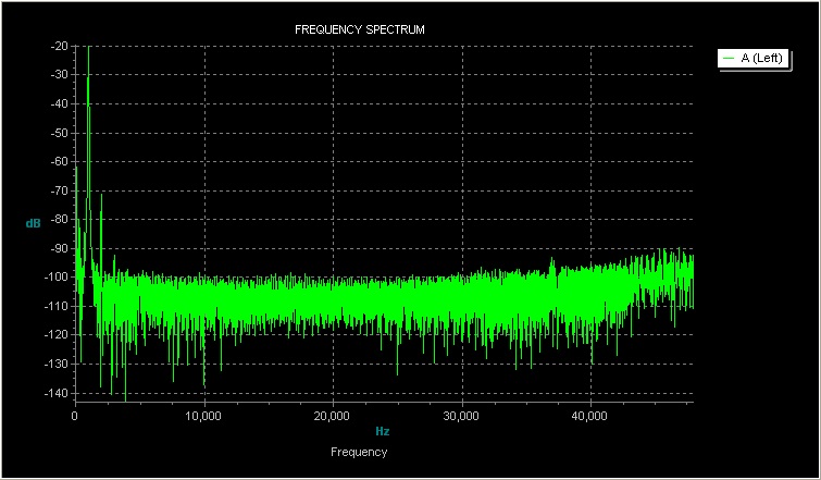

The distortion measurements were pretty good: 0.6% at 1watt; mostly 2nd.
