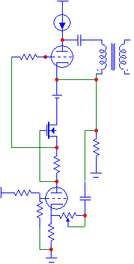

Hi Paul,
I thnk you might be misunderstanding where to insert the power supply.
If you insert a power supply from cathode to the lower 10M45 drain,
*leaving the OPT and R4 connected to the cathode*
Then that power supply is not in the cathode circuit. It's only in the drain circuit of the lower 10M45, which is very well isolated from any signal path.
Also note that any grid current is sourced by this supply, which is returned to the cathode. No grid current appears anywhere else in the circuit, not even in the cathode resistor. Intentional A2 may not work well with a CCS anode load, but for occasional peaks it may be useful.
The driver current loops between your amp and mine are actually not that different except for the grid power supply; only the way you chose to draw your schematic showing the driver under the power tube differs.
So, yes you can insert the power sypply to get more voltage headroom; you don't have to go A2, and if you avoid anti-triode on the top CCS you can keep the resistor bias. Probably worth a try if you're in an experimental mood.
A couple of 9V batteries in series for 18V might be a quick test and would probably hold a charge for a few hours at 10mA. Put a reverse biased diode across them so you don't reverse voltage when they discharge...
Michael

Let's make sure we are on the same page. Here it is as I intrepret Michail's intent.
The battery (or supply) is in series with the driver tube, and only passes the current of that tube. The rest of the cathode current of the power tube circulates in a parallel path, through the power tubes cathode resistor. Of course, as in Michael's example, this requires the gyrator connection of the FET (that's not the right symbol for the depletion device, but it's all I had).
So if you are running the D3A at 10-20mA, I believe that NiCad (and maybe other types) will withstand a slight constant current over charge. You'd have to check the spec's. I think that others (maybe kevinkr) has tested various types as a cathode biasing device for small signal tubes.

OK. Shoulda done this in the first place. Here is the first schematic I drew, just rearranged. All the connections are exactly the same, except I oriented the extra supply (or battery symbol) correctly. Had I done this I would'nt have got lost myself, and confused the issue.
Couple of things to remember that may help.
1. Mentally simplify things by considering the connection node at the output tube cathode resistor as just another power supply. Now, it has relatively high output impedance. But that doesn't matter for the analysis. As long as the driver tube is fed by a current source, you can ignore the impedance, and even ignore the fact that it comes from the output cathode, because neither has a significant AC component. It's just a source of current.
2. Now, if you connect the driver FET as a gyrator, it still won't matter, as long as you don't draw grid current. With no grid current, the current through the FET is the same as the current through the drain resistor to the plate of the driver. Remember the gyrator looks like a current source to the plate. So if it sees the same current as the FET drain, then it looks like a current source to our ouput cathode power supply (just eliminate the grid connection for the analysis - it draws essentially no AC or DC current).
3. But the situation changes when grid current is drawn. That's where the extra supply comes in, and where the gyrator comes into play. Look at the schematic and you will see that the extra supply drives a current loop through the grid (in a figure 8 pattern on this schematic) from the drain through the grid, to the cathode, back to the source of the FET. Since all the extra current is contained in that loop, it has no effect on the voltage at the output tube cathode. As Michael noted, any ripple in this supply is blocked by high impedance of the FET drain, so it does not bleed through to the source.
Also as noted by Michael, the output cathode has a limited voltage, so the extra supply also provides some extra headroom. This is a benefit (audible or not, you decide) independent of grid current. But the supply is necessary in this design if you draw grid current.
Sheldon

Sheldon, this is exacly as I understand it from Michaels hint. I was confused when you drew that supply upside down, because then it would decrease the headroom. As I see it, the way to best explain the workings of the extra supply would be: it lowers the bias voltage with a fair amount, so you have to use a larger supplyvoltage for the lower CCS to overcome this. The CCS doesnt have to be driven to the point were it stops working, but has some nice extra headroom.
It "feels" strange, that reverse polarity, and normally you have an external current loop to discharge a battery. But here its the current which flows in opposite direction through the battery which does the discharging.
Thats also why I was concerned; when its empty, that current tries to charge the battery reverse polarity; it will probably get really hot and explode.

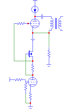

BTW, to make it easy for everyone who might be auditing our discussion, I've redrawn the schematic to make it even easier to see the current loops. I just took the output section and turned it upside down. Also added the main power supply (battery symbol between ground and output CCS). Sometimes a different view makes it easier to follow. It does for me.
Let's simplify further to better illustrate:
The cathode of the output tube can be seen as just another power supply. It's a high impedance supply, so a current change will cause a voltage change.
No extra supply, no grid current:
In the first figure (left to right), think of the battery symbol as the cathode resistor supply. The current is set by the current source (model for the driver tube and CCS).
Extra supply:
In the second figure, add a series supply. Note that the current through this loop hasn't changed, so even if the first supply is high impedance, there will be no change in voltage across that supply. Now, let the top supply voltage vary - still no change in current, so the voltage across the bottom supply cannot change.
Extra supply with grid current:
Add a resistor to the connection between the supplies and the top of the current source (model for current flow through the output grid). Now current flows in the top loop, controlled by the resistor. Now the top supply carries the original current, plus the current through the resistor. But the only path for current to return to the bottom supply, is through the current source, so the amount of current flowing through the bottom supply is unchanged. Therefore, no change in the voltage across the bottom supply.
Sheldon

I made a drawing with voltages in it in A2 state. There is an asumed 2mA grid current running, and the CCS set for 20 mA. If I connect it the standard way (anode d3a) there is only 18mA left for the driver. But were does all the current come from in this state? if its from the extra supply, does the "resistor supply" deliver any current at all? because if not, then 100mA will flow through the cathode resister, voltage will go up.
If you connect it the gyrator way, its even more difficult.
I will just have to try it, and put an oscilloscope on the cathode resistor, force it into a2 and see wat happens. I'm not smart enough to reason myself out of it.
I can follow your explanation, and with the 3 simple drawings it looks okay, but the ccs is in the upper part, not in the lower, and even there if I follow the current path its not clear to me.

Hmm maybe i'm beginning to see the light...
Only currents caused by the voltage difference between cathode/resistor potential and anodeD3a/grid2a3 are delivered by the extra supply. The main current is caused by the voltage difference between 2a3 cathode/resistor and ground.
Yes. Maybe I have inadvertently confused the issue, by implying that A2 operation can happen without the extra supply. A2 operation can only work with the extra supply. A2 requires that the voltage of the grid be positive with respect to the cathode. But the cathode node is the voltage reference for the grid, so the grid can never by higher than the cathode. Can't even be equal. If you look at the loop that circulates through the grid, you will see a closed loop. It has to have it's own power source to circulate any current with this circuit.
All of the current from the main B+ (main current) supply goes through plate of the output tube. At the cathode of the output tube, some of the current returns to common through the cathode resistor, some through the driver tube. These are the only two paths, and must sum to the total.
The power to the driver tube has to go through the grid loop power supply, and it does increase the power dissipated by the FET, even with no grid current, because the FET has to drop more voltage. However, if the gyrator connection is used the extra supply does not influence the voltage at the cathode resistor. Remember the source resistor is a virtual current source, so the current source feeding the driver tube is outside the grid current loop, and the current returned to the B+ supply through the driver tube is not affected by the grid current. Therefore the current through the output cathode resistor is not affected.
However if the grid is connected at the plate of the driver tube, the amount of current delivered to the driver is reduced by the amount of current drawn by the grid, because the current source (source resistor) is enclosed inside of the grid loop, and the grid current must be subtracted from the total through the current source. The result is that this same increment of current must go through the output cathode resistor, because all of the current that returns to the B+ supply must go through either the driver or the output cathode resistor.
I'll attach the schematic with some example voltage values. I'm assuming the series supply is 100V. Remember the output tube is upside down from the usual, to make it easier to trace the current loops.
