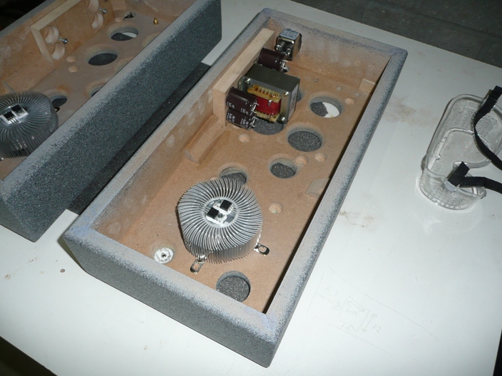

I thought that too, but even with 10 ohms between g-k it was about 75 mA and with 5 ohms about 90 mA. Now with the g-k shorted, it drifts between 99 and 103 mA. 99 when cold, 103 when hot. I'm dropping 180v/ 100mA: thats 18watt dissipation, well below max spec. (it sits on a pentium 4 cooler and even at full 18 watt doesnt get hotter then 40-50 degrees C, see pic)

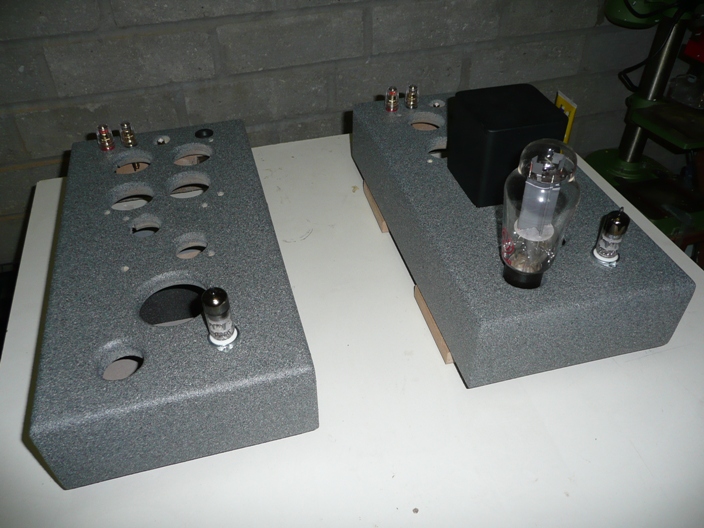

🙂 Thank you! It was meant as a temporary case, made out of cheap MDF, spray painted with "granite spray".
But it turned out too good; even my wife likes them...
Possibly i'll keep 'm just like this, and scrap the CNC aluminium idea... Saves money for the next amp😀
gr. Paul
Looks very nice indeed, and I like the color scheme a lot too. I just hope that the prolonged exposure to heat will not have a toll on seams and paintwork. Maybe mesh areas for the main valves bases to fix and for circulation can blend nicely too.

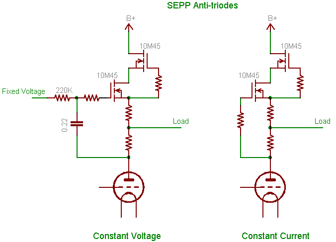

If this is a parafeed output stage you could also try tapping the middle of the Rset for the output, which turns the CCS into a complementary output driver (anti-triode). This gives you approximately 1/2 the effective plate resistance compared to the CCS connection, allowing a little more power and bass extension with the same OPT Zpri, or up to 2X power output at a lower Zpri. The parafeed cap value may need to be retuned if you do this. Another way to think about this is that you get to use the power supply voltage drop across the CCS productively, instead of wasting it, as normally done in CCS/parafeed output stages.

The anti-triode setup: very interesting! I'm gonna try it sometimes, and see if I like it. But not in this amp, I would have to rebuild the case completely. There's only room for 2 CSS's on the heatsink, and that room is used up.

Voltage is 180v@ 100mA as stated in the post with the pictures, you can see how its mounted there too.
