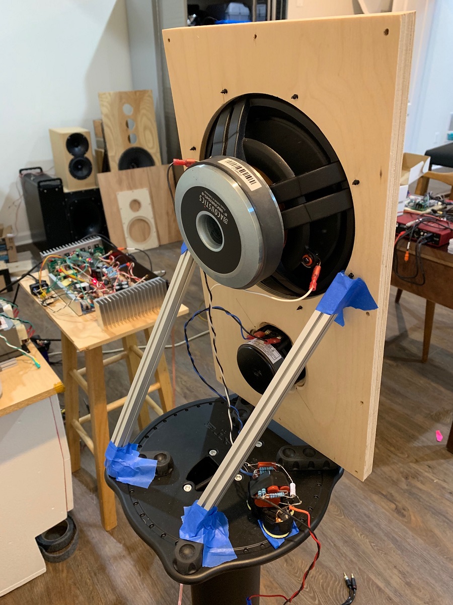

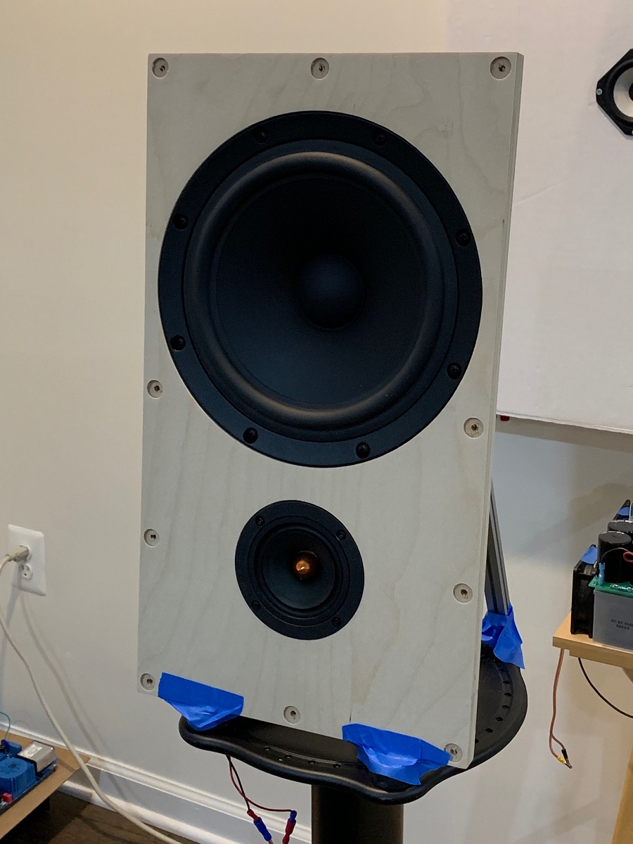

So I have had these SB23’s on hand for like 2 years now it seems, baffle precut to accept them with 10F/8424. Despite what factory curves would say that SB23NRX245-8 would or would not do with the current XO, I said what the heck, let’s slap it together in a 30min experiment and see how it works. I decided to go open baffle because I wasn’t concerned about the bass but more the mid bass and mid range. I had a PS95-8 on hand and it has the same bezel cutout as the 10F. So they went together. A little Makerbeam and bluetape later - and I am listening to it. And Wow! What a fantastic sounding speaker!
Even in skinny little open baffle frame - there was nice mid bass. Great balance.
You can listen to it here (video from my phone):

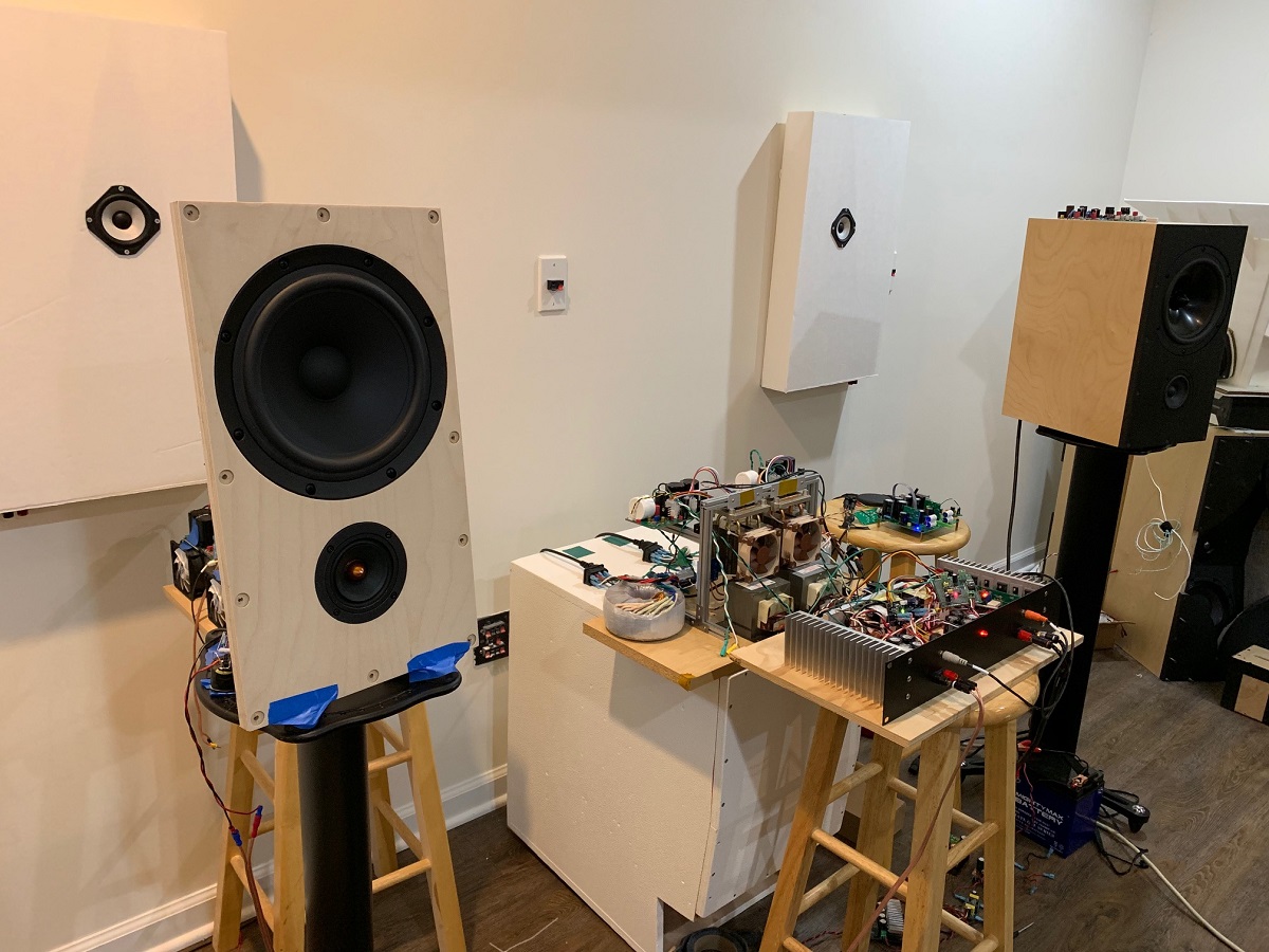

Here are some pictures and an mp3 sound clip. Change the .asc file extension to .mp3 to listen. Recorded with UMIK-1 USB mic and Audacity at 48khz and converted to 192kbit MP3.
One thing that I am seeing from this experiment is that this speaker also works well as an OB if you like. The bass extension won't be a low so yhou will need a sub to fill it out - but if you like the OB ambiance - it can be very pleasing.

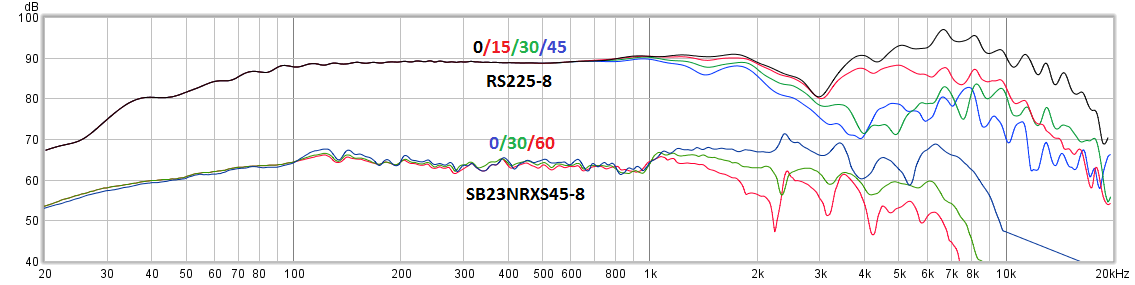

Great subjective it sounds good for whatever simple setup used so far, that said the Ref monitor naming in my way of thinking is obligatory to smooth reponses and other stuff to be superior so would like to see those big woofers filtered out above 1kHz or use two smoother woofers per side in a smaller diameter or whatever, for example two times SB17MFC35-8 will in Dunlavy way ballance vertical dispersion and help on Le difference to midtweeter in the wide 1st order transition band : )

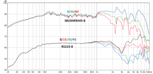

Beside the critics here is some constructive data this is basegraphs from respective datasheets, below is using Dayton scales and SBA is offset minus 25dB plus its datasheet only cover up 10kHz so above that point is VituixCAD automatic interpolation or prediction for SBA:

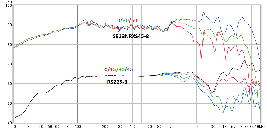

Below is using SBA scales which cut x-scale at 10kHz and DA is offset minus 25dB:
Thanks, Byrtt. I wonder how it’s going to look under measurement? We know it cannot be as flat as the 10F/RS225 Ref monitor. To do this right, I am going to have to measure 3 sweeps (M, W, M+W) import FRD into Xsim or PCD and try to crank out another XO.

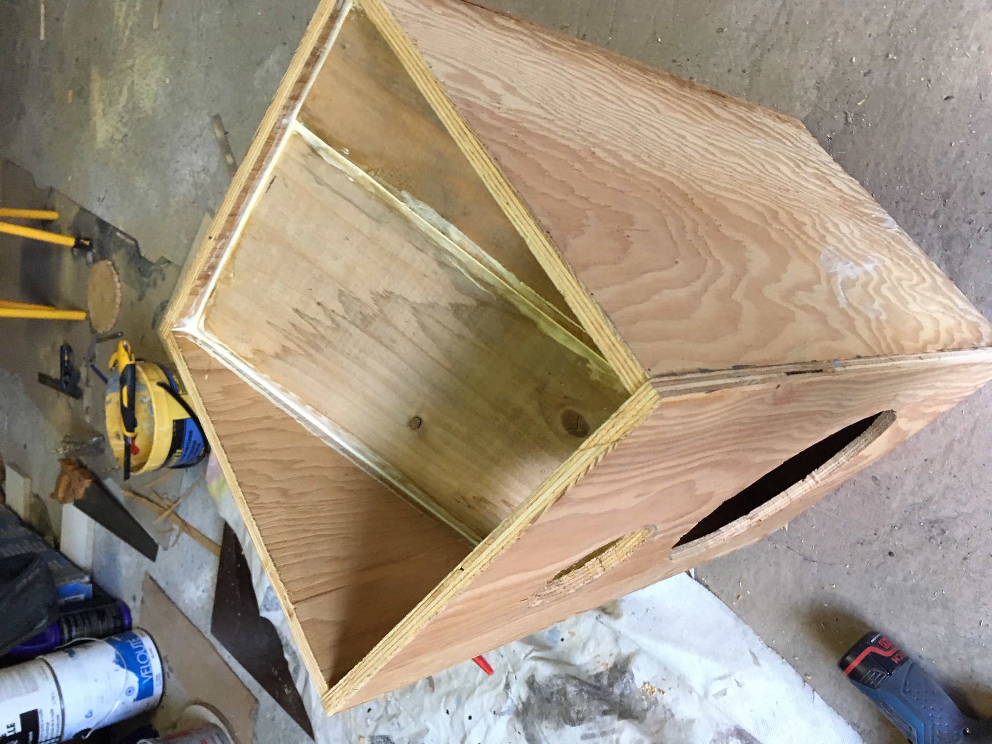

evaluation cabinet almost finished, cutting done with leftover plywood and a 12v sawzall. Not so «snail» after all... for this one at least 🙂

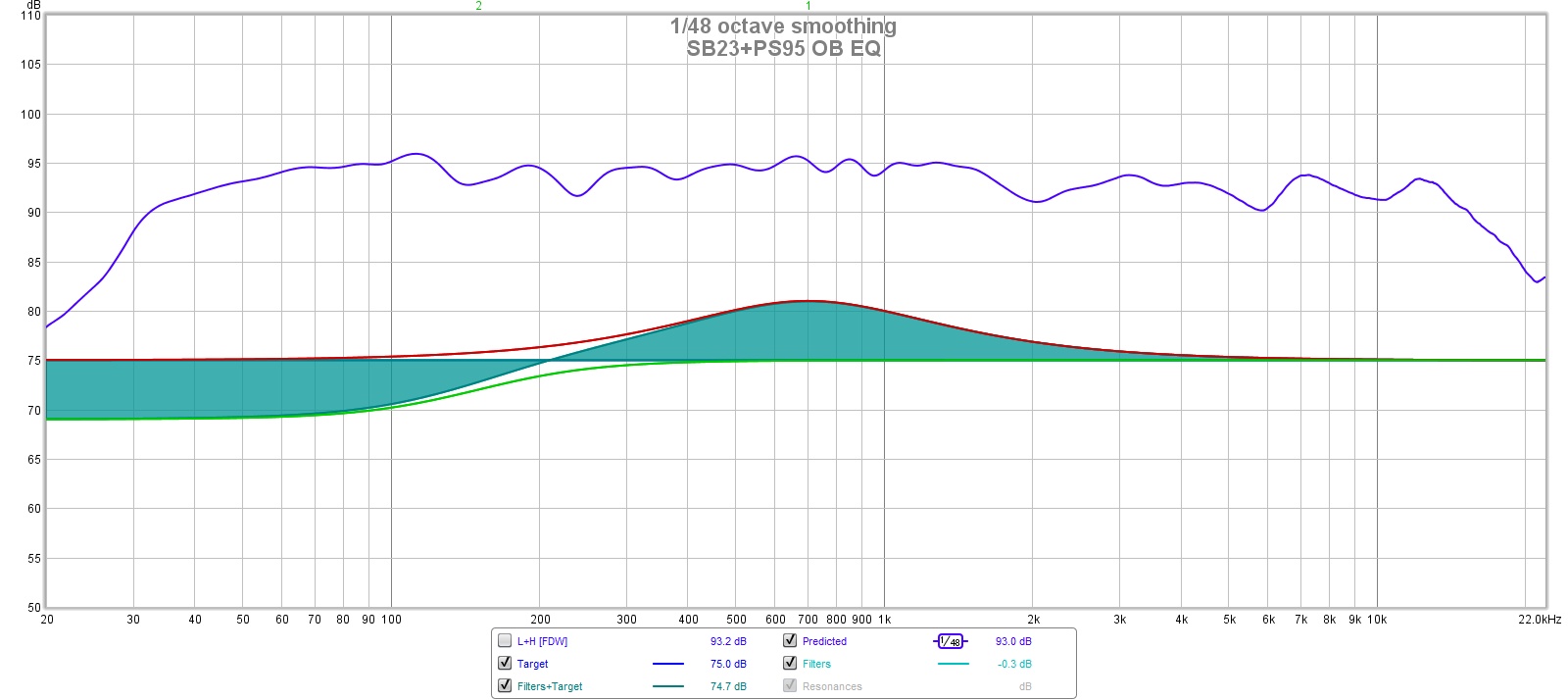

I started a new thread for the SB23NRXS45-8 in an OB. I found that a simple parametric EQ makes it fairly flat:
-6dB peak at 700Hz and Q=0.60
+6dB low shelf at 250Hz

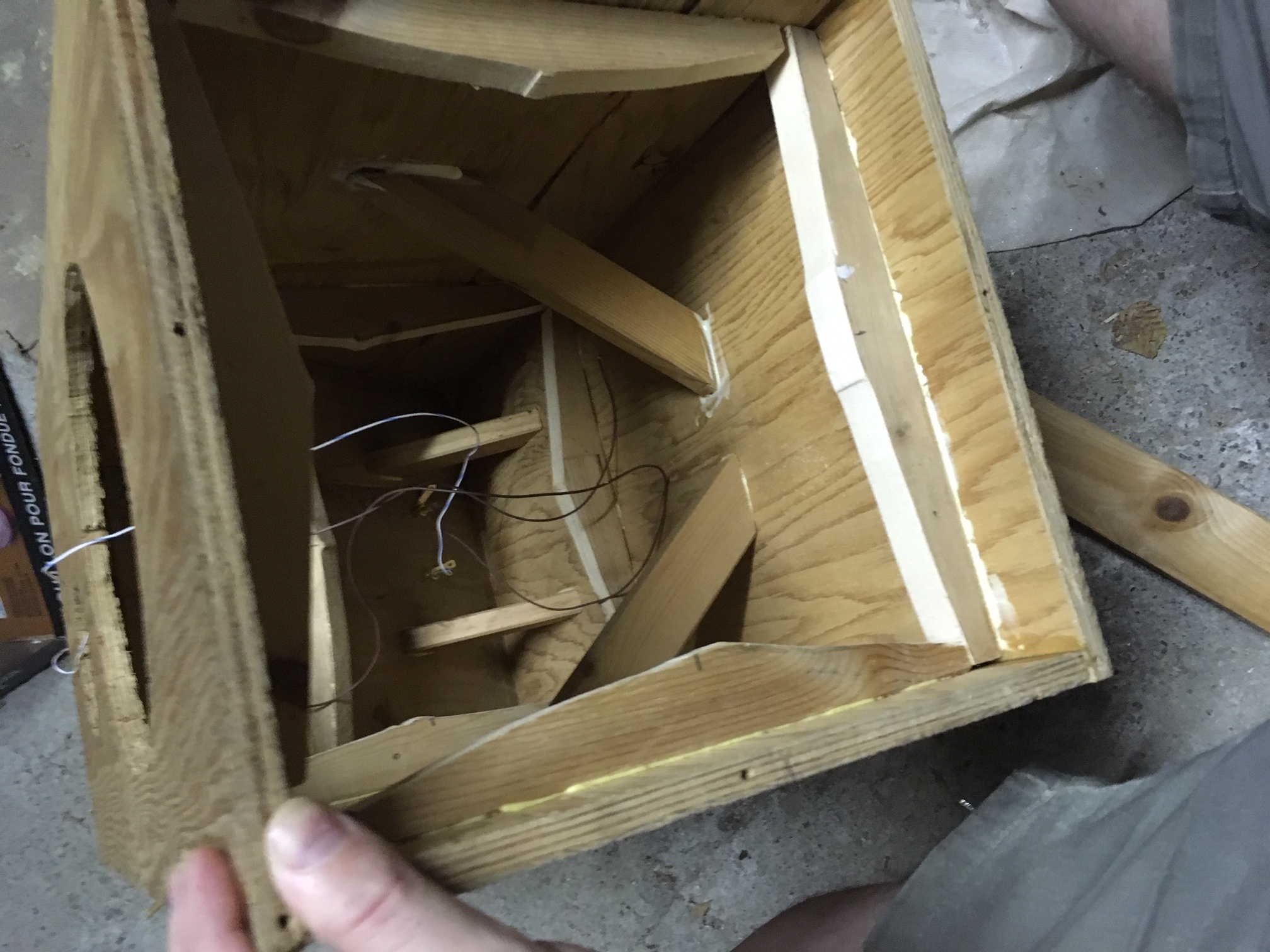

discussed a few pages back and Atto built a BR in post 1 for instance:
sometimes a minimum of curiosity pays off! 😉
You can make a taller standmount or TL or BR as long as the baffle width is preserved and woofer is on top. Taller standmount will have more volume and deeper bass extension as a sealed. Less cone control though so less maximum power.
