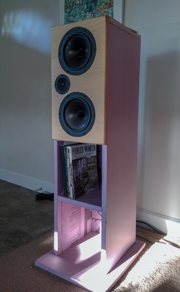

I am using an active system. Have the 225s parallel as the amp can handle 4 ohms fine. Doubled the enclosure volume so there is slightly more volume per woofer because there is only one cone for the 10f.
Wanted to try the MWM out first and see if it was an improvement. It was, and I will build some proper boxes when I get some time. Thinking about polishing up my welding skills and doing a stainless frame with wooden panels. I've done commercial fixtures like that in the past and it can look unique and pretty good.
I really enjoy these speakers. I built a foam pair that were your stock FAST design and they were fun, but these are FUN! I'm new at this and I know there is more I can get out of them as I learn and tune, but they are great now at 85-90%.

8in TL is too big to be bookshelf. A 5.25in woofer could be bookshelf but that’s a whole new speaker.

Yeah, I thought about calling it a bookshelf speaker as a bad pun, but I couldn't bring myself to do it. I knew I would need a stand and thought I would just "build it in". I think it might look good if the bottom was stainless square tube with some racks installed. If I do that I think I will make the bottom bolt on so I can change it if it turns out bad.
good idea the metal stand....brass or copper also could look good 🙂

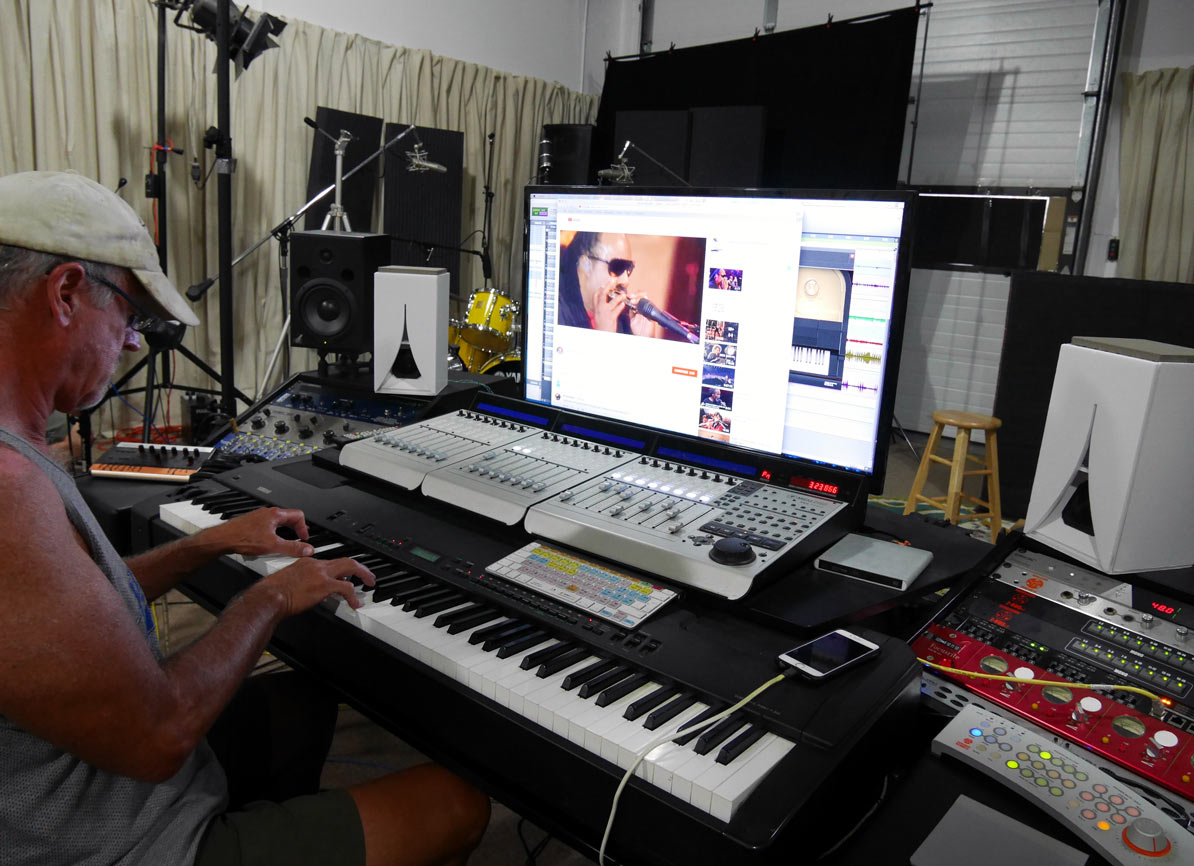

A 0.40x Karlsonator with a 3FE25 or TC9FD is a compact desktop speaker that sounds wonderful.
Mini Karlsonator (0.53X) with Dual TC9FD's
Here is one on a music mixing desk by Bonjonno:
635194d1505316980-mini-karlsonator-0-53x-dual-tc9fds-sanc-mk-0-4-jpg

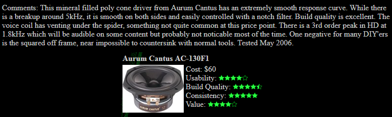

Ha ha police is calling X if memory recall is quite up to day okay about what is smooth and not smooth or did you get some second stock of that nice respectable Aurum Cantus driver or whatever : )
ZAPH site state below:
attachment.php

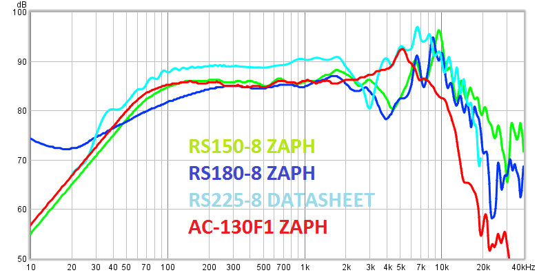

And below is third party mesurements from ZAPH site for Aurum Cantus and two of Daytons alu cone tranducers, unfortunate he had not RS-225 so took that data from producers datasheet overlaid the others:
attachment.php

That AC130 and a 10F/8424 (or even FR58EX) might make a nice bookshelf TL FAST speaker. The AC130 does not work well in a sealed as the pressurization behind the cone produces some nasty higher order distortion which was very apparent. It surprised me how well people like this driver in the Continuum as a sealed driver. Vented TL probably fine though.
Okay read you as after a second thought you had some non ideal distortion for AC130 in a sealed allignment tuned to some unfortunate dimension and allignment numbers used for that transducer, then guess below points should be ignored as unfortunate information/memory because logic is looking at the graphs that its exactly the other way around and points where a raw out of box AC130 will shine and run most other transducers over, say used over wide bandwidth and with relative low orders of XO slope.
...but I would redesign with higher quality (smoother) woofer so that fewer components needed on passive XO.

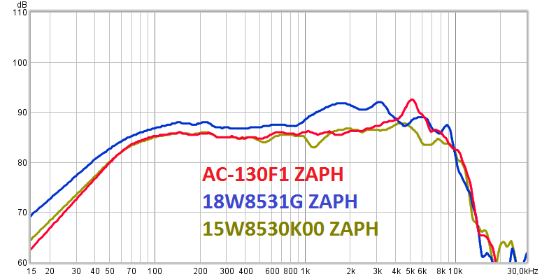

In light of raw out of box response plus smooth over a wide bandwidth is kind of exelent for AC-130F1 below is comparison some other serious smooth ones.
attachment.php
