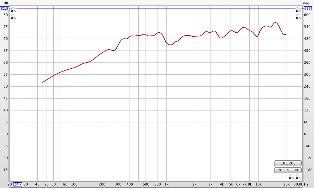

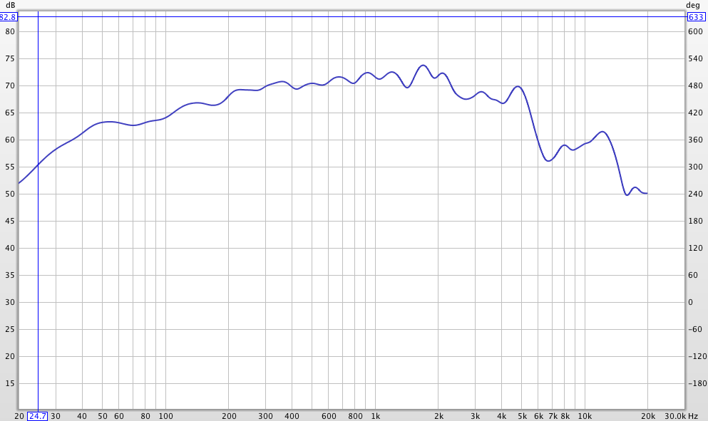

Thanks for the reply, Bob.
At the moment, I am using the miniDSP with my OB setup.
Would you then say that my chosen XO, being 300 on the W8-1772 (FR in red) and 350 on the 15" woofer (FR in blue) is too low? The graphs are taken as is, no EQ, no XO. The dBs are off as I didn't calibrate anything. But they are relative to both measurements.
I see the W8-1772 falling off naturally at 335Hz. I should choose something like 600Hz for XO?

You are looking at the second reason I don't screw with OB's. You are looking at the dipole hump on the 1772. You need to control that, and I'm no expert on how. If you cross at 600Hz, you will loose a lot of the reason for using a wide-range driver -- phase rotation in the telephone band. Then, your 15" will need 15dB of boost to get to 30Hz. I know the 1772 has too low a Qts for OB, and I suspect that the 15" is also, but that looks like a nearfield measurement.
Oh, and the first reason is that I just don't like the comes-from-everywhere presentation of an OB, but that's just me. Press on!

the 15" is a indeed higher Qts, at 0.78, Qms: 5.8.
I decided to work with the problem, instead of trying to fight it.
Borrowing on the Fast, Fun, Inexpensive OB thread, I am now using a 1st order on the 15" at 60Hz. Using the rising response of the woofer after 60Hz to keep it flat until further up.
Using the OB bump of the 1772 to match the woofer around that frequency range (needing to bring the 1772 down a bit by about 6dB, thus losing efficiency, that's the trade off), and adding a small BSC, I get a gentle downslope on the overall FR from 400Hz to 20kHz. XO on the 1772 is 1st order at 400Hz.
This was a quick test before the house came alive this morning, so I'll have to measure and tweak more, but so far it seems like a good trade off.

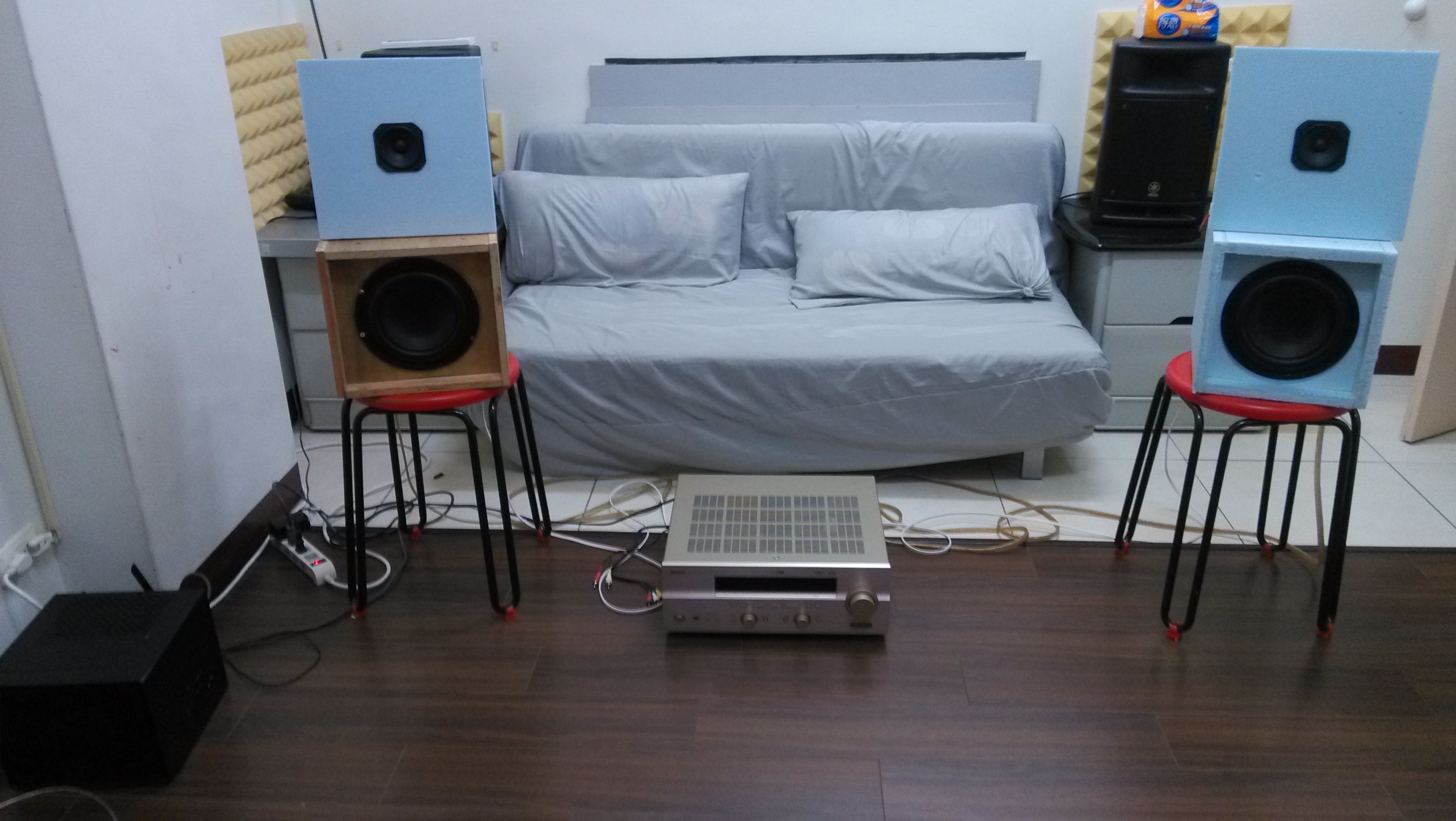

Alright...
Test bed for an upcoming build. 🙂
Should've gotten the miniDSP unit a long time ago. So easy to try different options.
But, I think I will try to get the 10F after all... it's a bit strange, but my TC9s can barely pass 10kHz.... I need to point them directly at me to get anything above 10k... then it drops like a brick after 12kHz or so...
I tried moving them around the room, from the back wall to all the way in the middle of the room. It impacts low end and around 7-8kHz, but nothing can bring the higher frequencies up... so I don't think it's cancelations.

Hi Perceval,
That sounds as a error somewhere if TC9 barely can pass 10kHz, try in exactly same chain put a tweeter and it should also be limited. Have not miniDSP box myself but seen in a lot of posts from new owners where they get trouple if correction-file they upload to unit is not same rate unit is setup to and maybe that is what wrong here in that it cuts HF at half 22 or 24kHz because of sample rate mismatch somewhere.
If you ask me you don't win any HF with 10F verse TC9, you win some sensitivity, finesse in sound and bit sharper and beautiful IR, TC9 have better ventilation which should be better the lower XO point is, SS also have a 10F with better ventilation called 8414 and cheaper than 8424 but i don't no its sound and sensitivity also goes down. For prove see below test on same baffle under 192kHz chain (FDW1/6) which includes SB65WBAC25-4 / TEBM46C20N-4B / FF85WK / TC9FD18-08 / 10F/8424G00 and also a real 25mm tweeter DT254 from MONACOR.

Thanks Byrtt, as always, you are very thorough with your replies.
Hmmm... ok, I'll bring the setup down to my main system and see if I can duplicate the problem.
I don't have a FIR file loaded to the miniDSP, so that would not be it.
The way I set it like in the picture above, using the Yamaha receiver, which has multi-channel inputs, I sent the outputs 1+2 to the main L/R, and the outputs 3+4 to the surround inputs of the receiver. I hooked the main L/R to the subs, and the TC9 were hooked to the surrounds output of the receiver. I don't think the receiver EQ the HF out of the surround speakers, but it's one thing I can test easily.
That would be the first place to look. Do the surround channels really get a full range signal? You could swap them and find out.
That's why I used the surrounds for the fullrange, because I'm pretty sure they cut the bass out to send it to the sub, so I couldn't use them for my woofers. But maybe they also cut some of the HF, to not interfere with the mains L/R.
Hopefully, I'll find some time to test that theory tomorrow.

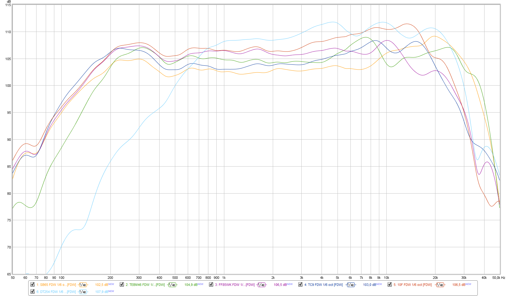

That FF85WK looks pretty nice. They all look pretty smooth, would love to see plot with less smoothing applied. I had peaky-sibilance.

Hi X yes warm thoughts from here its the drivers you gave me there 🙂 and to develop my own experience collection has grown based on findings from your nice sharings at comparison threads, guess i also need to try B80 but so far it looks for my use that TC9/10F is hard to beat and only if down the road TEBM46 will show its resonances to be repairable some way it could beat them in probably having better uniform dispersion as frq goes up.
