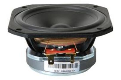

Why not go with the TC9FD18-08, which costs even less than the RS100 and won't require a new crossover as the RS100 probably would.
Yes, the TC9 would've been nice, except that the good model is the 8 Ohms. I need 4 Ohms to pair with the woofers I already have. The TC9 4 Ohms is not as good as the 8 Ohms.
Plus, since my baffle is close to 5cm thick, a round bezel will be a lot easier to deal with than a square one. 🙂

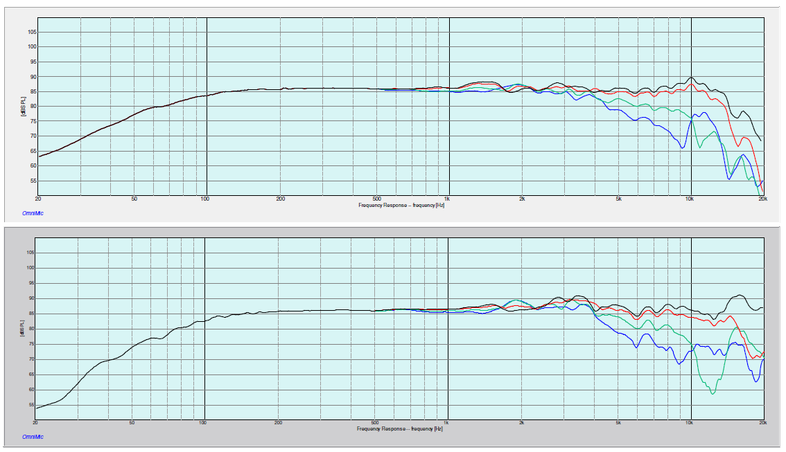

Thanks Byrtt,
The RS100P does look better, but it drops quickly after 10,000Hz.
Agree at first sight but in they use OmniMic for data think there is probably more up there if they for example used B&K mic, USB interface in OmniMic is probably running 44kHz so 22kHz point will be decades down meaning RS100 probably have even more "tizz" very high and RS-100P have less roll off than shown. Nice points for these Dayton's is their over average better low reach and high 4mm stroke compared to other in same diameter size, below curves for ALU and PAPER is from their data files which is available for download because this is reference series. RS-100P looks very smooth and roll off doesn't start before 14-15kHz area, and that's when measured with OmniMic.
