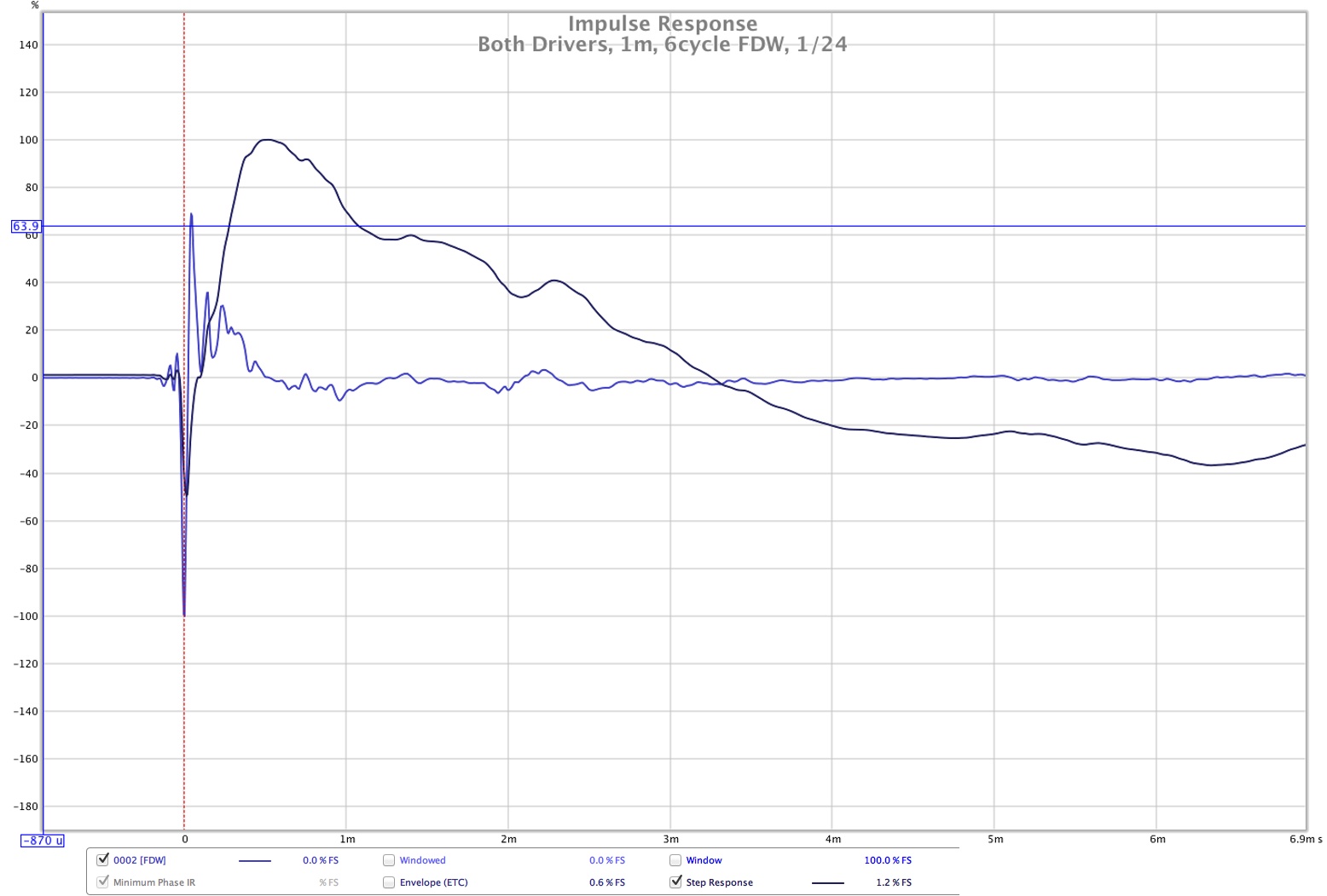

Good news, I have received the miniDST 2x4 HD.
Couldn't wait, and hooked it up. Used the default 48db XO and played some music.
Now, I need to do a lot more and play with it, just no time right now.
But adding the miniDSP completely killed the stereo image of my DAC. It's flat, dull and all centered. I hooked the analogue inputs and also changed to USB.
I hope that it can do a better job than this once it is setup properly. Really hope this is user error. 🙂
The miniDSP should not kill your imaging if done right. It takes time and measurement to get the XO right. A 4th order XO has huge phase wraps so that is not so great for stereo imaging. Try the Harsch XO - it is close to transient perfect.
Thanks, will do that as soon as I can tomorrow!

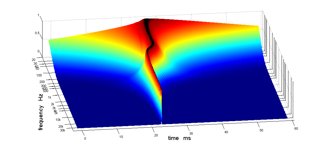

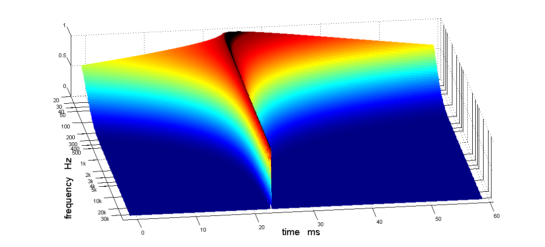

Congratulation new hardware toys perceval, can it help at least for me new toys need some practice and patience over time to get better and better results 🙂.
As xrk971 point out you use steep slopes that if they minimum phase will add phase distortion, after a look on miniDSP site can see your new unit have FIR engine so instead of using HARSH it should be possible linearize phase for its standard IIR XO slopes, guess FIR filter creation is probably pointed out somewhere in manual how to do into free Rephase. Example of steep IIR 8th order LR slope at 350Hz is seen below for 20-20kHz system pass band verse linearized and there is quite some difference.
Thanks Byrtt,
New toys are always fun.
I was just surprised on how much it affected the sound. I lost all left and right panning, and the sound became "thin".
Using the original DACs only, I had good drive on the sound. It had meat. I had it set with 2 DACs, used in aggregate mode in Mac, and JRiver to split the full range sound to one DAC, and the woofer sound to another DAC. There's an "anti-drift" function in Macs so both DACs were synchronised.
Adding the miniDSP, the sound lost its power, and it was thin sounding. No presence. More like listening to desktop speakers than big drivers mounted on an OB.
Hopefully, I will find time tomorrow to be alone in the house and get the mic out and start experimenting.
Ha! I knew it... User error...
I had the outputs setup wrong. It sounded like they were in the right place, but actually weren't.
On to testing... but my REW app is acting up. Frequency sweeps are fine, but impulse measurements change at every sweep, even though I don't change anything! Even had a flat impulse after one sweep! That was on a Mac.. I'll see if on a PC it does the same.
