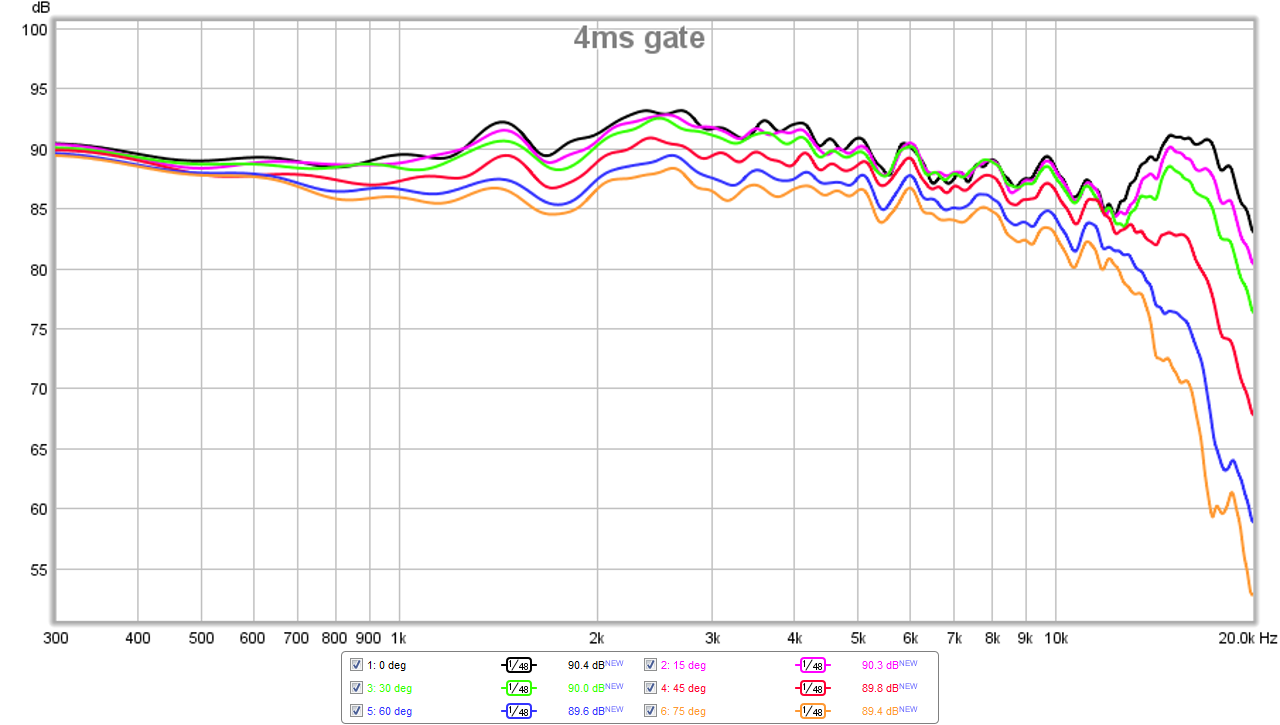

First off, let's look at the magic that the M2 waveguide provides for the LSR305's polar response - truly amazing uniformity and linearity - I don't think I have ever seen or measured anything better with this regard. Less than 2dB variation from 0 deg to 45 deg below 14kHz. This is all gated at 4ms, mic was 0.5m away. The polar response is predictable and linear, meaning that the off axis response is never greater than the on axis response for any frequency. Note that my particular units do not measure as flat as they are advertised - not sure why:

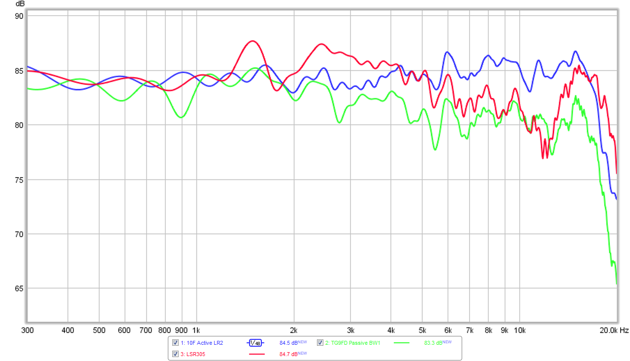

Here is the frequency response of LSR305 (red) compared vs the 10F/RS225 FAST (blue) with active LR2 XO, and the TG9FD/RS225 FAST (green) with passive BW1 XO - all at 4ms gate and 1/48th octave averaging:

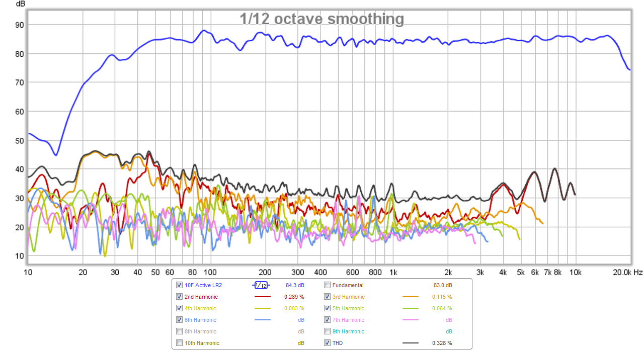

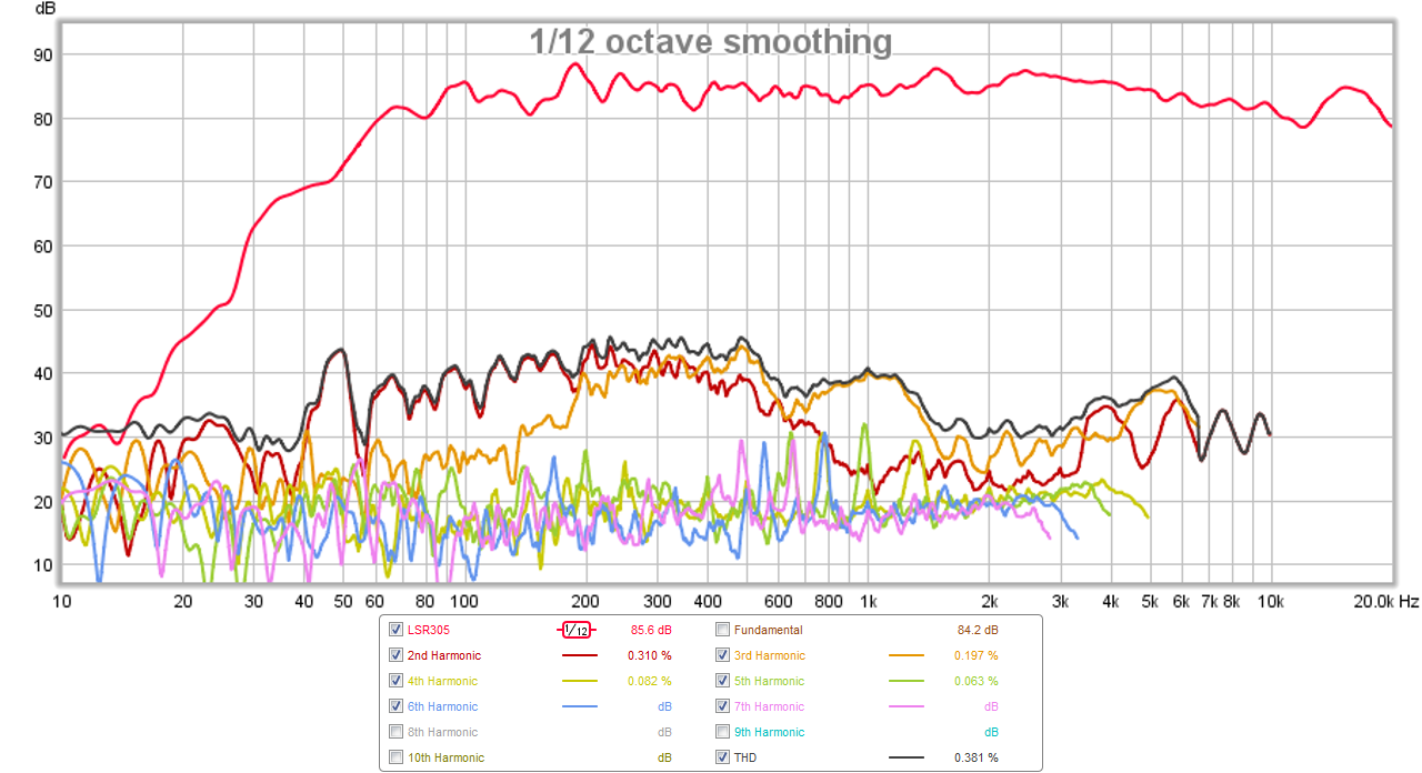

Here are the harmonic distortion performance for each compared:
LSR305 - between 60Hz and 600Hz there appears to be maybe box or plastic baffle induced vibration that causes higher distortion compared the 10F/RS225. There is another hump around 1kHz that is probably the thin plastic waveguide:
10F/RS225 FAST active XO, very clean with a rising distortion with lower frequencies due to cone excursion:

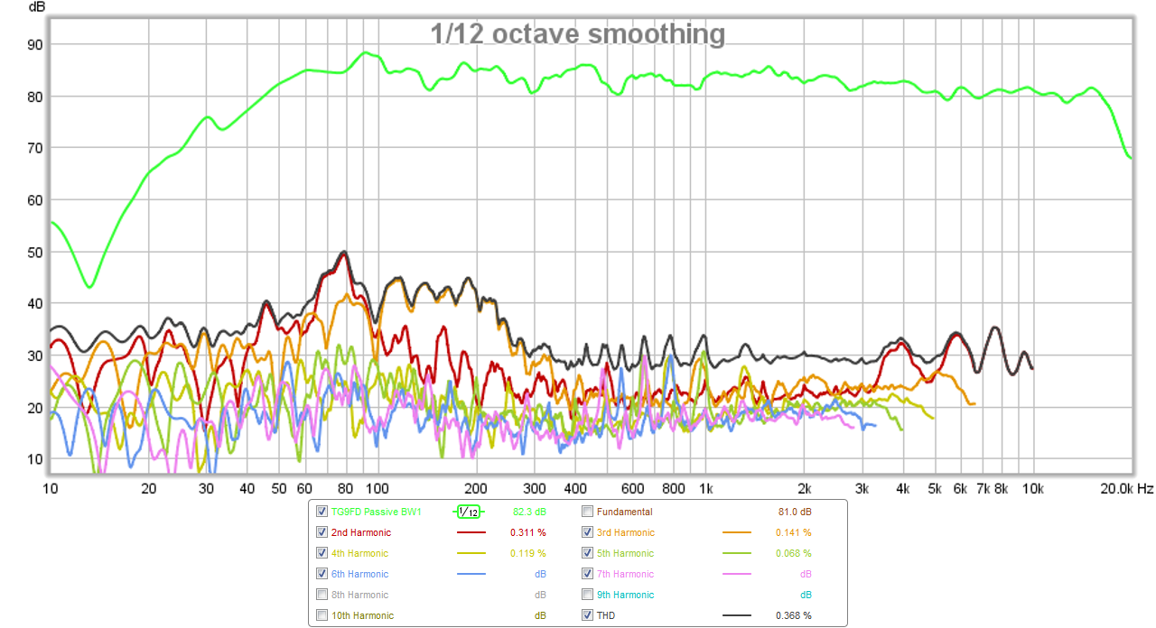

TG9FD/RS225 passive XO - there is a bump from 60Hz to 250Hz, whoch I suspect is from the externally mounted Dagger vibrating on top of the sealed cabinet as it was not securely fastened:

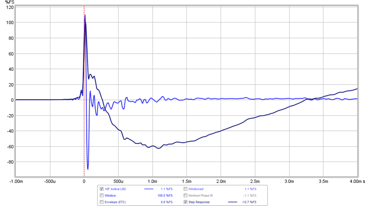

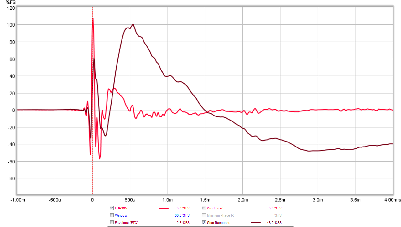

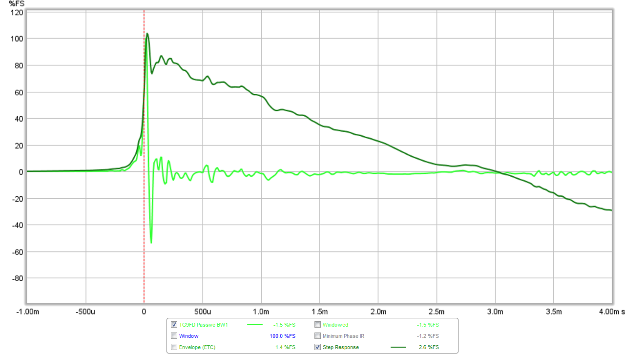

Here are the impulse and step responses compared:
LSR305 - kind of ugly with a small pre-ring and some hash followed by what is probably a boxiness hump:
10F/RS225 active XO FAST - very clean but not a perfect due to higher order XO:
TG9FD/RS225 passsive XO FAST - clean and transient perfect due to 1st order XO:

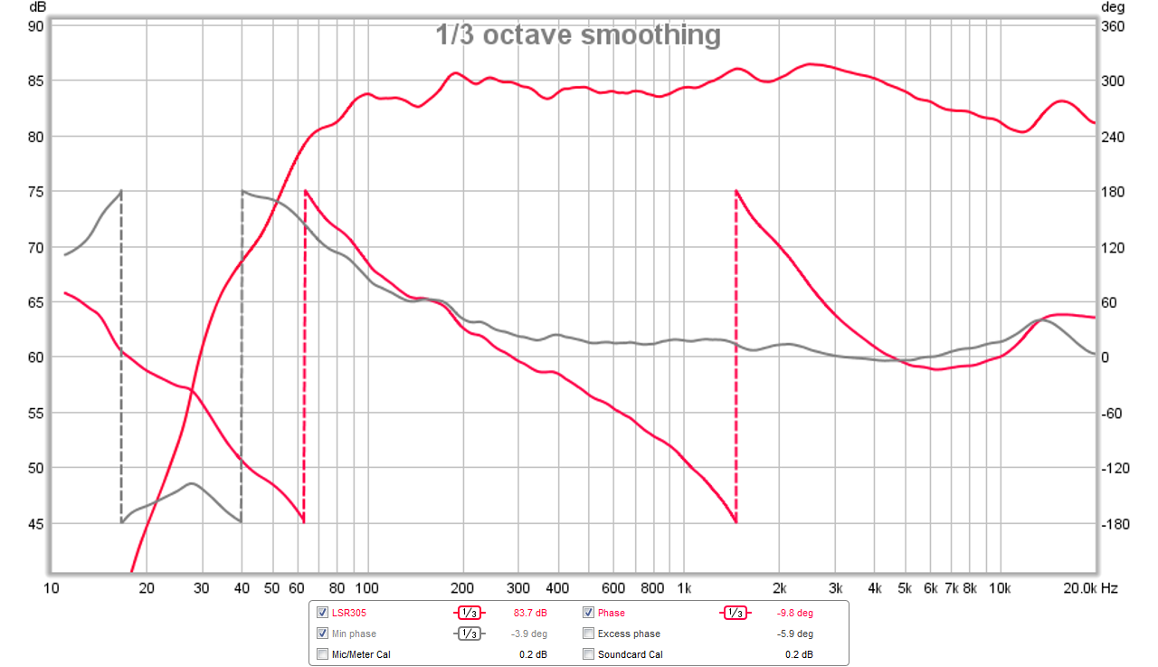

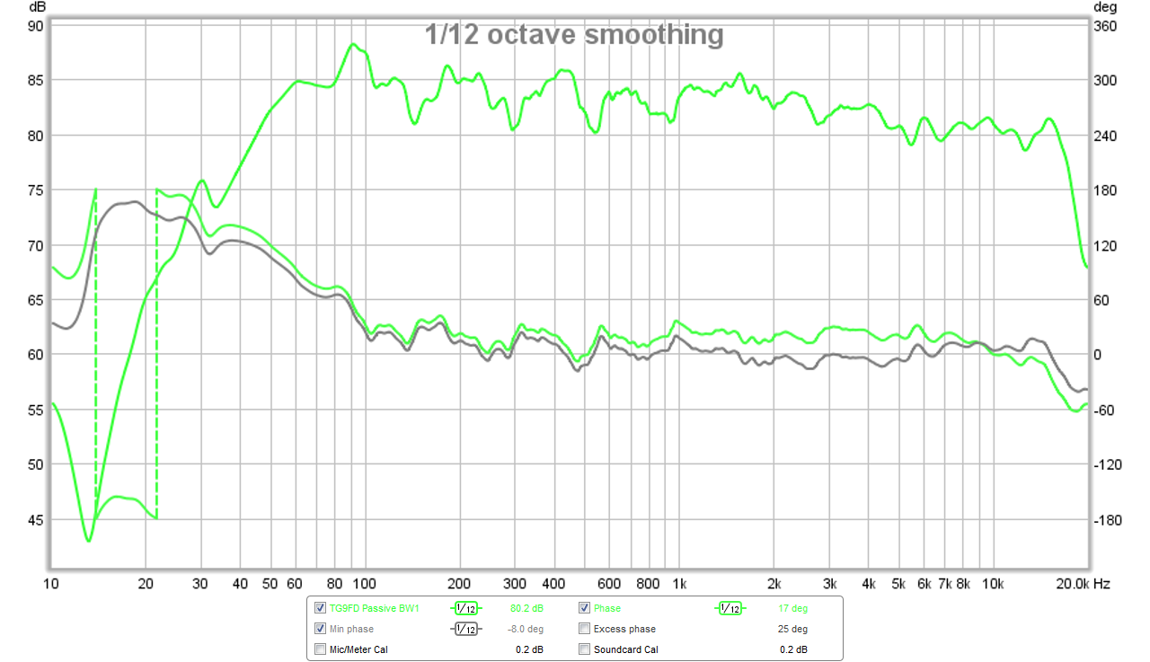

Here are the absolute and minimum phase responses compared:
LSR305 - lots of phase wrapping due to higher order filters:
TG9FD/RS225 passive XO - very flat and linear:

The polar plots sure are nice. Don't like the STEP that much though. They aimed for that phase slope if you ask me, but your TG example is more time coherent. Which one do you like most?

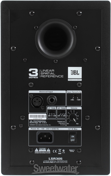

I was wondering if that speaker has the tone controls on the back? If so, maybe raising the tweeter and/or bass response would result in less peaking around 2K and an overall flatter response.
It has a +/-2dB boost/cut on bass and +/-2dB boost/cut on treble. I tried it and it raised the floor of the 2.5kHz bump up too - so no good. The posted measurements by JBL are flat as a ruler so wondering if I have a bad unit? Although is a 2 to 3 dB blip considered bad enough?
How big is the waveguide?

Here is back panel showing trim switches:

I think the polars of the LSR305 are worth repeating here since it is stuck on last post of previous page.
