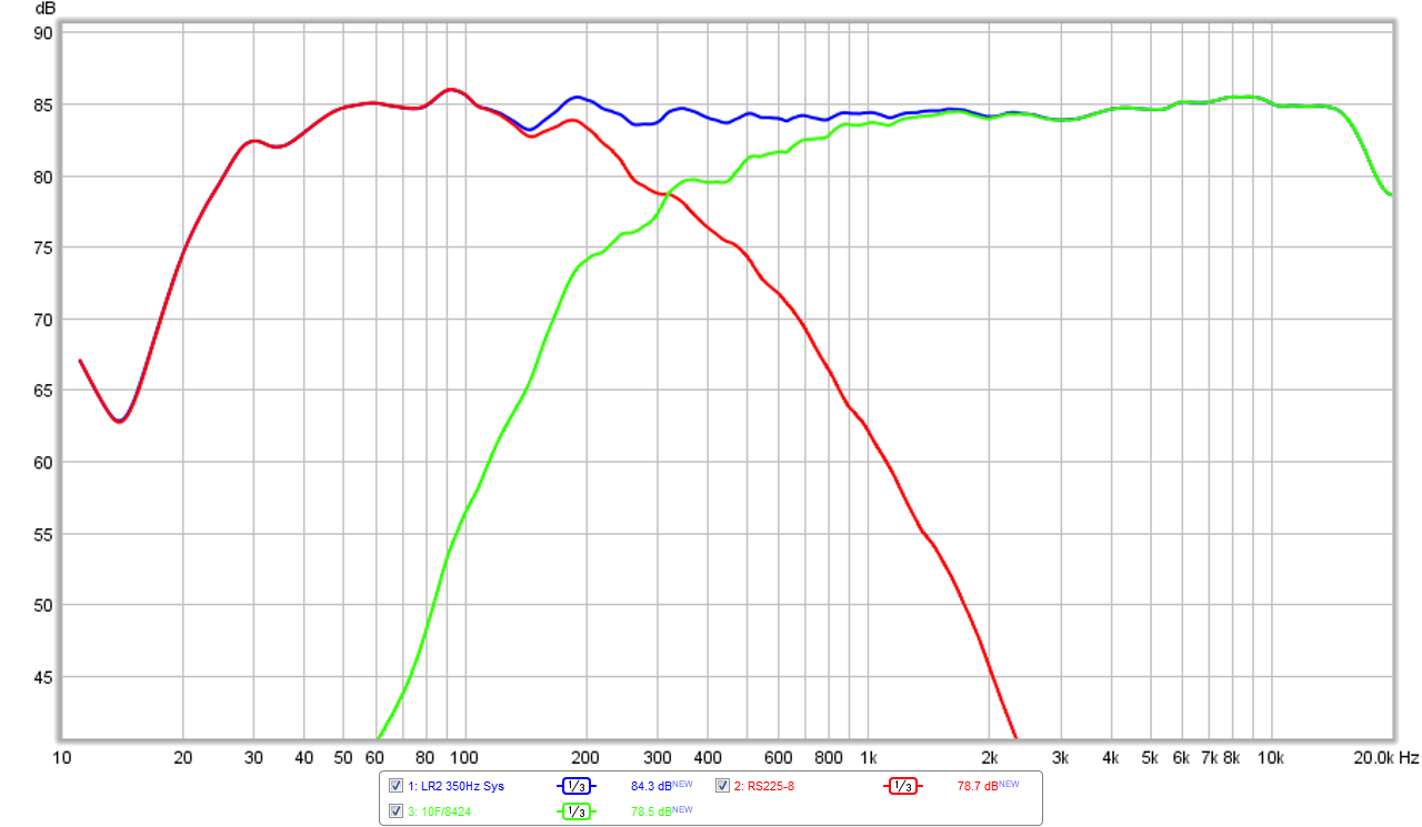

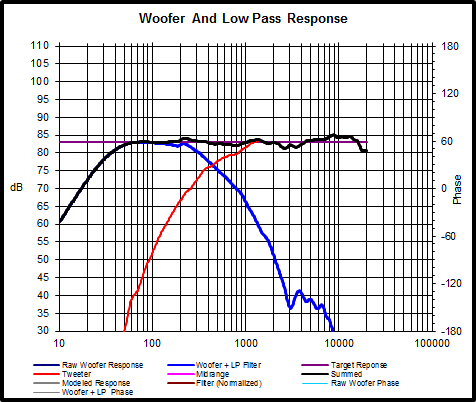

I tested out the PCD to model the active XO for an acoustic 350Hz XO for a LR2 filter and it works well. It helped me to narrow down the settings in miniDSP to get the correct acoustic XO frequency of about 350Hz. The settings ended up being a LPF at 230Hz on the RS225 and HPF at 270Hz on the 10F/8424 to arrive approximately at 350Hz.
Here is the PCD sim:
485867d1433051961-10f-8424-rs225-8-fast-ref-monitor-10f-rs225-fast-lr2-350hz-xo-pcd.png

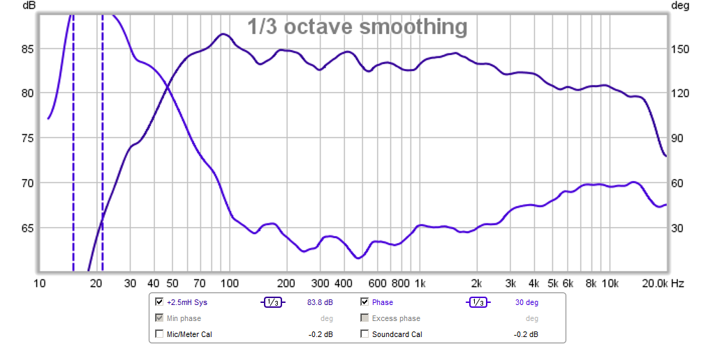

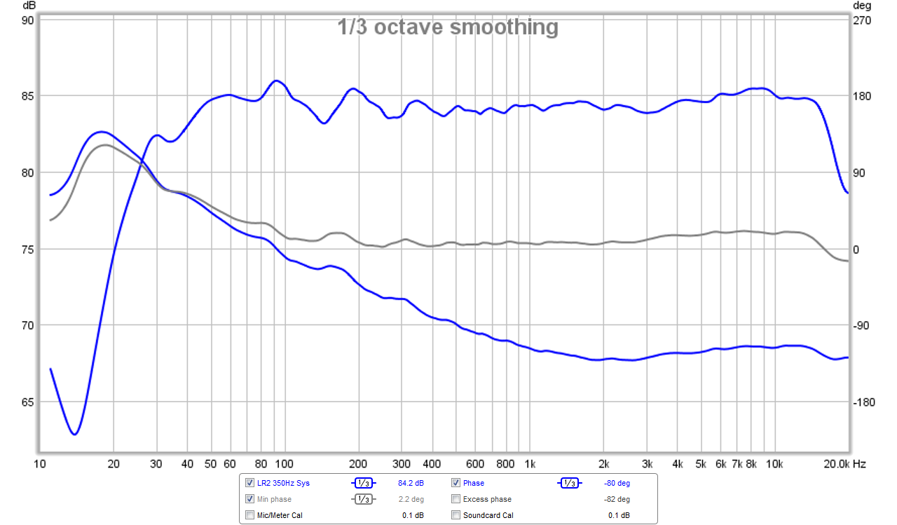

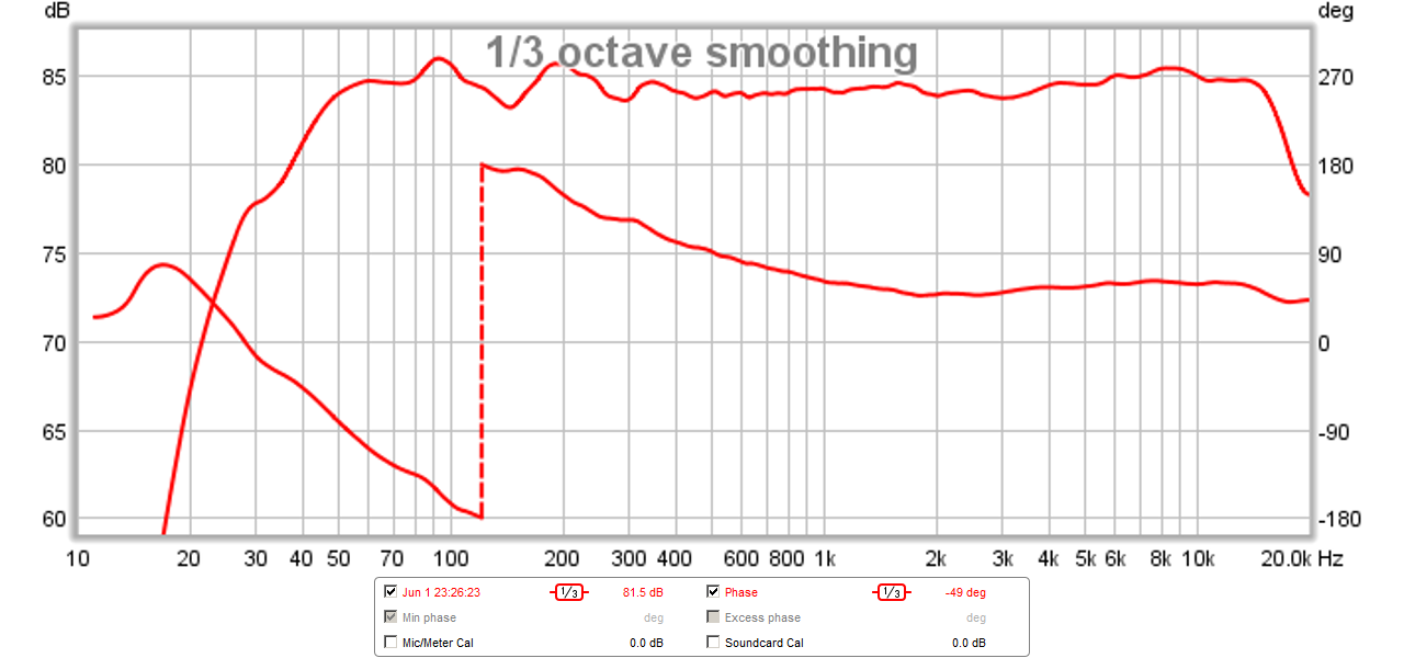

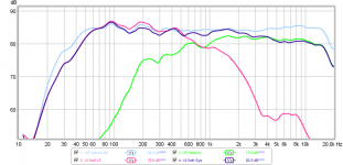

Here is the measured response (with some mild EQ shaping) the response is now +/- 1.5 dB from 40Hz to 15kHz (for 1/3 oct smoothing):
Here is the measured phase (smooth linear variation):

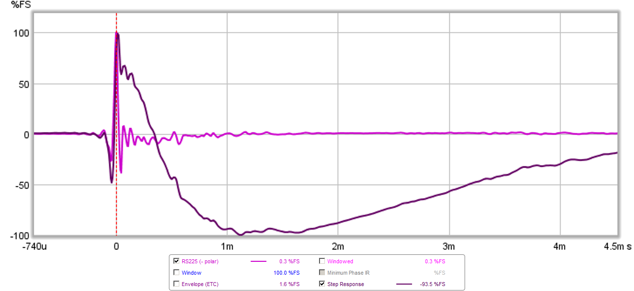

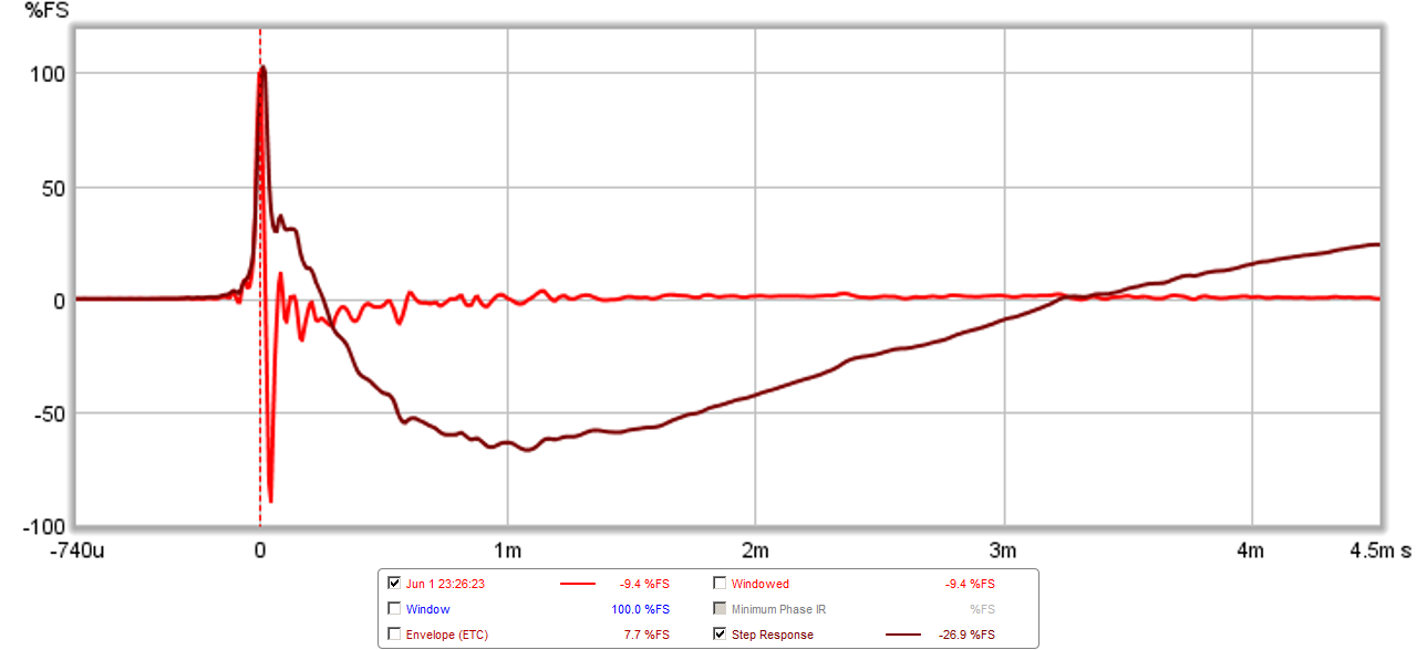

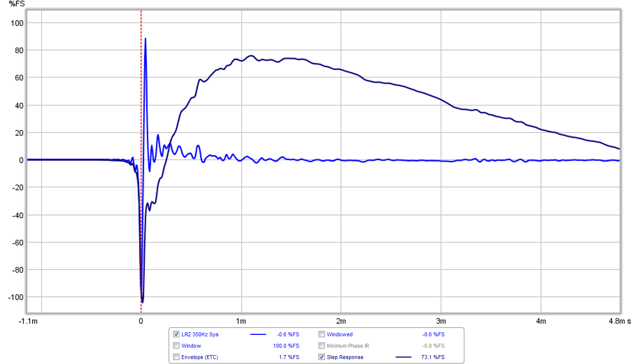

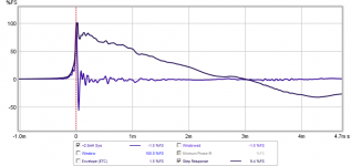

Here is the measured impulse and step response (not transient perfect anymore) with the polarity of the 10F reversed for LR2:

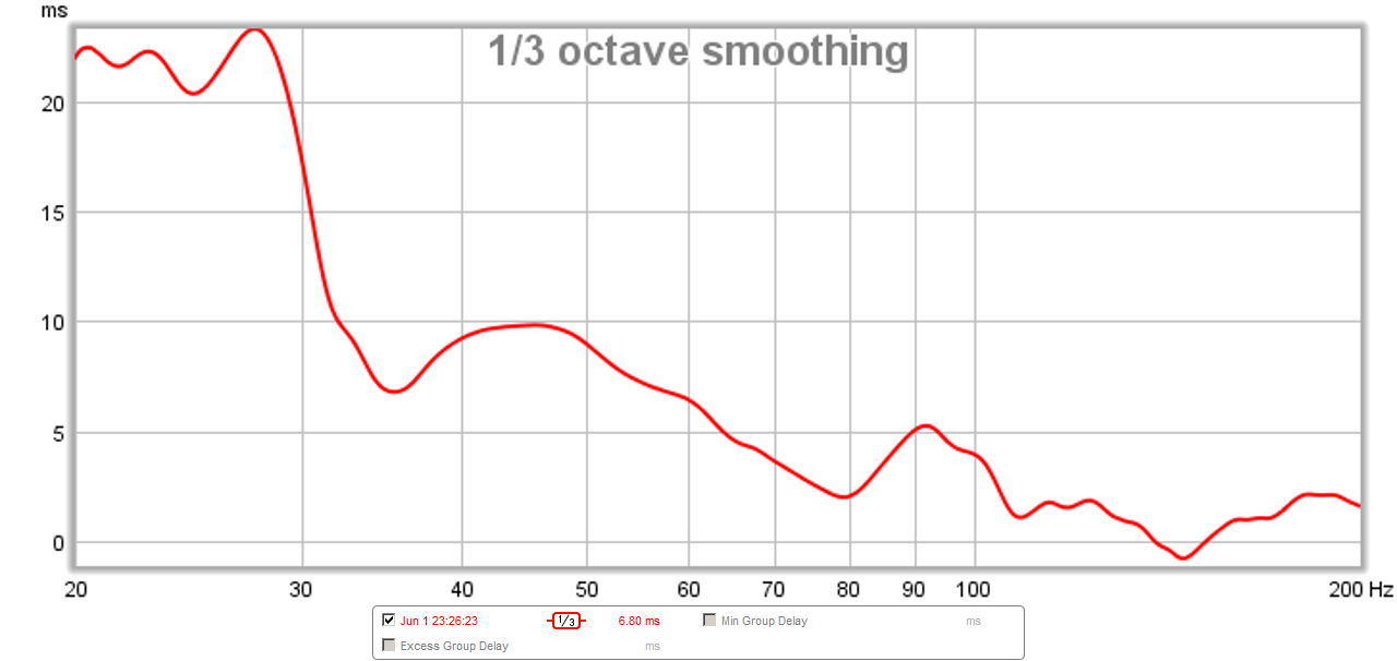

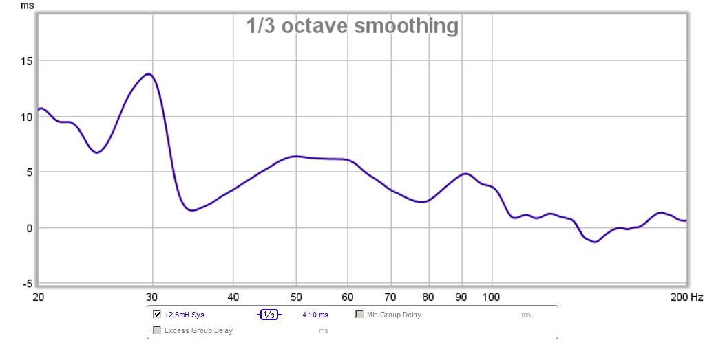

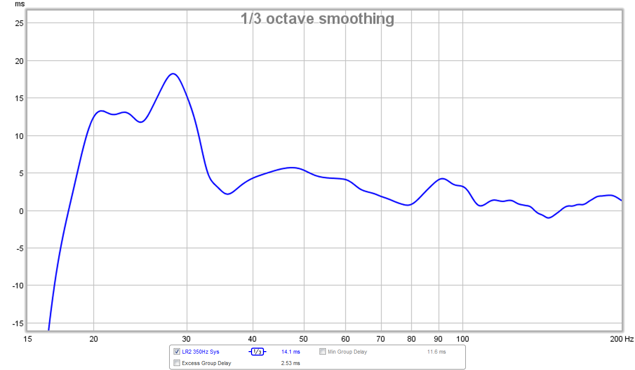

Here is the measured group delay (no infrasonic HPF on RS225) is only +/- 2.5ms down to 33Hz - pretty good:

Also, the model shows the xo at 450, but the actual shows about 325Hz. Do you know what's causing that? Maybe the actual rolloff of the 10f is a little more extended than the sealed box model i did? Or maybe it's just room reflections screwing things up.
Can you post a reverse null measurement?
I'm using your FRD curves which is probably why the XO doesn't hit right on the spot. I am still learning so haven't figured out how to import my own curves yet. There are a bunch of little tweaks on the EQ that I applied but still using the 3 PEQ's on the RS225 that you suggested. There is a lot of content in Bagby's PCD for one screen. I would have split them off into separate tabs for easier navigation with a laptop screen. As it is there is a lot of scrolling up and down and left and right. Even on my desktop 1920x1080 monitor it is still too big to see all at once.
I think my big question is the measured phase looking ok now? This is the best I have seen it because the summation is always higher than the individual traces - whereas before it never was perfectly always higher. There was always a region that was below and above.
I agree, there's way too much on one screen, especially when you're designing a three way. If you make changes to the components for the mid you can't see what the response is doing in the graph right next to it, let alone see what, for instance, the transfer function is doing all the way at the top of the screen. This on a 25" monitor.... on the otherhand, it's really a very good and accurate free program so I wouldn't complain too much!
The phase is looking much better, this is why I kept pointing out the problems you were having before and giving you the sims that I did where the problem was fixed. I don't see any cancellation on yours, but if you look at post #378, I gave you an LR2 sim. you'll see that mine has more lift to the sum above the woofer response down low and above the mid up around 2K. This may just be a room artifact in your measurements or maybe the LT is doing something to it on the bottom. Not really a big deal, but that's all I really see.

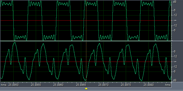

First is stereo correction method. Digital out of sound card feeds DCX2496 which is used solely for 48dB/octave crossover at 1kHz; no EQ and no delay adjustments.
Here is FR for woofer, tweeter, both together, and both together with correction filter:

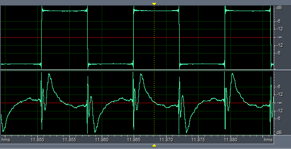

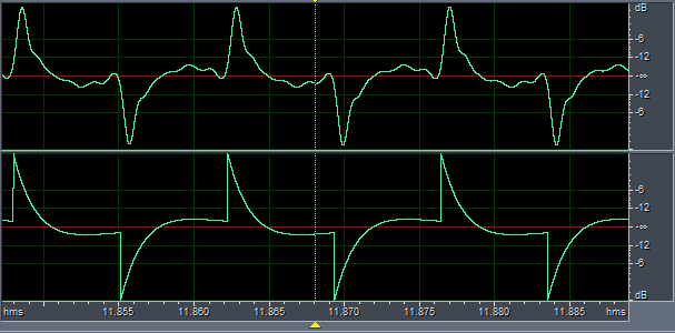

Square wave is step response test waveform. Swept square wave 5-4000 30sec. is generated and then convolved with IR for raw and corrected conditions. The two responses are aligned in stereo track for viewing:
200Hz square wave:
1600Hz square wave:
Raw square wave response is horrible for both 200Hz and 1600Hz. For 1600Hz square wave response of tweeter isn't very good when run without LR8 1kHz crossover, and is badly mangled by the 360 degree phase rotation with the LR8 crossover.
Raw woofer high pass has approximate 12dB/octave roll off of driver in sealed enclosure. This alone wrecks 200Hz square wave response.
70Hz square wave corrected v raw:
Woofer is 5.25" in 18 liter sealed enclosure!
70Hz square wave for solo uncorrected woofer v simulation with 70Hz Butterworth high pass applied twice to get classic 12dB/octave roll off:
Correlation of simulation v solo woofer puts nail in monkey coffin. No amount of equalization with infinite impulse response type filters, be they active or passive, will clean up the low frequency step response.

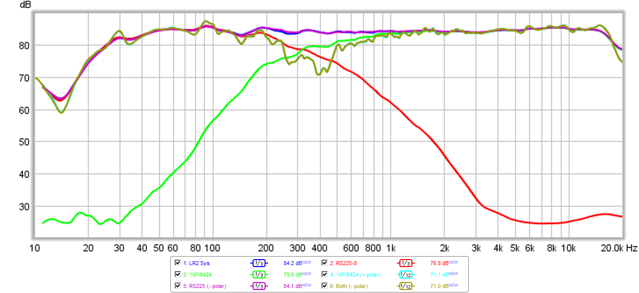

Ok, I tried it with reverse polarity on just the 10F (baseline case from above), then positive polarity on just 10F, then negative polarity on just RS225, then negative polarity on both. I left summed response with 1/2th oct smoothing so you can see depth of cancellation is -12dB. One interesting thing is that with 10F positive polarity and RS225 negative polarity (how Byrtt suggested it be done), the SR is much better and looks at least like a small right triangle rather than a blip.
Here is the XO diagram (all the same sense polarity lines land on top of each other perfectly):
485959d1433095892-10f-8424-rs225-8-fast-ref-monitor-10f-rs225-fast-lr2-350hz-reverse-null-test2.png
Here is the IR and SR for the case with RS225 negative polarity and 10F positive polarity:
485960d1433095892-10f-8424-rs225-8-fast-ref-monitor-10f-rs225-fast-lr2-350hz-lf-reverse-polar-ir-test2.png

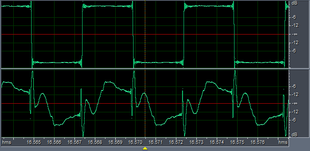

200Hz square wave:
1600Hz square wave:
Without a reference that is flat in phase and frequency responses, exploration of different IIR XO filters is nearly pointless as demonstrated by countless investigators. IMHO correction of lower octaves to flat FR/phase with DSP inverse correction filters yields greater realism across the broadest range of recordings.

Thanks for posting that. The reverse null doesn't look great (see post #378, the gray line is with reversed polarity), but it's really hard to tell at those frequencies. If you move the mic even just a little it'll probably look better or worse. Also, I believe I had PCD listening/measuring distance set to 3 meters in the file I sent you, so you might try setting it to your measuring distance to see if it correlates with what you're seeing

It's the high pass filtering stemming from output stage of preamplifier combination with power amplifier, plus output stage of amplifier combination with speaker's inherent high pass behavior.
I removed the infrasonic BW2 filter on my FAST and got the entire GD to be +/-2.5ms above 33Hz. Does this make sense? It seems to still sound good but I do see the cone moving more.
This is a perfect example, and coincides with my own experiences. My example is equalizing system flat down to <10Hz and then using brick-wall 20Hz FIR high pass filter. Something wasn't right, so I went to 30Hz 12dB/octave FIR and feel of the air in the room felt (literally) closer to live. Then I skipped the high pass filter and sensed further improvement in sense of venue reverb; this especially with classical music, timpani, acoustic bass. A setting reserved for familiar recordings for sure.

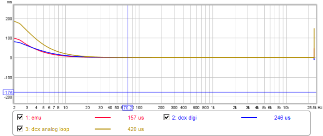

Another look at group delay; analog stages. Using E-MU 0404 USB sound card, DCX2496, and REW the IR was measured for analog sound card loop back, sound card digital out to DCX with DCX output to E-MU line in loop back, and sound card analog output to DCX with DCX output to E-MU line in loop back.
Here are overlays of GD for the three conditions:
Note how GD marked at 70Hz for analog connection of DCX is approximately sum of sound card loop back GD with digital connection of DCX loop back GD.
Here is 70Hz square wave response of E-MU loop back connection (157microsecond GD or 4 degrees relative phase) compared to 70Hz square wave of corrected speaker response:
Sound card GD is responsible for 1.5dB droop in top of square wave!

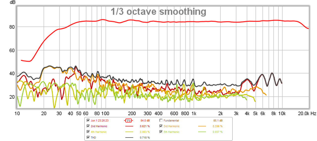

Harmonic distortion:
486203d1433219357-10f-8424-rs225-8-fast-ref-monitor-10f-rs225-fast-lr2-hpf-good-hd.png

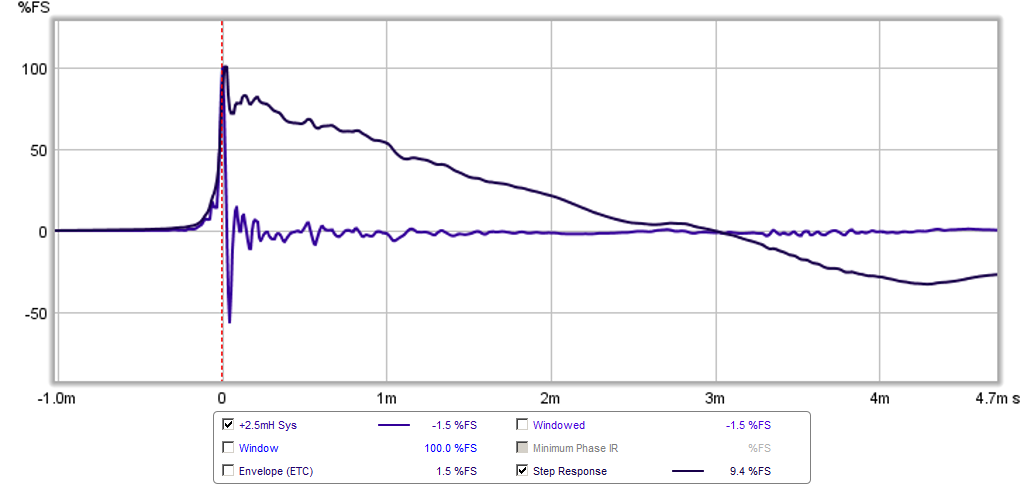

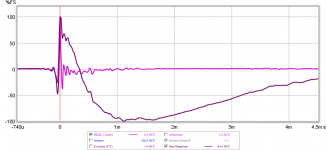

Impulse and Step Response:
486204d1433219357-10f-8424-rs225-8-fast-ref-monitor-10f-rs225-fast-lr2-hpf-good-ir.png

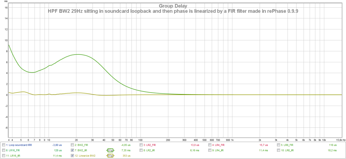

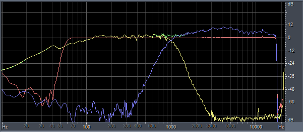

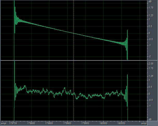

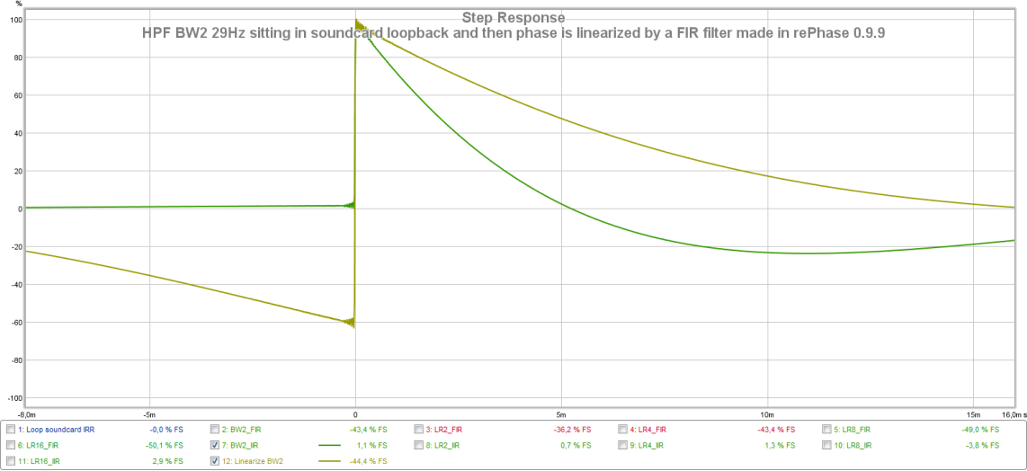

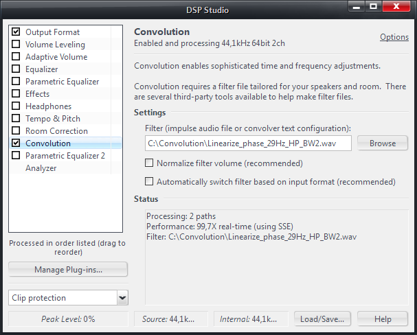

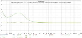

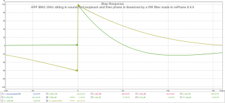

If interested in testing find in the zip folder a a FIR filter that neutralize phase for exactly a BW2 29Hz HP. If you play back with JRiver and load it as shown picture one then you can toggle on/off phase turn for that filter on the fly while playing music. As the 29Hz IRR filter is on all time in miniDSP you would have the frequency energy low cut all time but decay of impulse response is very different see at picture two, and picture three is group delay repair when both filters are in a soundcard loop. Filter is made in Rephrase v0.9.9 and is only targeted at 44,1kHz so setup system in that mode and play only 44,1kHz tracks, suggest too run soundcard with WASAPI exclusive mode or ASIO if available.
Another scenario you could turn off 29Hz BW2 HPF in miniDSP and then toggle between following tests. In the zip folder there is 10 other IR as WAV files neat for testing HP filters on the fly in JRiver convolution plugin. They all 29Hz HP in 5 IRR and 5 FIR filters set as BW2/LR2/LR4/LR8/LR16. Play music and shift the filters on the fly to listen and watch their behaviors 🙂.

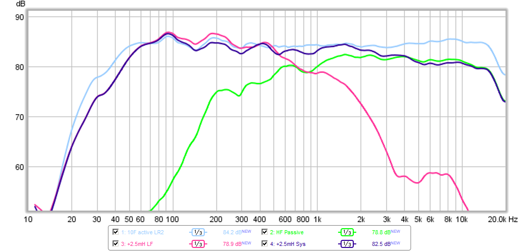

Passive XO revisited with Dagger

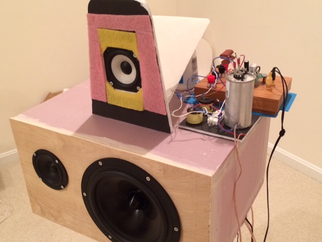

I had a TG9FD already mounted in a short vented aperiodic TL, so I put that on top of the sealed RS225-8 and connected the passive BW1 crossover that Byrtt designed (3.65mH & 57uF with 5R+5R padding on 10F/8424). The bezel of the 10F is round and I already had a rebated square bezel Dagger so I thought I would try the TG9FD first. Byrtt's recommendation was to place the HF unit 3inches behind the LF unit. The sensitivity of the TG9FD is not as high as the 10F, so the that was off. The acoustic XO was way too high with the RS225 having too much contribution above 1kHz such that the XO ended up near 1.2kHz. So I added a 2.5mH coil (1ohm series resistance) to the LF driver and this seems to pull the XO down to maybe 800Hz. Anyhow, here is the setup and the measurements.
Measured frequency response and acoustic xo plot, there is a downward tilt of about 4 to 5 dB from 50hz to 15kHz - which I think many people prefer. This would probably go away with a higher sensitivity 10F (light grey is active 10F FAST system):
Measured absolute phase:
486389d1433306561-10f-8424-rs225-8-fast-ref-monitor-tg9fd-dagger-passive-xo-phase.png
Measured impulse and step response (pretty nice) - the 3 inch setback seems to have done the trick with the time alignment:
Here is the measured group delay - very nice at under +/-3ms from 35Hz and above:
I am listening to it right now and it sounds pretty good. The bass is surprisingly good for a sealed box without any Linkwitz transform. Will report back later with more listening impressions.
