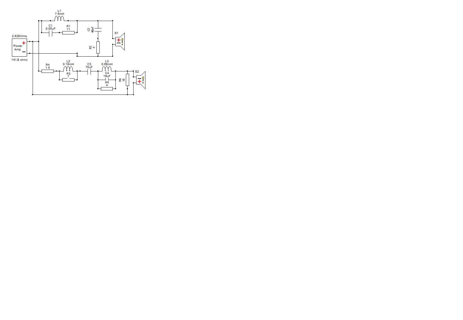

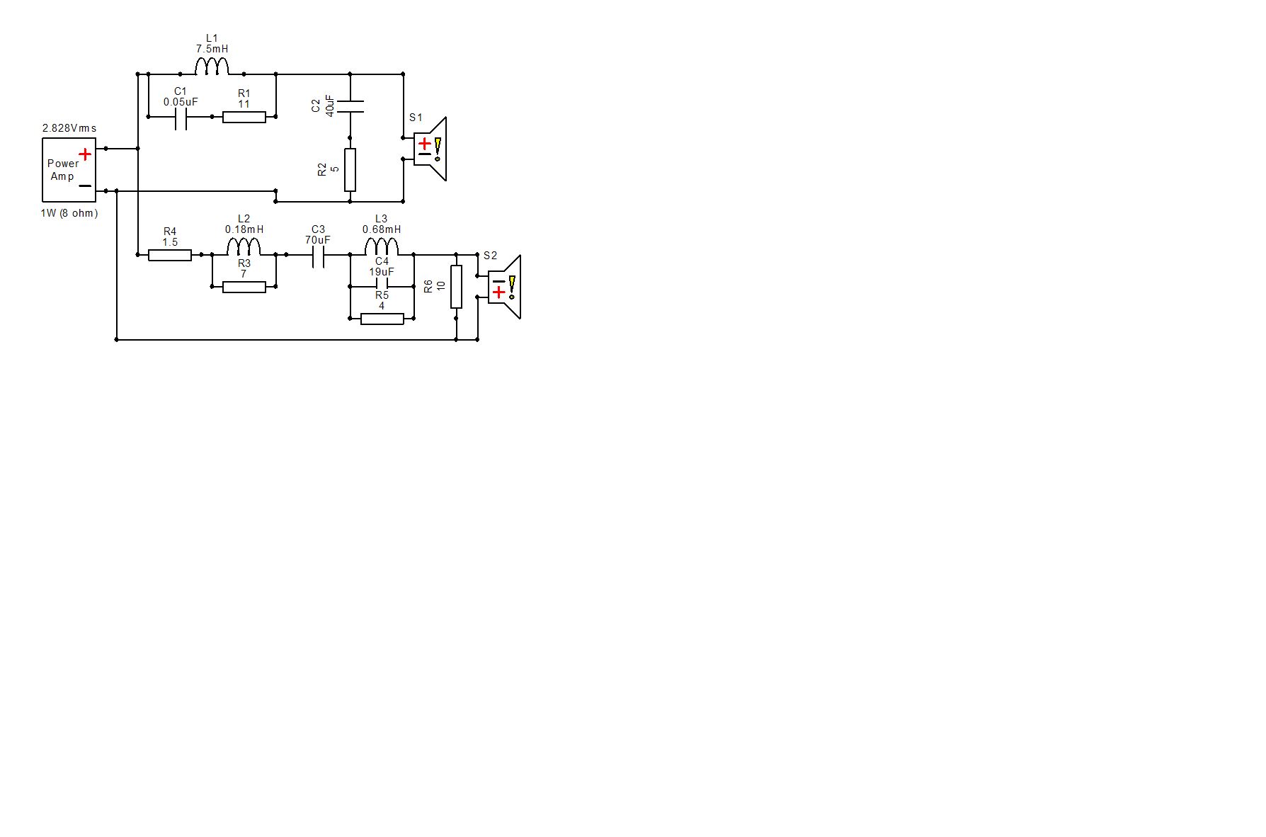

10F/8424 & RS225-8 FAST / WAW Ref Monitor
Seems like an awful lot of parts for a FAST!
Not all values are standardized, but the one that probably matters the most is the little cap across the huge coil. The two networks in series with the mid are for response shaping so you could leave them out if you wanted, or meausre/listen and see if it needs it.
Also, the lower end of the 10f isn't as nice with the shunt resistor as it is with the RLC. I'd definitely look into an aperiodic enclosure if I were you even if you stay active. I mean sh!t, you're using foam core for god's sake, how hard could it be.
And polarity's reversed
I didn't really spend much time on this so anyone that knows more about crossovers than me, please feel free make it better

Thanks for that. That is a lot of parts - I bet the parts cost more than a miniDSP and two class D amps. Is the 10F same as S1 on top?
Did you try running the XO in xsim? If you did it right, the simulated SR will look like a right triangle.
No I didn't try it. I guess I'd have to import frd and imp and I didn't feel like all that.
10f is on the bottom sorry, I forgot to label it.
Yeah it'd be pricey I'm sure.

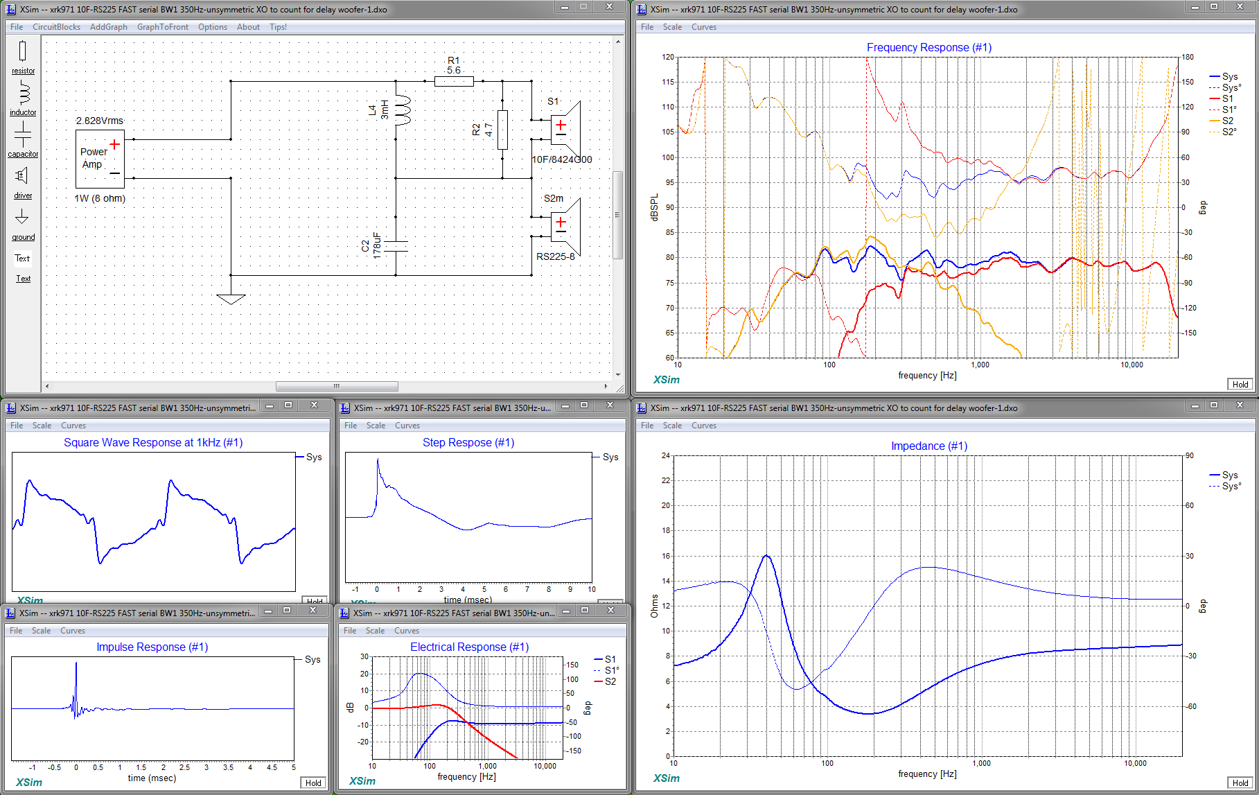

The simple XO that was tried out the coil was not a 2,64mH but a 3,64mH see schematic attached below in picture one including plots. It was a attempt from newbie in passive XO to hit close as possible the miniDSP slopes and as simple as possible because of expensive components. Frd and zma files was from actual measured setup and environment and think if drivers could have been physical aligned the FR plot with blue had been reached when measured in same enviroment, but we sadly ended up the grey plot because of the aprox. 3" woofer is behind 10F. The two resistors xrk971 had was 5ohm instead of 4,5/4,7ohm and change very little.
Learn more and more these discussions and seems the right woofer if seeking perfection to pair a 10F with soft BW1 XO probably must be a less diameter woofer so there be more clean FR/Phase overlap the two between and they can unite more as one driver with transient perfect response.

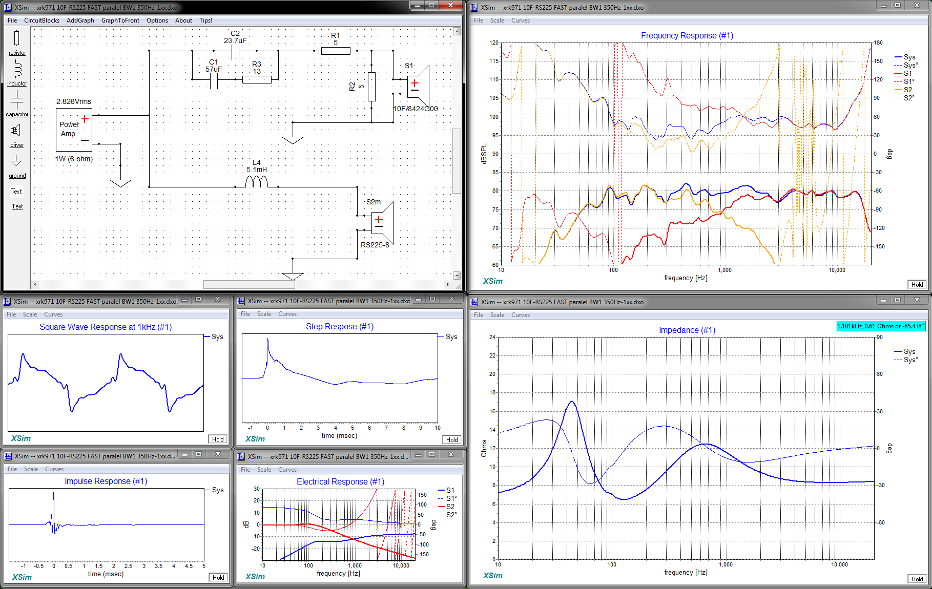

Another simple passive possibility that takes care the 3" offset is below in picture two, 3,64mH needs to be 5,1mH and that one i know you can make in own lab, then a 23,7uF capasitor and 13ohm resistor is needed. The best IR/SR and square waves of these two is the above with physical alligment but this one not bad and still relative simple.

For physical removable Dagger box use the parallel XO with the values you already have the midrange boost it made should be fair flat when offsetting 10F back relative to RS225. I attach a frd file this parallel XO you can use as target overlay in REW on axis 10F distance 0,5m, and then offset until target is hit then SR should look pretty good or close.
