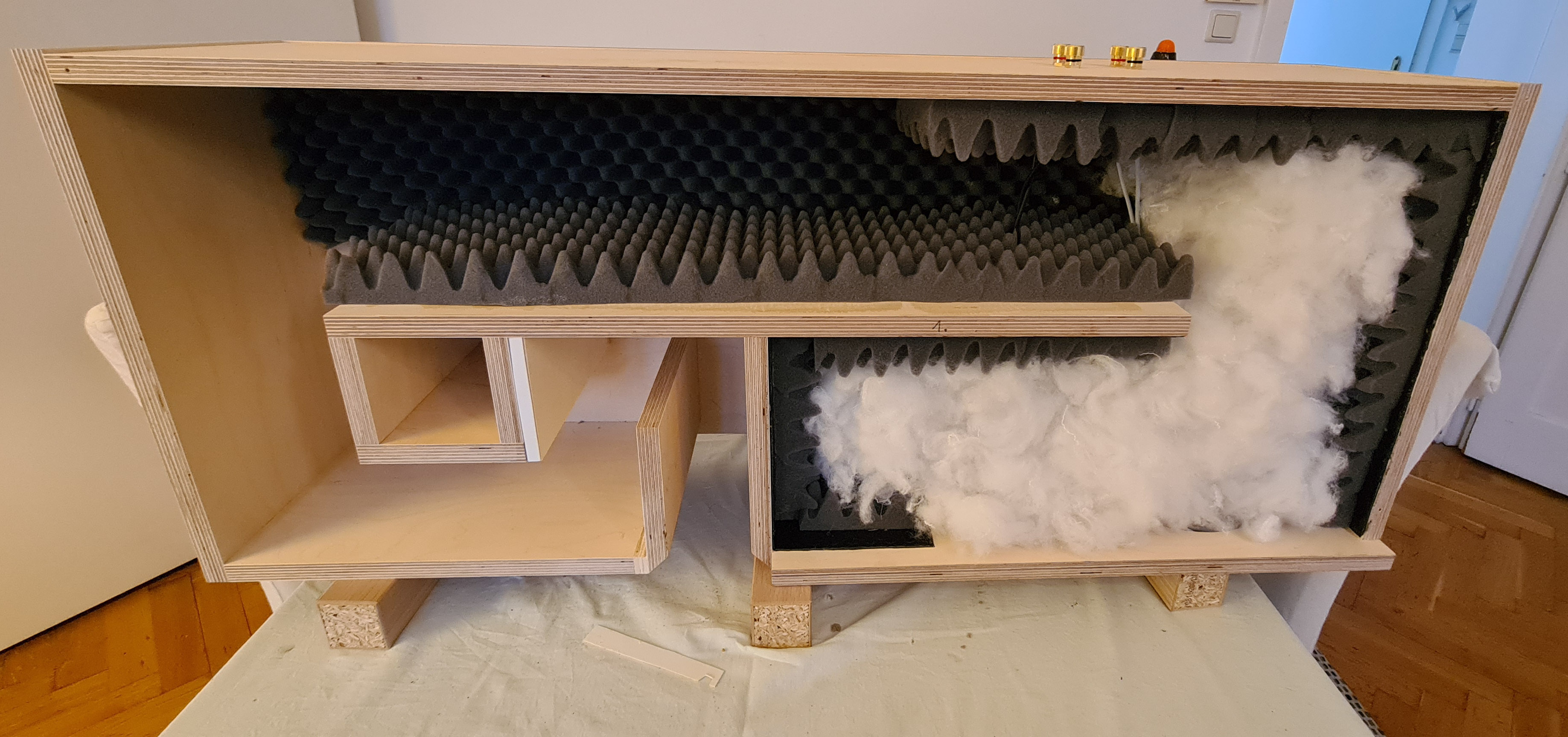

Hi X, stuffing in progress. Even though I've read everything, a question remains. You wrote we need stuffing in the size of two Nr.5 soccer balls - is that per speaker or both speaker together? How critical is the even density, should the stuffing be squeezed like in Frugal Horn or is it enough to place it just losely? Thanks in advance.

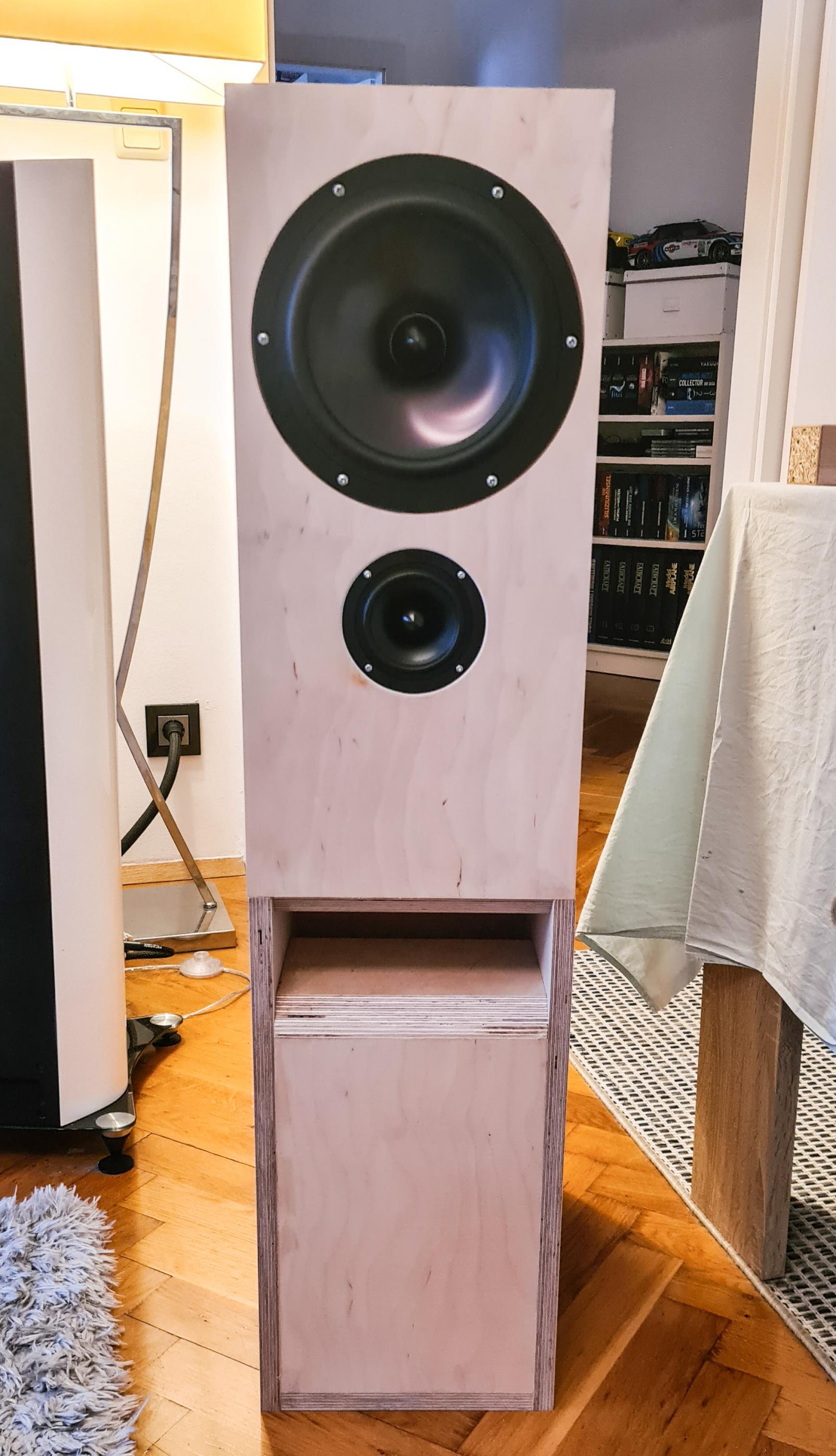

@X, I could not wait and listened to the speaker in mono... since one hour... this is an incredible speaker, I am almost speechless.
I have Sonus Faber's, but the MLTL outperforms it easily. The midrange is beautiful, open, live-like, exactly how I like it, and most importantly this range is not nervous or harsh and not tiring. The lows are deep and punchy but not overemphasized, with great rhythm and never-heard detail.

Glad you got first sound and like what you hear. What model SF’s do you have? I think I see them in the background (white cabinet). These are tapered TL’s not mass loaded TLs. The articulate bass you hear is a tapered TL signature. It also opens up the clarity of the midrange. Great work!

Oh... X, now I understand... this speakers are tapered ML - I thought from the first second on these are MLTL, but why? 😕 So now I understand your remark... 😀
Typically MLTL speakers have a smaller sudden contraction for the vent. Like a long rectangular channel with a smaller vent. An example is Tabaq speaker. Often the vent looks closer to smaller on on a bass reflex. On a tapered channel TL, the channel cross section gradually gets smaller and has a rather large cross sectional area for the vent.

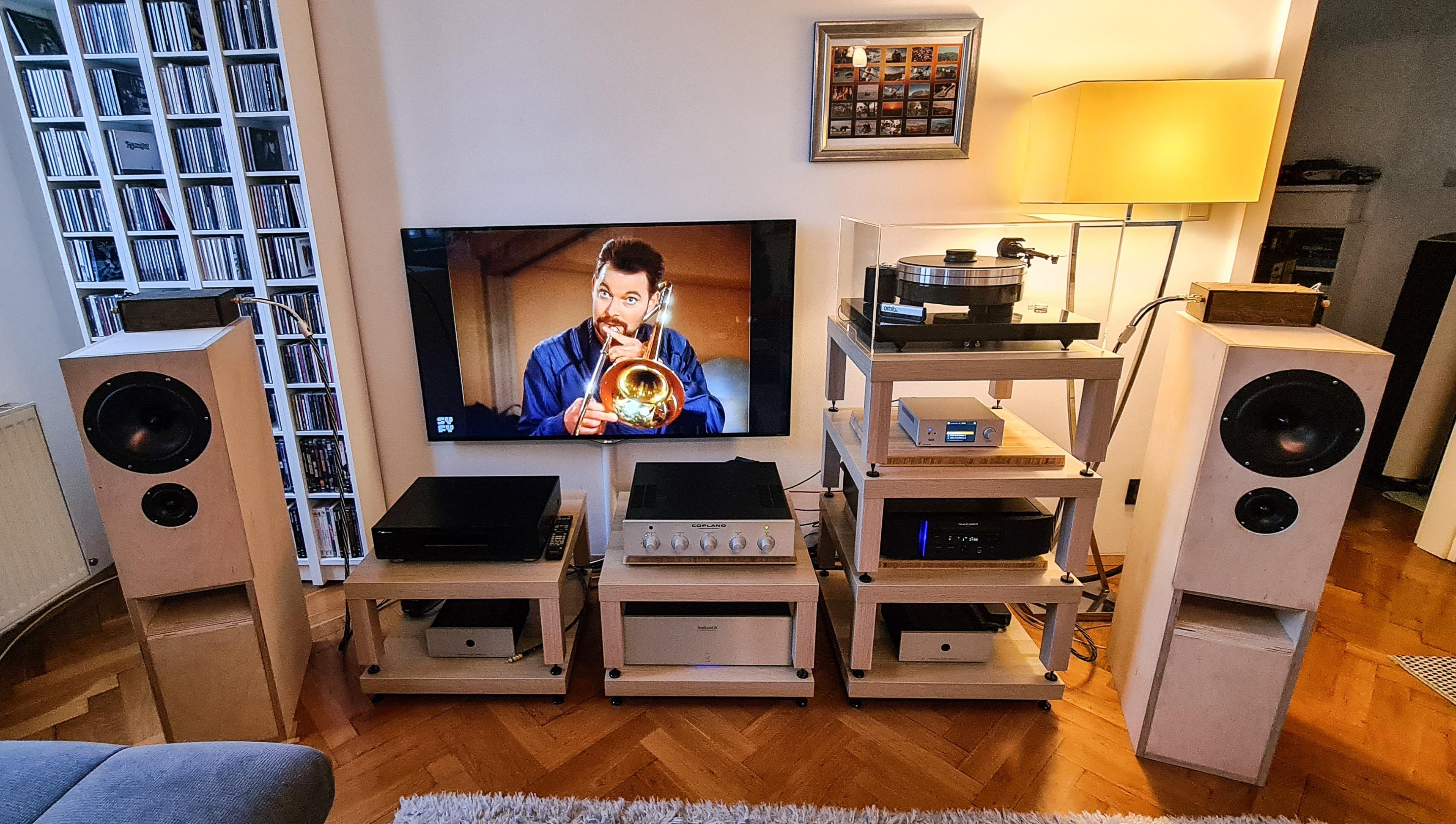

Finished 🙂 Placed in the my listening environment I noticed some lack of the lows so I started to tune the speaker. My original stuffing was 112 g per speaker (about 3,95 oz), now I have 83 g (2,93 oz) and it is much better, but I still have to play with it. But it's fun 🙂
On top are the external xo's.

Forgot to mention, in the cone I ended up with 8 g stuffing (about 0,28 oz).

Your wall of audio gear is quite a nice sight 😉
If you feel the need for more bass, reduce the amount of stuffing behind and over the top turn of the RS225. That section looked a bit over packed with stuffing from your picture.

Yes, this is exactly the area where I have reduced the stuffing 🙂

So you are tuning your speakers while watching an episode of Star Trek: TNG? Cool!

Guilty 😀So you are tuning your speakers while watching an episode of Star Trek: TNG? Cool!
