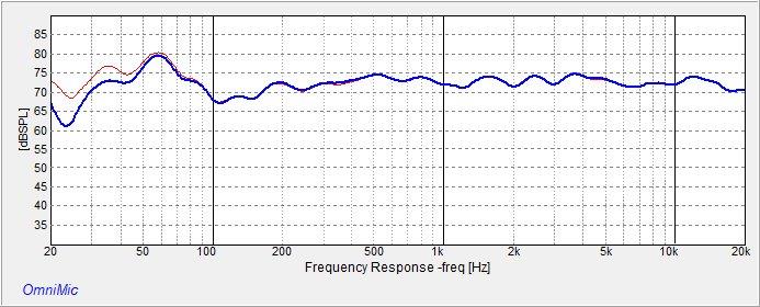

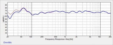

In the meantime I have taken a measurement of the frequency response, because - as I have already written - I still have to play with the bass area. Now, here is the confirmation, too much stuffing removed, it's boomy @60Hz and has a trough @110Hz. But the range above - great 😀

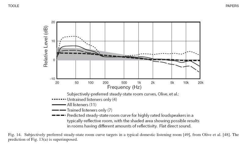

Did you measure at the listening spot with both speakers playing? If so, I wouldn't call it "too much" but rather: pleasant.
Look at the "in room" JBL curves that different groups of listeners prefered:
Do you see that many (almost all) listeners prefer a higher bass output compared to the average level above it? It would also depend quite a bit on your average listening levels. If you play 75 dB on average you'd probably like or prefer to hear higher bass levels than if the playback level is 85 dB.
"flat in room" isn't or shouldn't be the exact goal. Flat measuring speakers are meant to be: Flat measuring speakers in an anechoic environment.
That's what Toole meant by "flat direct sound" in the graph above.

Thank you 🙂 No, it was near field @1m, right channel only. But you are absolutely right, it counts what's at the listening spot. So maybe I shouldn't play around 😀 However, I want to understand how it works, so one or two rounds with the stuffing will be made.
Your ears at listening position is ultimate guide. You can also look at impedance sweep. Adjust stuffing until impedance sweep shows that two peaks straddling tuning frequency circa 30Hz starts to go down and minima starts to go up. That may be “too dry” for some.
That is, shape of two rabbit ears becomes a cats head.
My guess is that your measurement, looks perfect. It’s very room mode dependent at 1m.

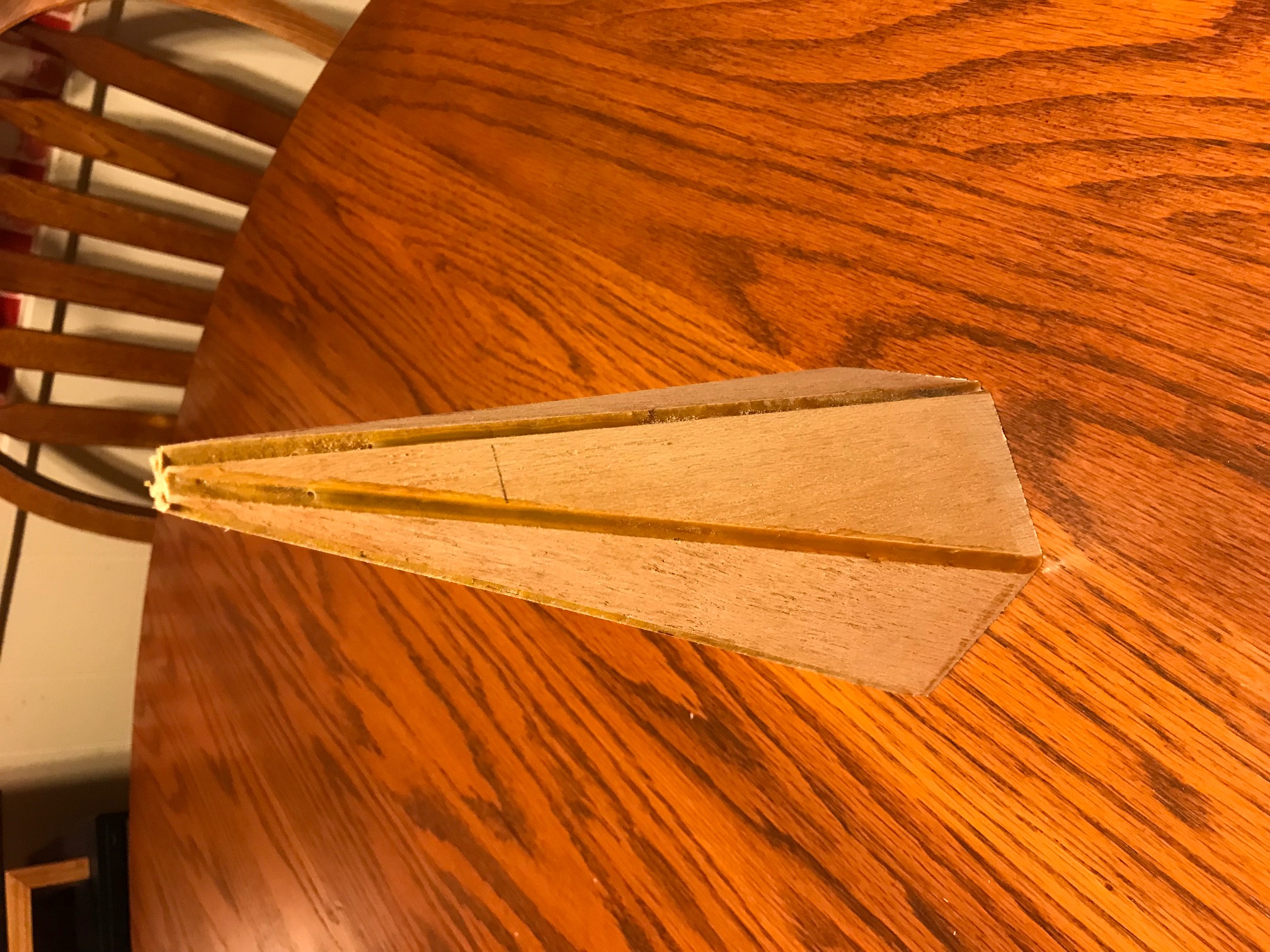

Is this dagger big enough for TC9FD? 9" tall and 4 1/4" at widest point. Picked up RS225-8 for a good price locally on Facebook Marketplace and already have TC9FD. XO parts on order. Would love to build TL but with a bad back all I can schlep around is the sealed monitor. Making sawdust tomorrow. Thanks.
As long as the driver magnet and basket fit with some clearance for breathing space. As I recall, TC9FD is 3.5in dia cutout. So should be good.
If you build the XPS foam TL, it will weigh about as much as the drivers plus a couple pounds. 🙂
