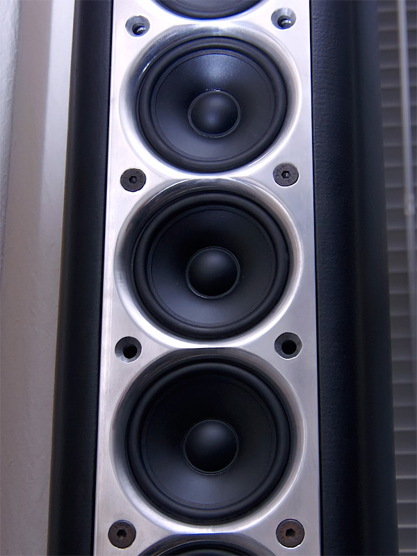

1/ Don't see any baffle edge roundover on peoples cabinets - is there a reason for this ?

The round overs would need to be significantly large radius to have an audible and measurable effect (2in radius). That would really change the front baffle look. As the crossover was developed for a non rounded baffle, the XO might also change if one put extreme round overs in the design.

Thanks for responses XRK.
Since looking at woofer dimensions, I'm guessing any significant rounding would require a wider box.

Thanks, xrk. Given the relatively low efficiency, and most of the power will be going to drive the woofer, couldn't one use a small class A for the tweeter and a more powerful amp for the 8 incher?

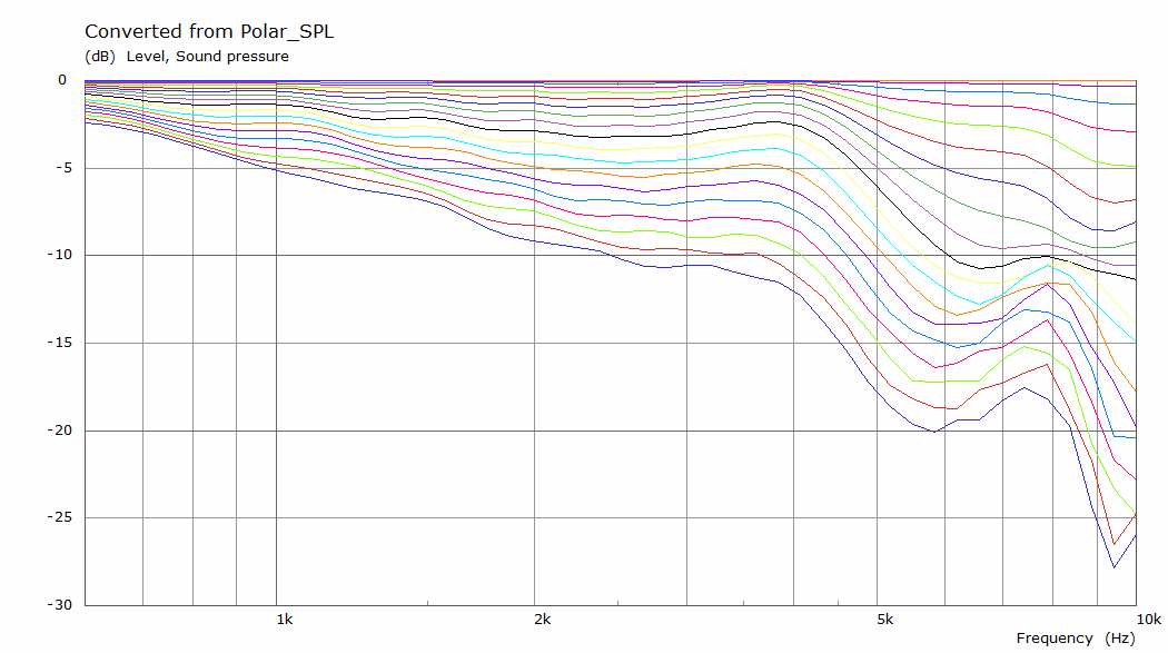

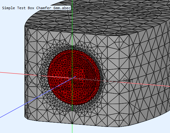

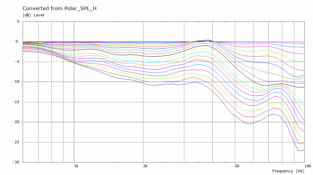

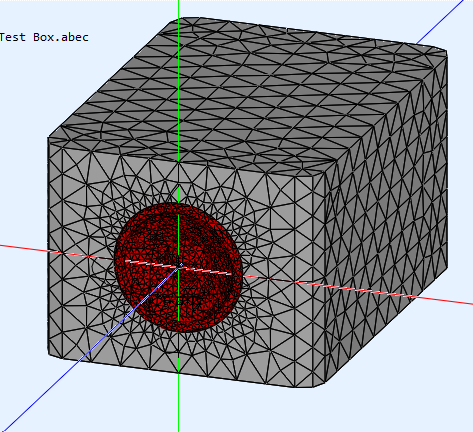

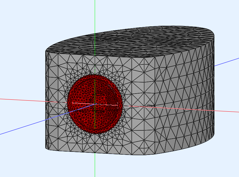

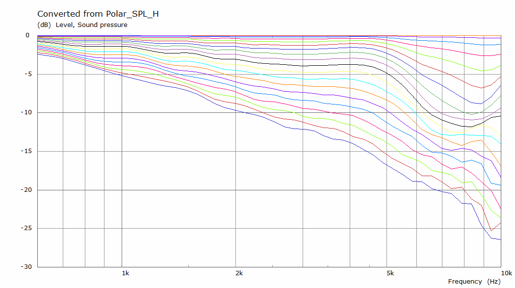

A while ago member fluid ran sims for a driver in a flat baffle and the same driver with a rounded enclosure:
The relatively flat baffle:
Versus the rounded enclosure:
I'd say it is easy to spot differences. The first round-over used on that enclosure shape is only 25.5mm or about 1" radius. Yet the effect it has is quite obvious.
Taking this concept a step further, with the driver set back in the baffle with a small chamfer in front of the driver:
I'd say it's well worth it to try or play with things like that. Even if it means it needs a crossover adjustment to work it all out. 🙂
That’s a very nice result but seems more of it is from fact that driver is in a waveguide?

I'd agree that the (very short) waveguide is responsible for the majority of the positive change.
