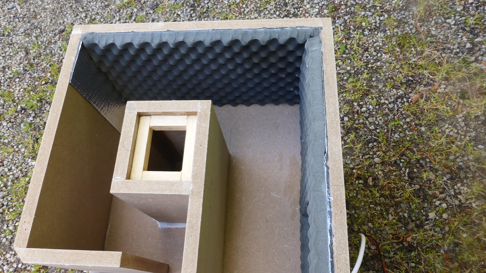

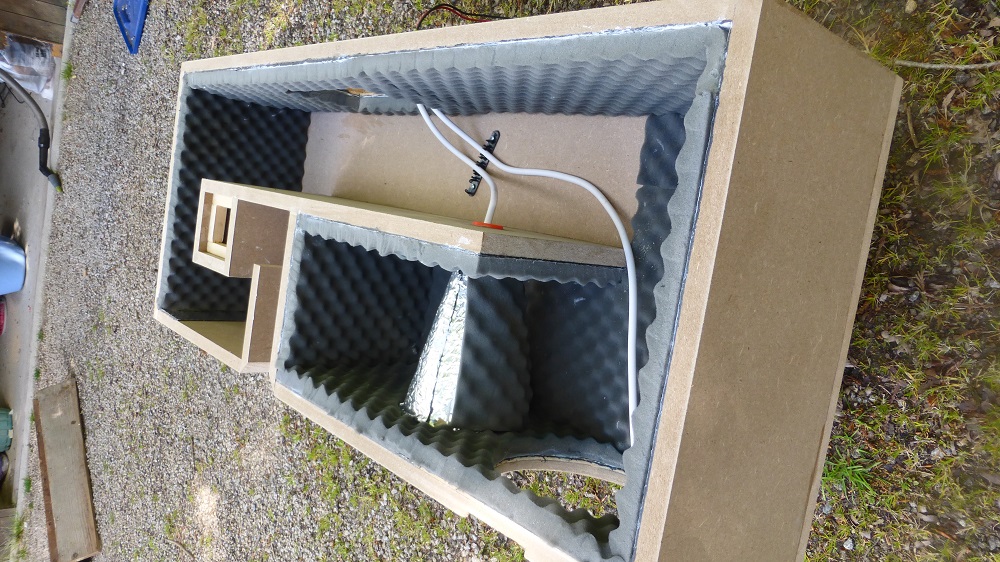

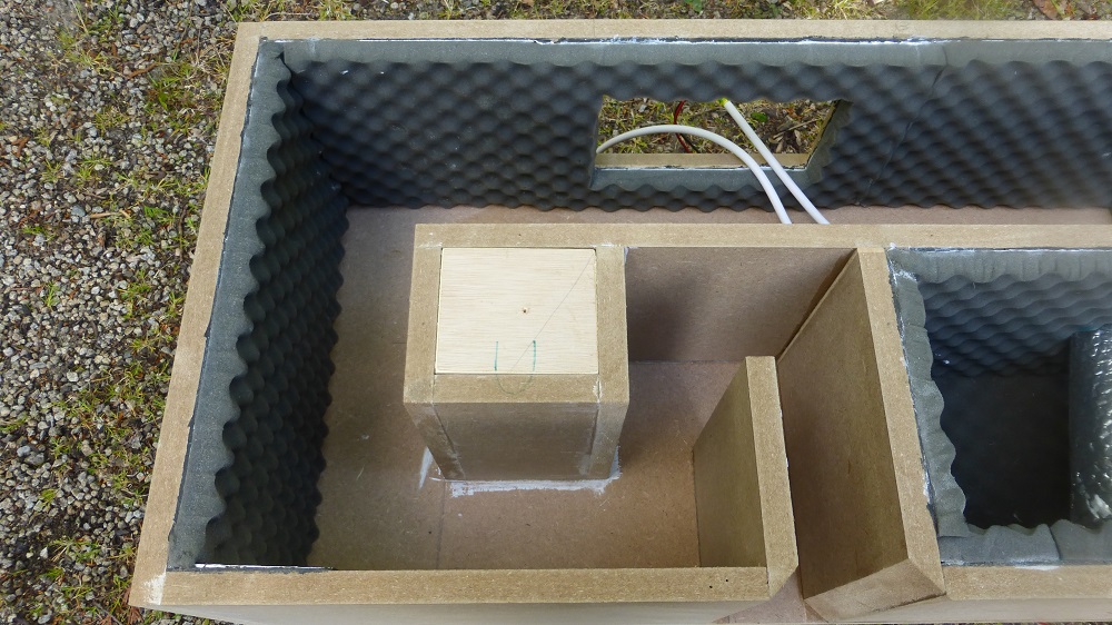

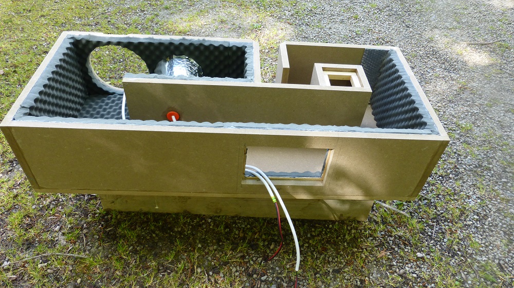

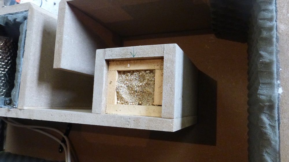

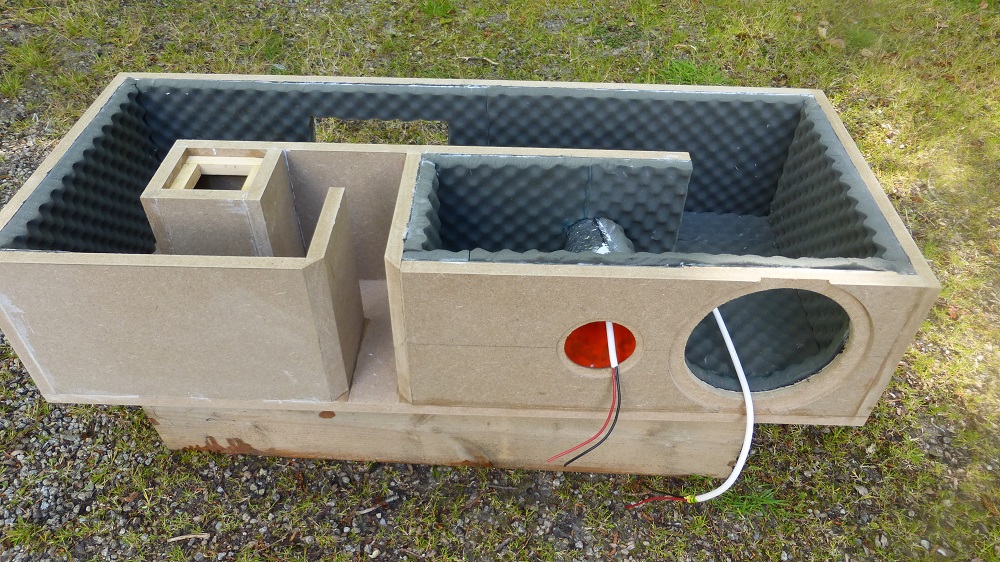

Hi, some new photos. I hope it's good. I put maybe too much Noico for compensate the 18mm mdf instead 22mm plywood. I put dry sand in the hole to give more weight too and now it's begin too feel very solid !!
i'll probably close the box tomorrow 🙂
then sanding and painting (it can be long ...) .
Thank you all for your advise and support from the beginning .

Moutik,
Your TL’s are coming out fantastic! I like your use of the hollow cavity.
I put bags of lead shot in my foam-core TL proto’s 😉
Thank you Vunce!! Bags of lead is a great idea!!the wood cover is used tu put more glue when i'll close the back panel. I'll try to make a white white gloss paint on it, i think they deserve the best finition i can do.
Very neat work, Moutik! I like how nicely trimmed your egg crate foam liner is. I bet these are heavy cabinets in MDF. But that gives them great stability for better bass and more precise imaging. No spiked feet needed. 🙂

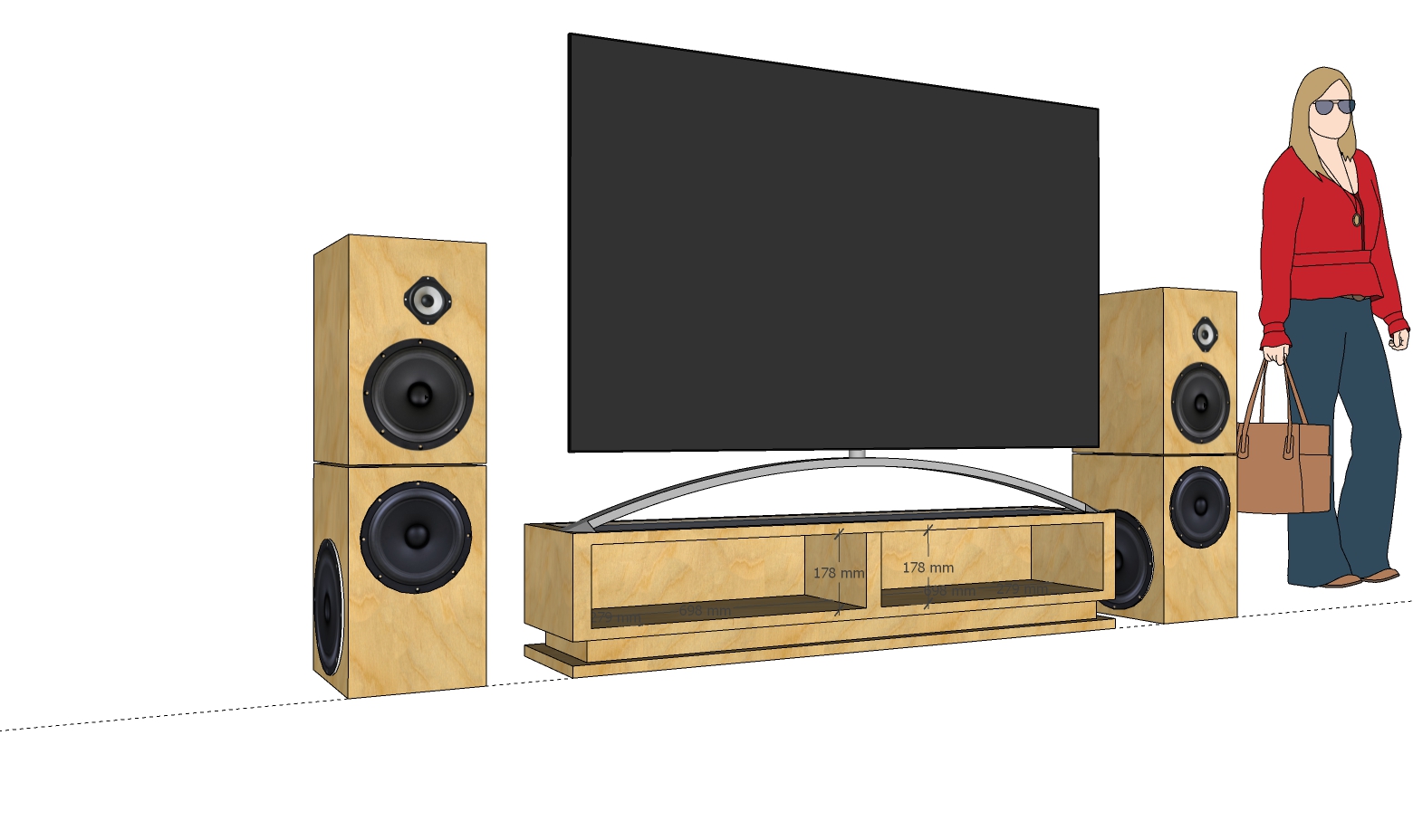

Hi guys, I want to ask for an advice on the low end.
I'm running a FAST with TG9FD10-04 and SB23NRXS45-8 in a sealed box (full specs here). Happy as a clam and with no shortage of lows due to convenient room mode between brick walls.
Now the problem is that we're moving to a new place and the speakers will be placed far from walls (which are wood/plaster rather than brick), so no bass boost for me, effectively limiting the useful output to 80Hz or so.

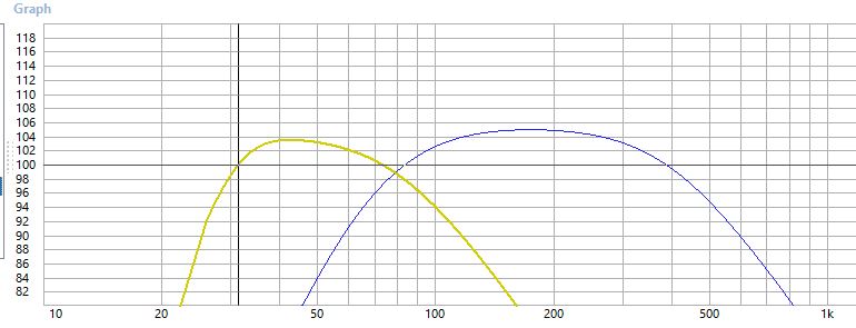

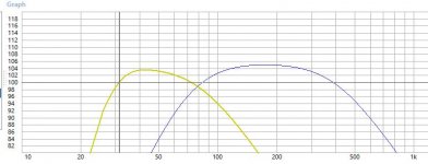

All this leads me to some sort of subwoofer solution. So far I've considered a conventional cube shaped sub but the aesthetics committee isn't fond of the idea. The other option is to add two boxes beneath the speakers that would double as stands, effectively creating floorstanders. I've modeled some very nice responses from 8" drivers (SB23MFCL45-4) in 25-30l boxes with two opposing 10" PRs. Should hit 30hz at 100dB just fine (attached) and would visually blend in with existing speakers well.
From your experience, am I on the right path and do you have any tips on where to cross sub with a FAST/WAW? 60Hz? 100Hz? Harsch or a conventional LR24 would do? I still have 2 unused channels on DCX2496 so almost any topology can be realized.

Hi Wxn,
Sounds like a neat solution and with DSP, you can make it work I think. 80Hz is low enough to not require localization of speaker and sub to be perfect. But as speaker stands it can’t get much better. XO is a good place to be. Should sound good.
Alternatively, make the TL version. No sub needed.

Thanks, TL version is not out of the question but I haven't built one and they always seemed very fiddly. Maybe.
Also I made a sketch of how I imagine those stands/subs, any thoughts?
This TL is not fiddly from the many successful builds we have. But design is for RS225-8, not SB23NRXS45-8.
