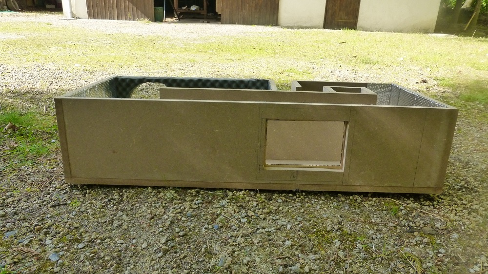

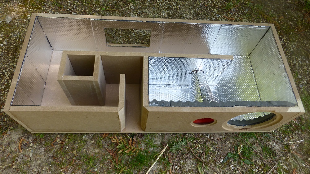

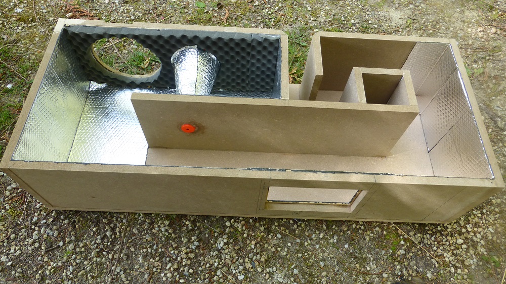

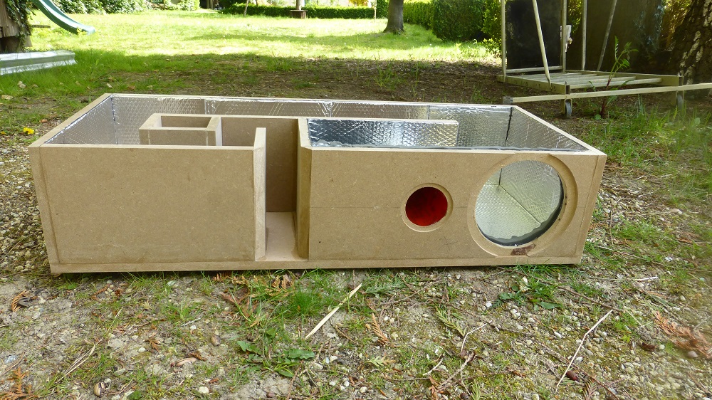

the cardboard whiskey bottle container also does it, though you need to break the mode of the standalone diameter with something else inside. Just if like me your hands are not good skilled enough.... That's what I use for my 10F with an orange caoutchouc ring for glass tins to isolate it from the front bafle... you still can put the foam inside to break the mode due to the less good more regular shape vs the dager.
Hello, do i glue the honeycomb foam all around the cone? i see you glue a piece of foam on the top.
bye !
bye !
Just a small piece in the half side of the cone facing the woofer. But honestly, probably doesn’t need it as a conical surface is already a poor reflector for sound back wave resonance. You used more Noico than needed - but that’s fine. You are making great progress. It will sound great.
