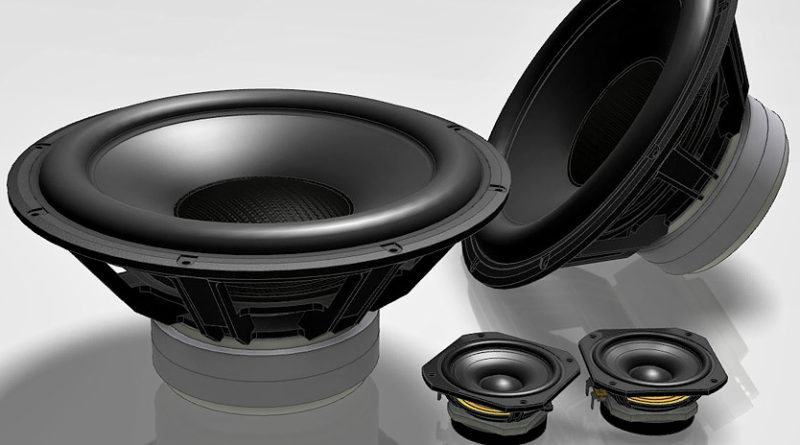

If you're on a reasonable budget, perhaps the Scan Speak 30W/4558T00 would be up for that task?
Though I do apply EQ for my sealed construction, a sort of Linkwitz Transform. I was inspired by the Thor subwoofer,
but build the enclosure to a specific size. This is a driver similar to the Peerless XXLS, but often overlooked.

Thanks, I shall read on it, looks promising. Good to read, about your setup again.
