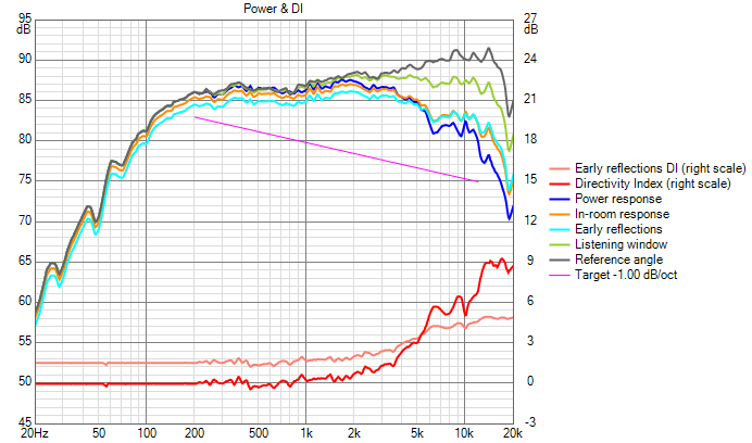

Not sure what you mean Byrtt but I have always been about measuring and posting data. You are right that it is only “perfect” at one point, but I would say that being not at that point is still very forgiving and the sound of percussive instruments will still be clearer and more crisp than a LR2 or LR4 since their step response is a total mess of ups and downs.
Maybe it is not up to your Spinorama standards - but personally, I find that too complex to wrap my head around. It’s just too much data and I am not sure it will tell me more than what I need to know when voicing a crossover.
Frequency and Phase:
Step Response:
Crossover Curve:
Call me old fashioned but I can’t understand what this is telling me, and why it’s important:

Is this Ref Monitor meant to be listened to on axis? Or would there be toe-in for the best possible results. The reason I ask is because if I look at a single TC9, shaved flat with DSP, the results look way better when I choose a listening/design axis of ~10 degree, something that I would do (and in fact do with my arrays) with a speaker like this. If the TC9 can do this, the 10F should be able to have similar performance, only the crossover between it and the woofer could hold back the results.
- Shoot -, I forgot you listen to it under an angle already as the speaker is turned upside down, with the 10F under the listening/design axis. 🙁
However if I look at that graph shown, I don't think it shows that "under axis" placement of the 10F in it. It would certainly be an advantage to (be able to) show what it can do i.m.h.o.

What a graph like this depicts is that indirect sound from reflection/diffraction in the room has a similar sound signature as the direct listening axis sound. The above graphs come close to some of the top rated spinorama speakers from the research done by Harman, see a rather complete list here: Preference Ratings & Graphs
However, we as DIY folks have an advantage that we can tailor our room to our speakers and don't have to create results that would work almost everywhere.
I'd have to agree with BYRTT up to a point that the word "perfect" in 'transient perfect' might be a bit much for a speaker if it can't truly back it up with the needed performance to really earn that name. Probably a sentence chosen in enthusiasm due to the design-axis results, but maybe not quite fitting? I have no problem with calling it a REF speaker, as it probably is your reference 🙂. I won't call my speakers transient perfect, although I probably come close after correction. 😉 I do aspire to it.
