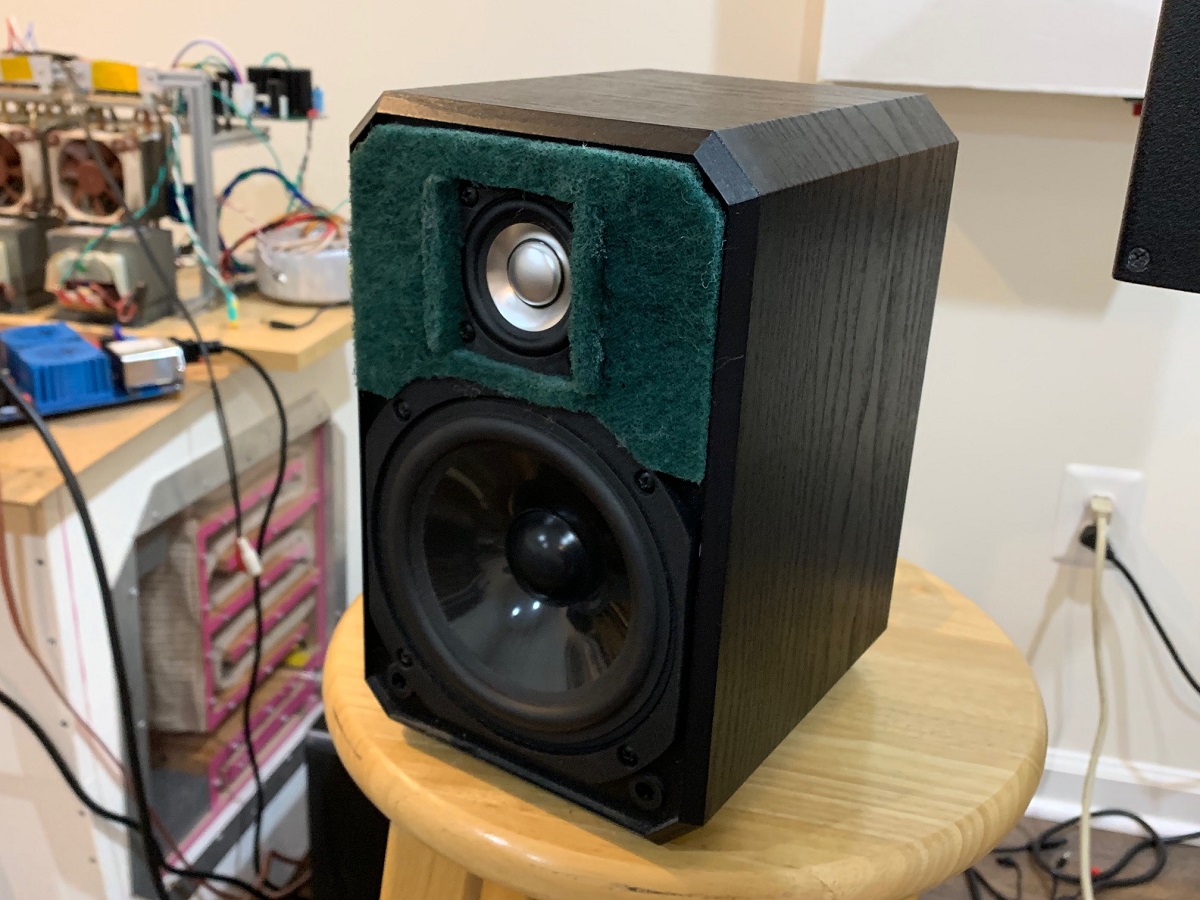

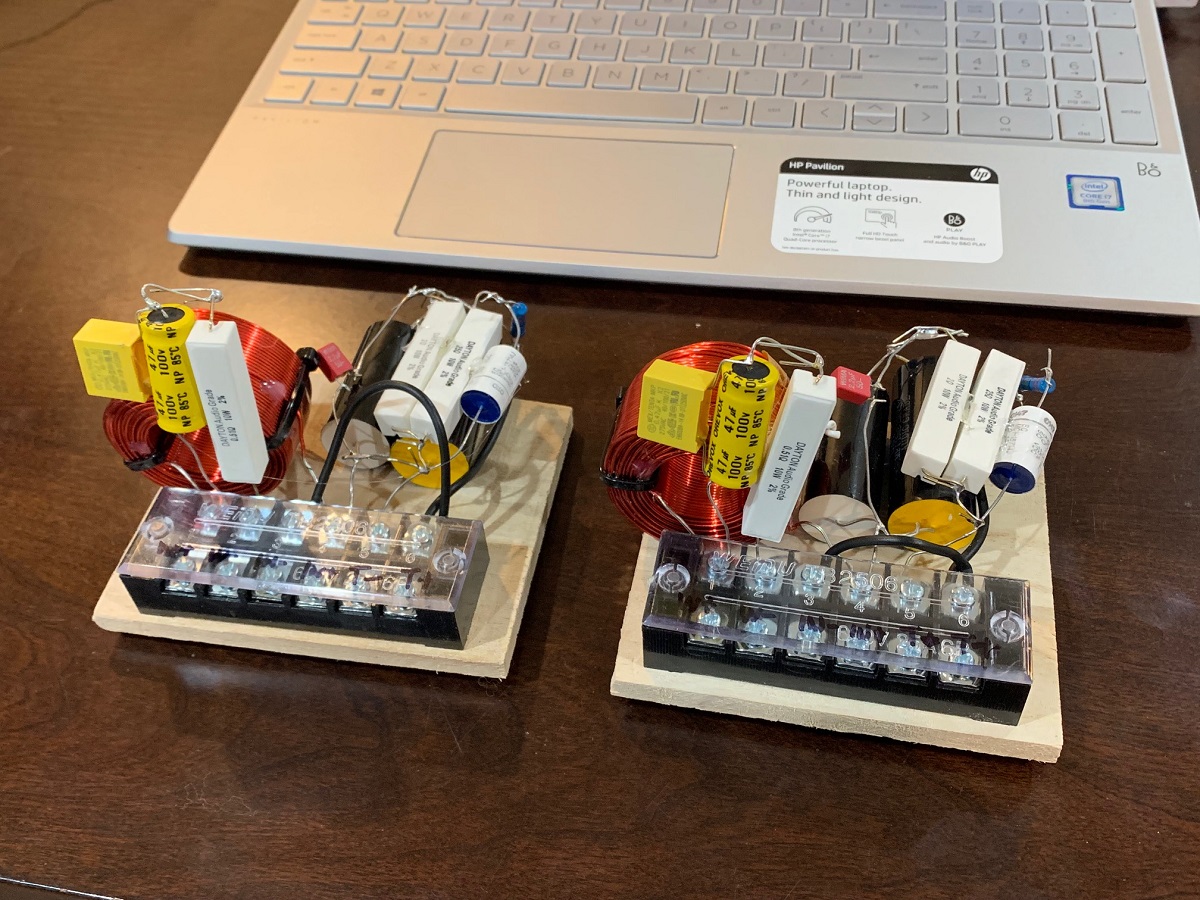

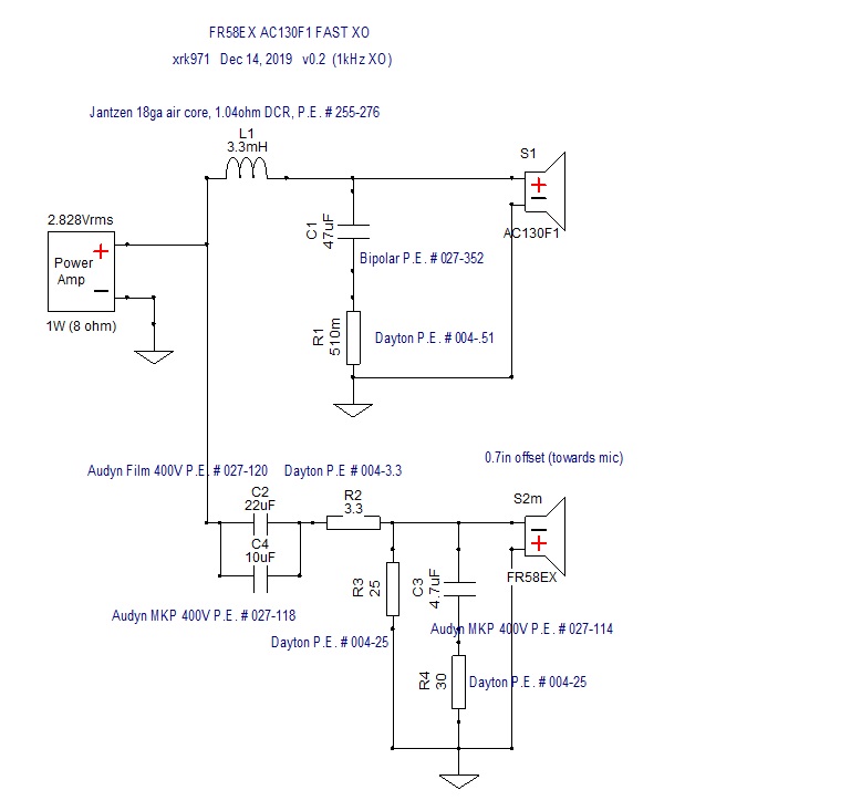

Try this: FR58EX and AC130F1 in 5L cabinet
FR58EX and AC130F1 micro-FAST / WAW

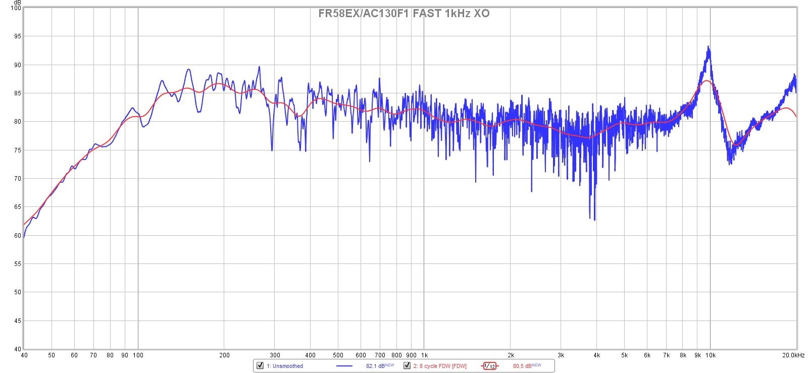

If you use DSP and active 1st order XO, results look like this:
Step function:
Later generation FR58EX seems to have picked up a bad breakup at 10kHz:
