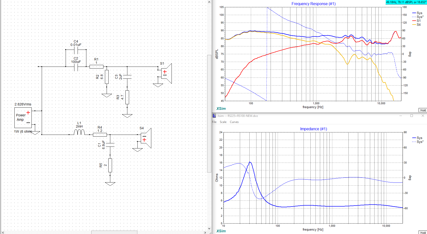

I then asked about something I read about a notch filter mentioned in one of the crossover posts, about alternate speakers (as the full range speaker specified was a bit rich for my wallet) and where one usually mounts the crossover.
He replied:
No notch to worry about - the listening height is the woofer axis not the 10F.
Almost any 2.5in to 3.5in 8ohm full range driver can be used. Adjust the resistor to match sensitivity. Examples that work well: TC9FD, TG9FD, 3FE25, 3FE22, RS100-8, PS95-8, B80, FR58EX, FR88EX, Tang Band W3-xxxx, Peerless 83xxxx 3.5in full range, etc. the star is the woofer RS225-8. You must use that woofer with the crossover.
I make front baffle removable so crossover is accessible. On TL I mount on removable back wall. Use the schematic from &/‘ 11, 2008 for the XO. It has the notch already.
I then asked about interference between the drivers and where the interference line (not sure of the proper term) due to listening height difference between the ears and the speakers, and about tuning the crossover network for the other speakers.
He replied:
You won’t notice the bulk at the usual listening distances of 2m or more away from speaker. Being a transient perfect but non coaxial design, try to have the ear at about the woofer axis. Whether you tilt the speaker or change your seat height is ok. However, at usual listening distances of 2m or more, it doesn’t matter as much as the 3in time of flight difference between the woofer and fullrange becomes less and less important the farther you are away. Don’t worry about in other words. It will sound great. I am sitting 7 ft away and 15in above woofer axis and it still sounds great.
For any other full range, if 8ohms just adjust the two resistors R1 and R2 to balance the level. The design is nominally for 87dB at 2.83v ScanSpeak 10F. It’s a 4.7R/4.7R divider. For less sensitive 85dB driver use 2.2R/6.8R for R1/R2 - and adjust R1 in 0.5ohm increments by adding series or parallel resistance until it sounds good to you. For 82dB sensitive driver like SB65WBAC25-4 then use straight wire for R1 and leave off R2 for max sensitivity to match woofer (82.4dB at 2.83v after baffle step loss). Baffle step loss is the loss of bass SPL below the baffle step frequency (determined by width of baffle) and about 900Hz for this speaker. A wall mounted speaker has infinite baffle so no loss (they have 6dB more bass than free standing speaker).

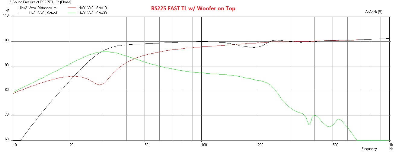

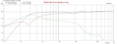

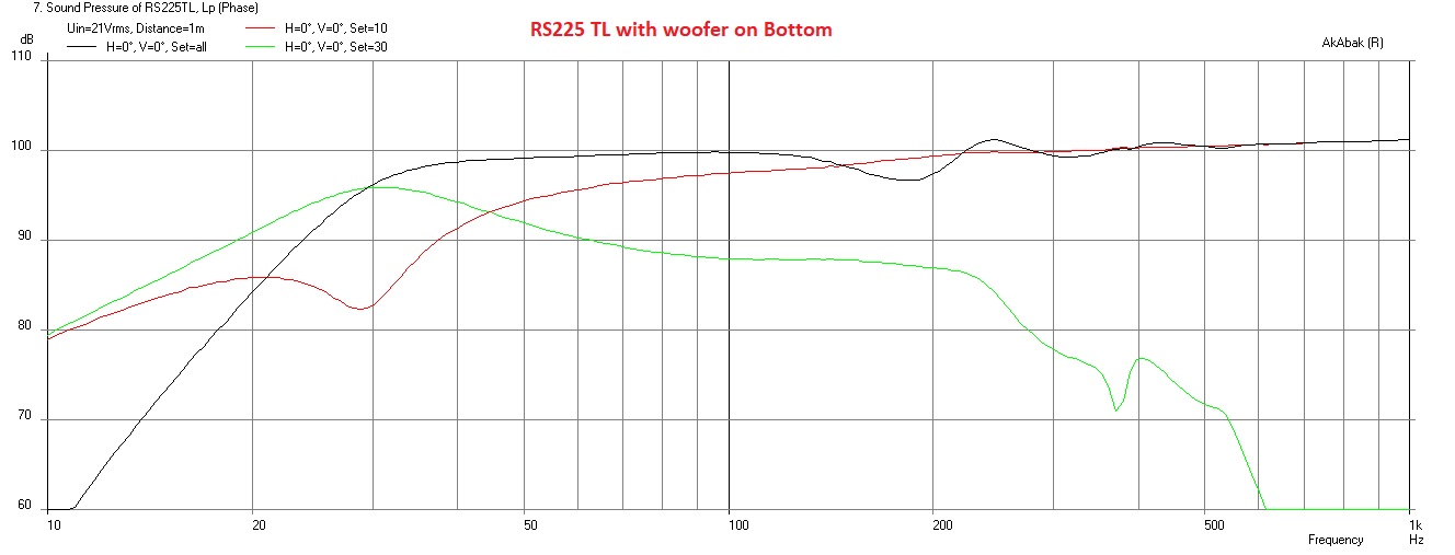

In reviewing all that information, I do have an additional question that might change things a little, and that is the possibility of turning the entirety of the TL box upside-down, placing the speaker-half of the box on the bottom. With a floor-standing speaker, having the drivers that close to the floor would cause problems, but mine will be sitting on a 24" table (at the front edge of it, as the tables are only 18" deep).
Note: in reversing the drivers, I simply put them in the other's position. With the smaller driver closest to the top, it could be moved much closer to the top edge, as there is plenty of room. I have no idea what that does to the balance of the sound for the larger speaker, though. Perhaps xrk971, after running the sim with the speaker positions reversed, can fill us in on the best placement for the inverted pair.
Code:
Distance above floor: large spkr small spkr
speakers in normal positions 34" 26.5" * on floor
speakers in normal positions 58" 50.5" * on 24" table
speakers positions reversed 50.5" 58" * on 24" table
speakers in normal positions 30" 37.5" * on 24" table, box upside-down
speakers positions reversed 37.5" 30" * on 24" table, box upside-down

How does one "tune" a crossover for a full-range that has a different sensitivity?
In my mind, the obvious thing to do is listed below, but I have no idea how safe it is to do, or if having one speaker out of the circuit will impact the way the XO behaves...
The steps to I would take:
- disconnect smaller speaker (so we get a measurement from the woofer)
- play a sine wave at XO freq
- measure SPL (this becomes our target SPL for the full-range driver)
- turn sound off ( )
- reconnect smaller speaker
- disconnect the larger speaker
- play sine wave at XO freq
- measure SPL
- tune resistors until SPL matches the woofer
Does that make sense?
Is there a reason not to do it that way?
Is there a better way?
Is this way safe?

Simply change the attenuation resistor R1 up or down (to taste) until sound is balanced in bass and treble. It will sound either too bright and not enough bass, or too much bass and no sparkle. Values range from 0R to 10R. Go in 2 ohm or 1 ohm increments. You can also measure with a mic and REW software.

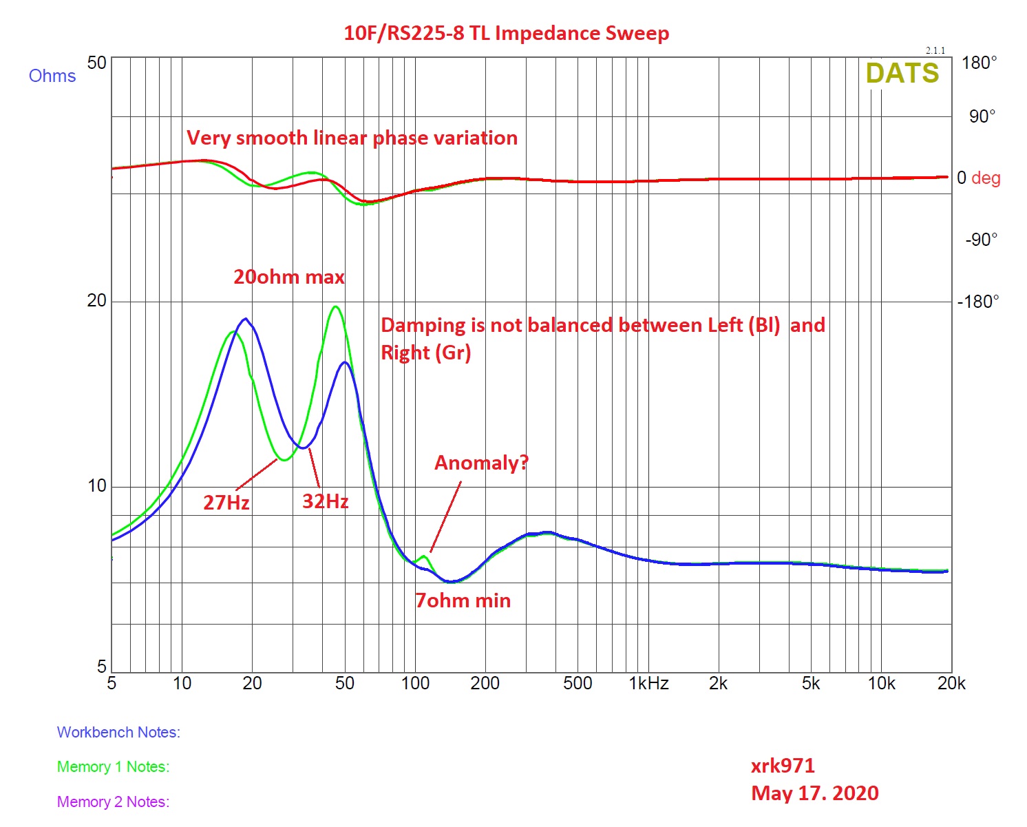

So I discovered that my TL had a bad seal in the back panel when I could feel small jets of air shooting out when playing some hip hop music real loud (circa 50wrms). This video shows conclusively using a candle you can detect air leaks. It turns out that the gasket used was a rather thin and firm white rubber and not the vinyl foam window weatherstrip stuff. I replaced the gasket with proper weatherstripping and the leak went away. Remeasured the impedance sweep and both speakers look like the right curve. The asymmetry went away and the impedance minimum is at the same 27Hz box frequency. What I thought was the anomaly on the right speaker also showed up now on the left speaker with the leak gone.
Both left and right now basically looks like the green curve:
So, large amounts of asymmetry in the two impedance peaks is an indication of an air leak.

My concern with the inversion of the speakers is that the "top" of the resonance chamber (the space presently below the large driver, folded from the logical 'top' location to a 'below' physical position) would be shortened below useful length, and the other part of the TL would be correspondingly longer. I don't know much about tuned resonance spaces and shapes for speakers, but it seemed to be important when I did see discussions of it.
- Am I reading too much into where the speaker is placed in the column that is the TL or could inverting the drivers mess with the ability to go low so nicely?

Your concerns about flipping the driver are valid. The short closed end is a “stub” designed to help cancel the reflection null at the TL exit. Typically we aim to put the driver at 20% to 33% of the way from the closed end to do this. But we won’t know how much it affects the response until we simulate it. Have not done that yet but it’s easy to do just need 10min. Bracing is always important if you have a span of wood more than 8in free. But it may not matter if you never play loud which is when pressure builds up. Regarding 4 ohms and 8ohms - I can only tell you what I have simulated as a crossover. If there is a simulation of a 4ohm woofer and 8ohm full range then the predicted impedance plot is what the amp sees. In general, this 1st order crossover is very benign. For the 8ohm it is 7ohms low for 20ohms high and smooth phase variations. I forget what the 4ohm looks like. I have the Miflex hot melted and zip tied now in the final xo on the TL. A member simulated a PS95-8 and RS225-4 with the same type of XO and got low of 4ohms and high peak of 16ohms. Very benign if your amp can handle 4ohms. Post 2252:
A member simulated a PS95-8 and RS225-4 with the same type of XO and got low of 4ohms and high peak of 16ohms. Very benign if your amp can handle 4ohms. Post 2252 (image deleted to save space)

An additional question - how does damping factor of the amp impact the sound of these speakers? Do they need a high damping factor to really make them sound their best, or are they really easy to drive and don’t need a lot of damping? You mentioned a Class A amp that sounded really good driving them, and I was wondering what the damping factor of that might be (for comparison). I ask because I will have two mono-block amps for each channel, but the damping factor will either be 5 or 20, depending on bridged vs parallel joining of the blocks. Any thoughts?
Oh, did you ever get a weight (even an estimate) on the speaker box weight? More or less than a big bag of water softener pellets? 8)
These sound great with a wide variety of amps because the impedance is relatively a flat 8ohms. The Alpha Nirvana is about a damping factor of 50 I think (at bass freq). I have used it with a Class AB and Class D. All good. Bass with FH9HVX or TPA3255 is about the same. What you need though is power. At least 50w and preferably 75w to 100w.

Effect of mounting woofer on top vs bottom
Here are the simulations of the RS225 TL with simply the positions of the woofer swapped with the full range (a 7in difference about). With the woofer on the bottom, the dip at 180Hz is great by about 1.5dB. Probably no big deal as this region is full of floor bounce dips and room reflections anyway. The sims are at 21Vrms. The location of the dip doesn't change with power. There is also more higher bandwidth stuff from the port output - but I don't think that is a problem.
Default top position:
Bottom position:
Bottom position:
