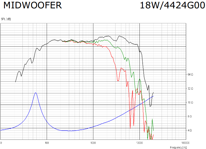

This speaker is not light for a speaker of this size, actually it is quite heavy; moving mass is more than twice the moving mass of for example a Scanspeak 18W/4424 which has the same Sd (26 gr. vs 11 gr.) .
So it is mass loaded for treble, roll-off by nature.
Like any other cone of comparable material and construction, it does break up, though in a very controlled way.
When reading their philosophy you will understand why they do it this way.
Yes, and the 4424 barely goes to 2kHz and has a big breakup mode at 4kHz despite having a lower mms.
18W/4424
Really?
Breakup mode around 4 kHz is actually some 2 db....
This is very benign behaviour as can be expected from a non-stiff cone.
For real severe breakup modes you'd have to check aluminum or ceramic cones.

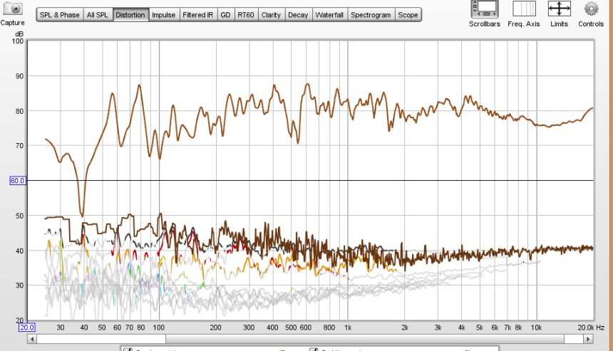

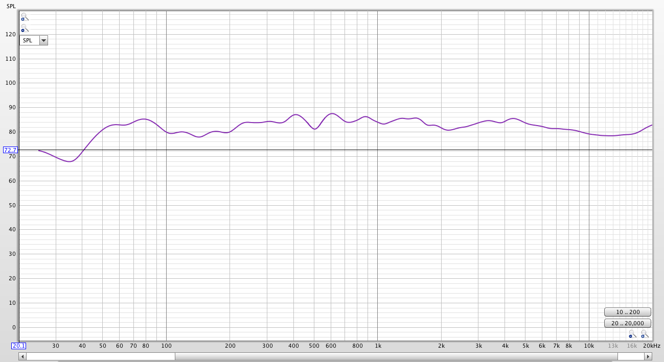

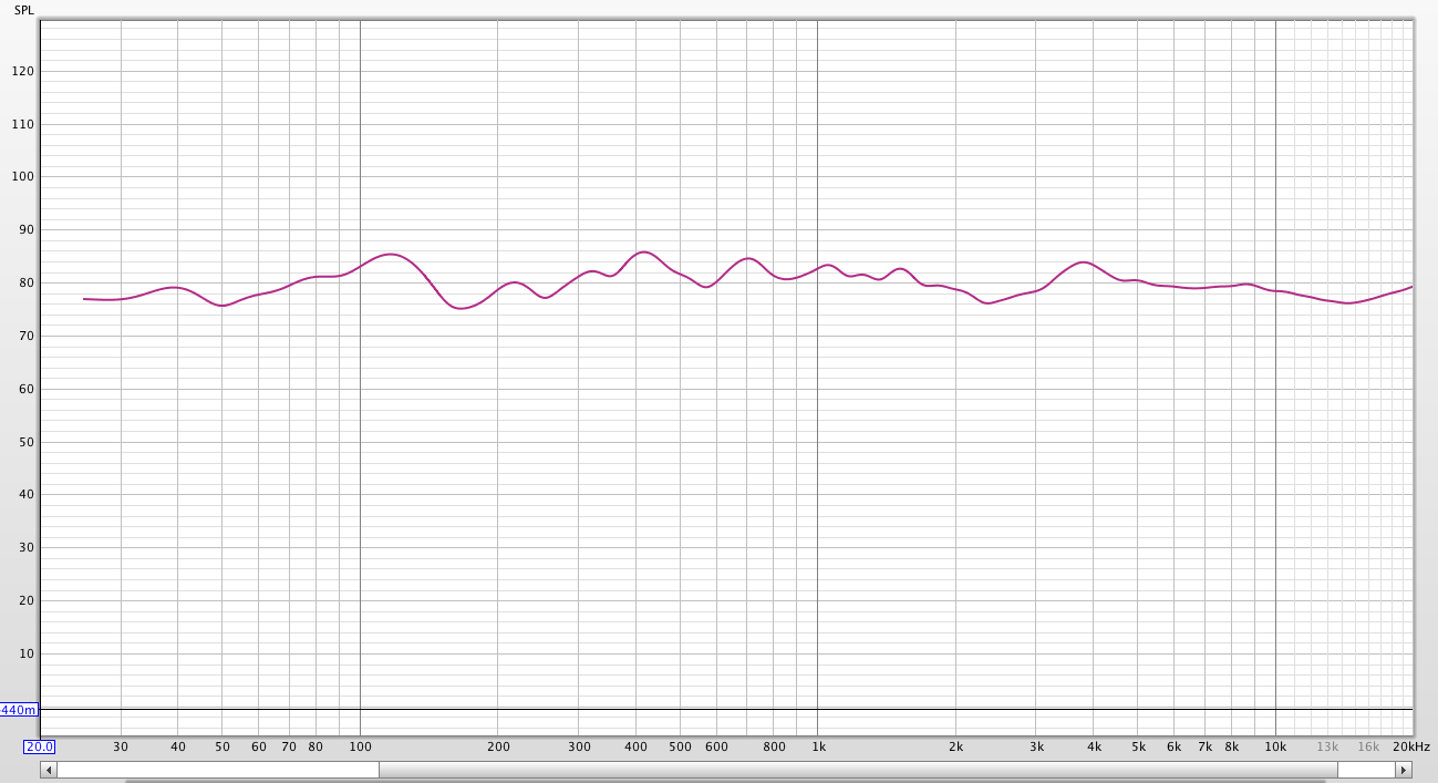

FR at 1m, FR at 2.5m (listening position) to account for the port and room gain, impulse and step, and finally distortion.

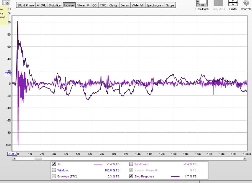

Nice work, Perceval. Do you have a measured crossover plot? How is the phase and step response behaving? This is a 1st order or Harsch XO?
Step and impulse on the 3rd graph.
This is the woofer running free and only a cap on the tweeter, in phase.
It was just for fun,but surprised me.
