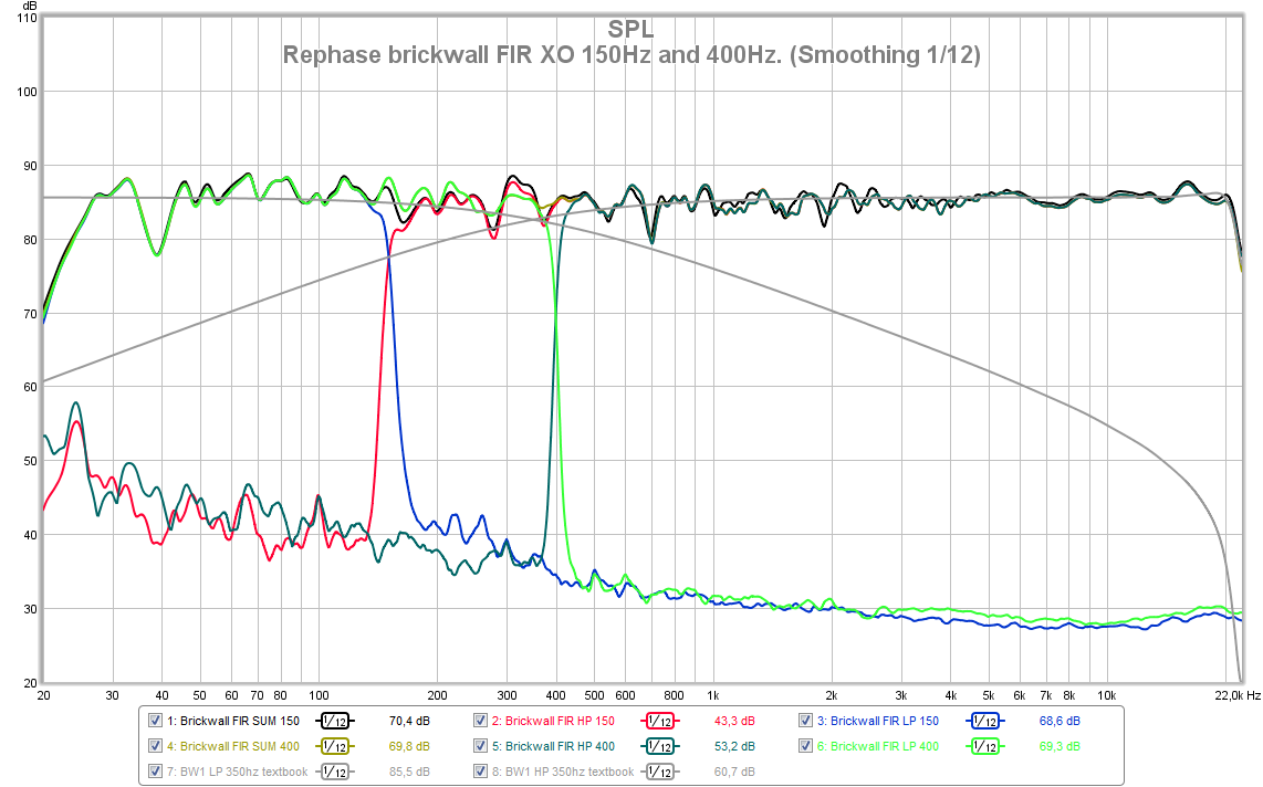

Thanks sound clip will listen tomorrow. In Rephase have made some FIR XO IR-wav files and can upload them if interested. Because i think the BW1 XO transients response sound so good i thought this should give as good a flat phase and could get steeper slopes at the cost of CPU time. Will share more data tomorrow if there is interest. Tried few different ones but fell in love these brick wall steep ones and especially the 150Hz one is good for full ranger lovers in that from my experience so far it preserves all the signature of the full ranger keeping the woofer at little influence into higher frequency area. BW1 textbook slopes at 350Hz is added as to compare 🙂.

Is that data measured with a mic? Very cool - I can't imagine what it sounds like to hand over sound from one driver to the next without overlap - would that sound kind of harsh? There would be ringing in the FR due to the steep wall? Very interesting - please post sound clips compare Butterworth 1 to brick wall. Both BW acronyms.
Wow! how did you do that? is that like a 1000db/octave filter?

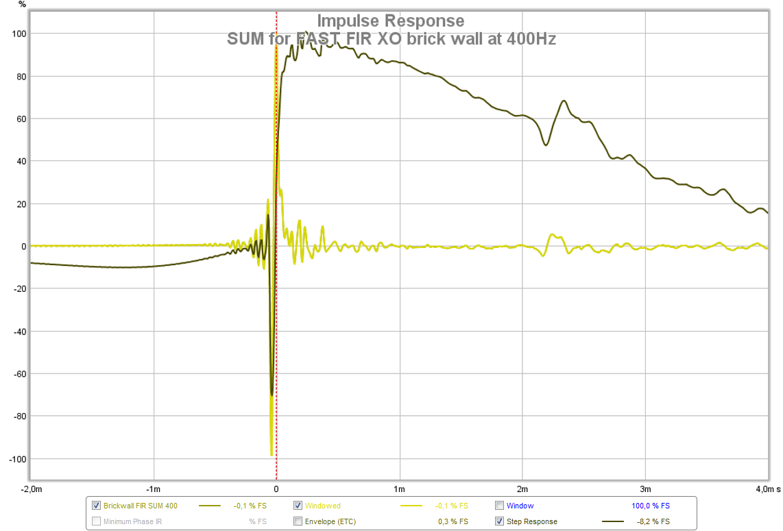

Good stuff BYRTT, does the steep slope bring extra pre-ringing in the IR?
xrk971,
Yes both XO points is the same FAST system measured and overlayed and could look like a three way system sorry : ). It rings when measuring LF or HF alone but when summed it looks fine. It does't sound harsh at all, and at IRR domain have by EQ corrected linear overlap before choose the XO points else think the ringing gets annoying and unsymmetrical for pre and post ringing as i understand. And no other FIR tricks is used its still a minimum phase speaker as it was one driver because the invinsible XO phase shift.

You joined just as i had to post 🙂, sorry i can't hang on more this night but answer that i tried carefull get linear in IRR domain to get best symmetry in pre and post ringing.

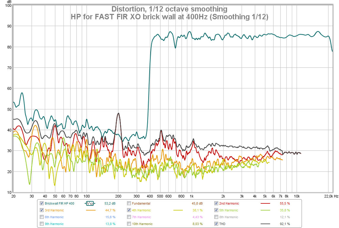

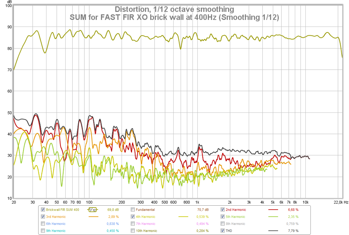

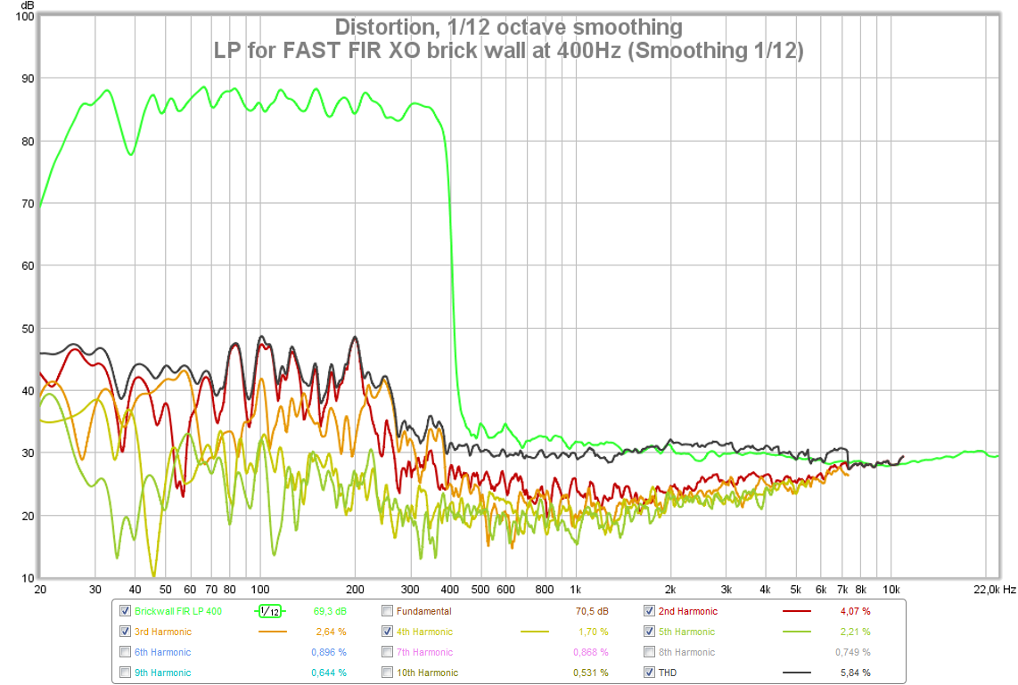

EDIT okay i post IR and SR for sum 400Hz XO and HD. And it shoul be said it is nearly as same standard as the BW1 (post 63 http://www.diyaudio.com/forums/full...4-rs225-8-fast-ref-monitor-7.html#post4310944) because no treatment here, i measure speaker sitting in a bookcase up agaist a wall because i haven't else where to put it and therefor the reflections.
