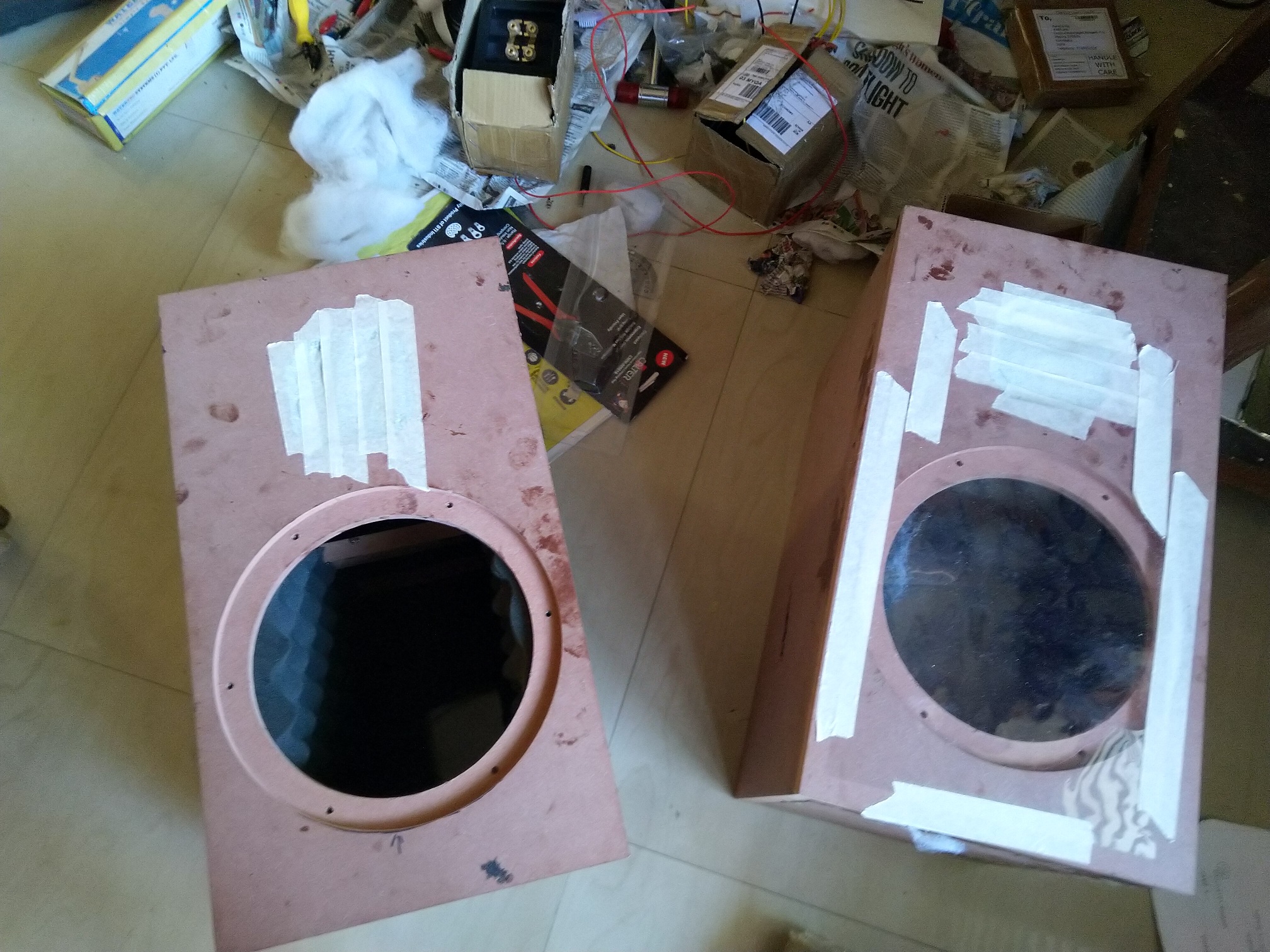

So my long running build is nearing completion.Or so i like to think 😀.
Im running the TC9FD18-08 for the full range,and powered by a Gmarsh Wiener TPA3118 amp.Its all the power I need to listen at comfortable volumes.I also did manage to put together The Papa's Korg B1,so am using it as a pre amp .
Many thanks to fellow member Sadik for giving me the flatpack and helping me achieve this build!
I still need to finish the cabinets and give them a final look.
All the interior walls are lined with butyl rubber sheets,including the exterior of the cone.Also,the interior of the cabinets have eggshell foam on all surfaces.For stuffing,I have used polyfill from pillows.The cone is stuffed progressively,though not heavily stuffed.Same for the main cabinet,though I have packed polyfill around the cone.Behind the woofer,I have lightly placed stuffing,not heavily packed.

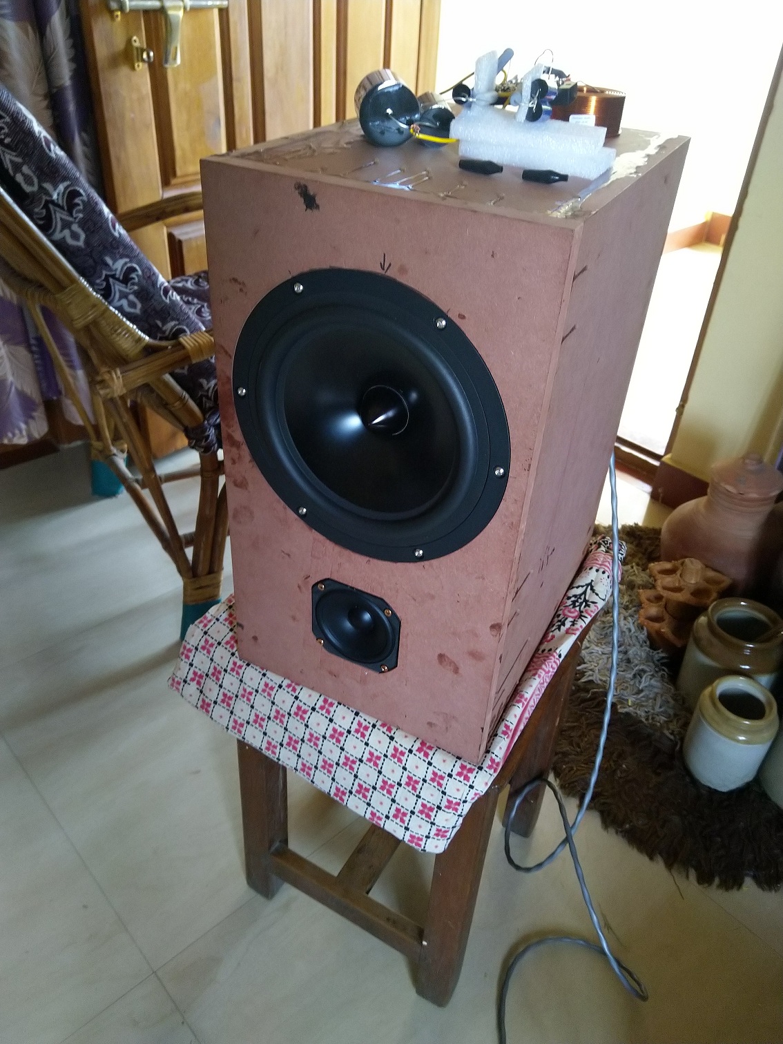

Listening impressions-I played some Indian classical music and it was great!Especially for male vocals.The played some instrumental music,mostly guitar and the RS-225 was really making its presence felt.
Then,I put some boom-tizz music (all instrumental video game sound tracks) and I felt the bass was too boomy. The mids and highs suppressed.

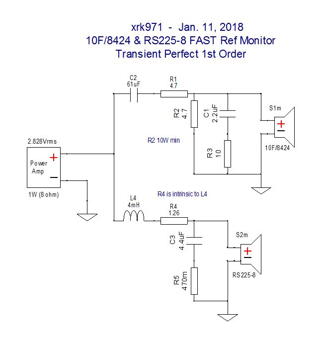

Now,the schematics are as given here,and as advised,I have tried reducing the value of R1 to 2.2 OHM,then 1.1 Ohm and finally removed R1 from the circuit totally.
I feel the Highs and mids are back after removing R1,but I still am not satisfied with what I'm hearing.Perhaps its a effect of listening too much with headphones on?maybe. The speakers are far away from any walls and I have removed the carpeting so I can do woodwork and glueing without messing things up too much.

I'm surprised that you would find a monitor size version of the FAST "boomy". I'm getting more bass than I want but it's the same setup on a wood transition line speaker. Everything you described seems fine.
Did you line the inside of the cone with an open cell foam. We used melamine sponges cut in half. Seems like a good thin lining on the inside of the cone would be important. Is the cone sealed good? These things don't seem like they would make it "boomy" but they are important. The woofer could be driving your full range a little and screwing it up if the cone isn't sealed.
Pay no attention to the pot position on your amp.
You can compare response changes with pink noise, REW/other apps, and any computer/phone mic, even w/o calibrated flat response you can see changes.

Woofer driving the full range.. I don't think so. Or atleast I hope it's not. I had checked the cones thoroughly before closing up the box.
Yes, I did read about lining the inside of the cone with melamine foam. But, that particular type of foam is not available locally so I need to search online for magic eraser.

Isn't the problem experienced the difference in sensitivity between a Scan Speak 10F and a Vifa/Peerless TC9? I'd expect the TC9 needs less padding down than the 10F.
That's what R1 & R2 do I assume. Let X shine his light on the subject, what needs to be changed for the TC9.
Try 2.2R for R1 and 10R for R2 with TC9. TC9 is 85dB and 10F is 87dB so you need less padding. You need to cut the TC9 by 3dB since bass is about 82.5db from RS225 after baffle step loss.

Xrk, the 4mh coil, does that give some baffle step ?
