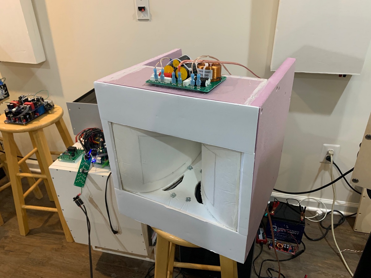

I am lazy and sometimes hot melt them to the board. Sitting flat not hanging in a wall though. On a development speaker that won’t go anywhere, the board sits on a wad of fiberglass, no screws or anything!

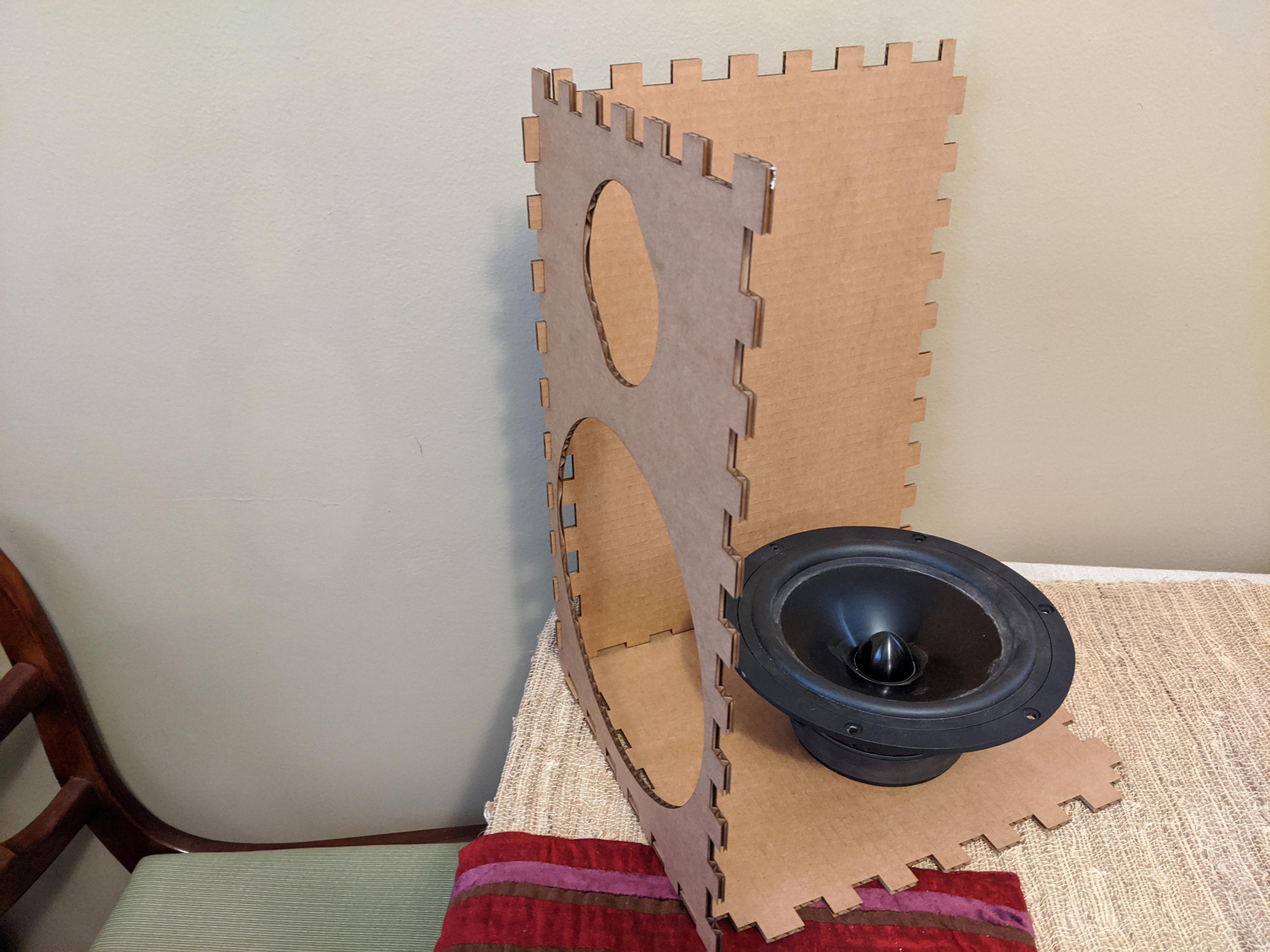

xrk, couple of dumb newbie questions.. for your coardboard prototypes, how do you glue the seperate panels together, do you use wood glue, superglue or something else? is it good to duct tape them into place while the glue dries? is there a type of screw or bolt that's best to mount the drivers into cardboard? I have socket head cap machine screws and t-nuts.. that probably won't work right?

Use hot melt glue. It sets in 30 seconds and you hold it in place by hand until it hardens. Glue the internal pieces to one side with hot melt. Then glue the remaining side with slower settings white PVA and a lot of books on top to clamp it down. Read the foam core thread for tips. I use drywall screws. Add corrugated cardboard on back of foam for screws to bite into. Don’t over tighten. For heavy drivers you need to add thin wood facing. 3/16in subfloor plywood is good.

Yep, making sure I have the driver cutouts correct and that laser kerf is correct for side fitment.

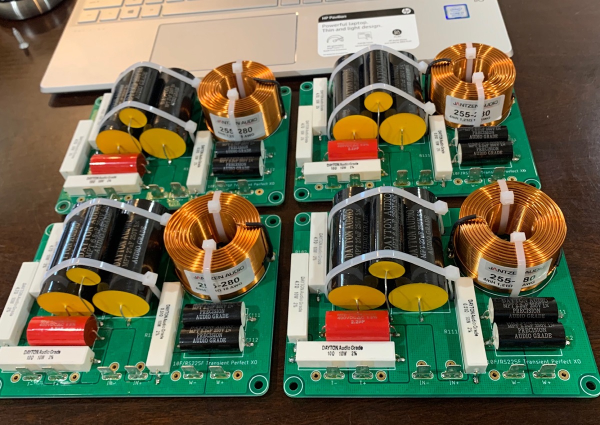

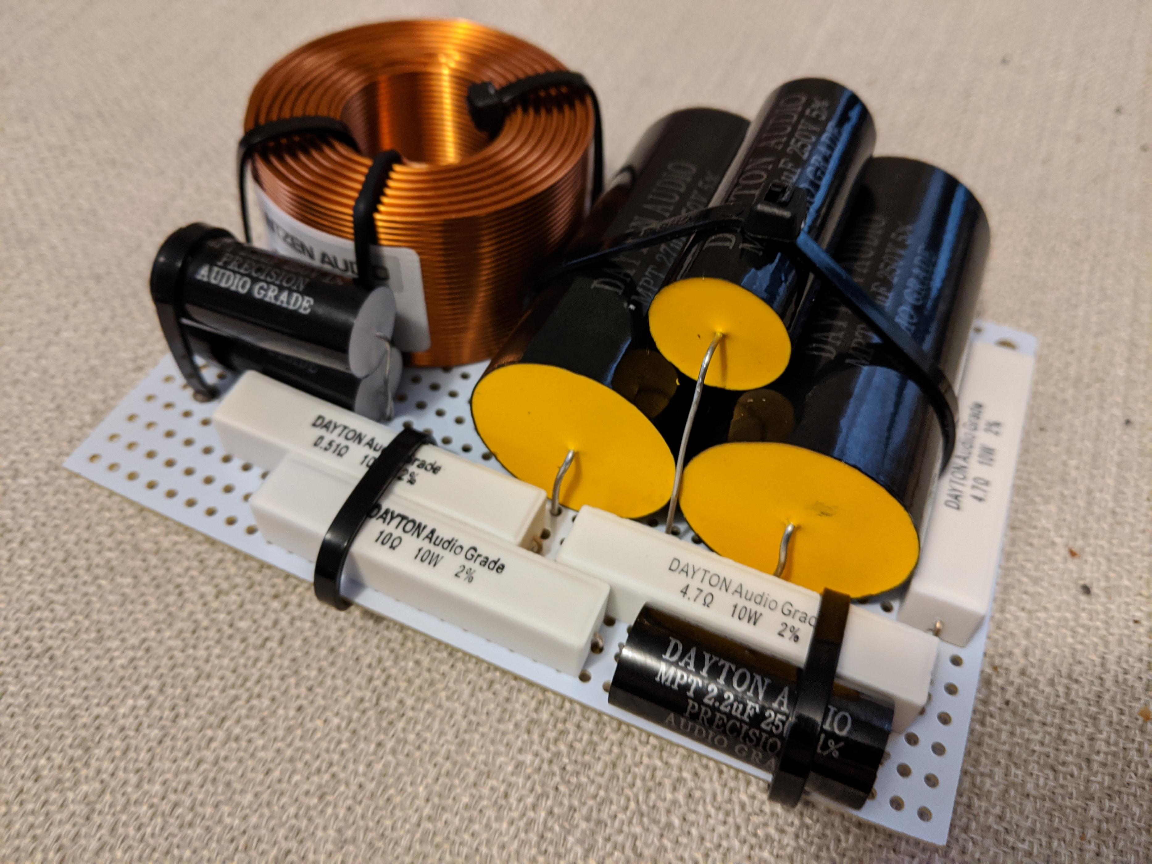

The XO's received their Faston tabs and subsequently tested with a 2-way FAST microTrynergy o make sure they work and make music. Then packed them up for shipment to Studiomic for installation into the TL cabinets. Hopefully this happens tomorrow and we may get first sound by Wednesday.
Testing with microTrynergy and Class A amp:
All four XO's tested and ready for shipping:

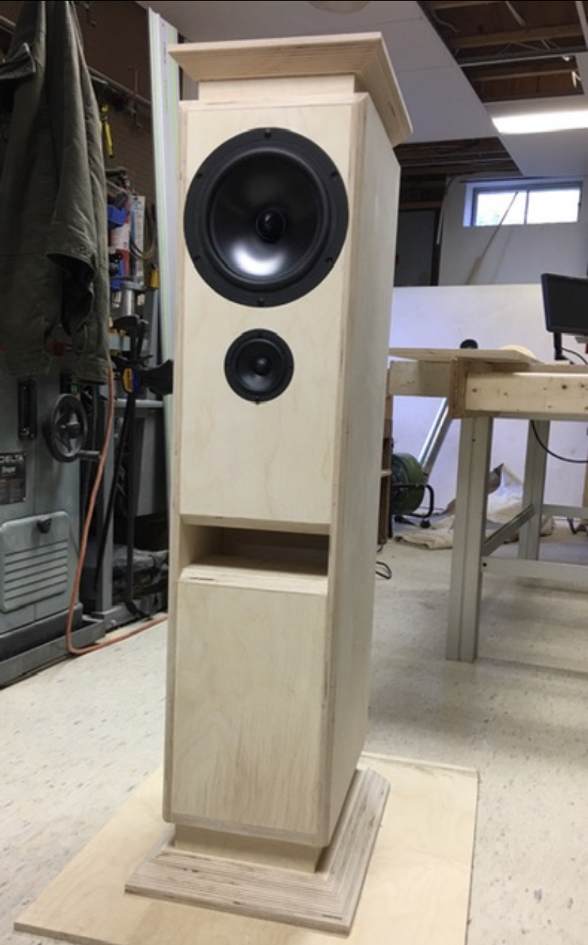

That's a shame about your birdhouse, but a little off topic. The prototype FAST TL wood speaker is playing after a long day working on it. I two mistakes: I let the binding posts both touch the foil on some butyl sound insulation and I used an expensive amp to test it. The result was that the speaker did not make sound and my very expensive amp made smoke and one of the tubes got bright orange. I'll ***** the damage in the morning and send some pics.

Nice work with the cross over.

It's a McGary Audio SA2 that I smoked up. I just got it three weeks ago. I know Mike McGary personally and I'm sure he will fix it for me but it's going to be an embarrassing and humbling conversation. An important lesson was learned: never test a new speaker build on a good amp! It only takes a minute to hook it up to a $25 amp and make sure there are no crossed wires or crossover issues.

Nice looking perf board crossover! Sounds like another 10F/RS225 FAST speaker is going to be playing soon.
