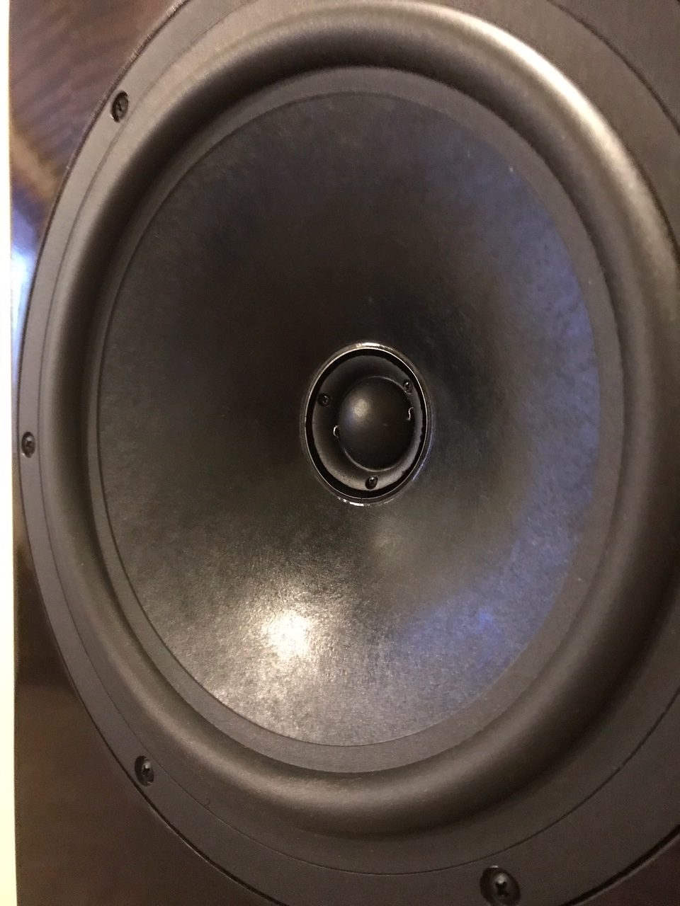

RS225 AMT Tweeter Mod
AMT Mini-8 Air Motion Transformer Tweeter
Here is a mock-up of the RS225 woofer with an AMT Tweeter taped to the phase plug. I believe it could also be attached farther back as to not block any sound waves from the woofer. I do like the idea of having it flush with the front of the speaker box like it would normally be mounted.
I found 6 dome tweeters that are small enough to place this way as well, but my choice would be this AMT. This is an easy modification and there are plenty of options for how to do it.
I just started exploring this idea and any advice would be welcome. Am I messing up the woofer by removing the phase plug? What are the best mounting options for timing & phase? Any other issues I should know about?
XRK - Is there an easy way to modify the XO to test this? Where would we cross-over at? How will this effect imaging and timing of the FAST TL.
I'm excited about this as possibility for a number of projects.
Just put a circa 1uF cap in series and maybe a resistor if needed to tame the level. Add that in parallel to the tweeter output of the XO. Just tape it to the box between the two drivers and see how you like it before performing surgery on the phase plug of the RS225. There is no guarantee this won’t mess up the incredible flat response of the speaker. It most likely will mess with it unless a full 3 way crossover is developed. But your ears may like the extra added “air”.
Thank you. I'm not positive this is something I want to do on the FAST TL but It's in my nature to always want more or different. I do not want to start from scratch on the XO or mess up the flat response. We will know if the bass is heavy after running some tests.
I will give the AMT a try next time I open the box or have another speaker to ready. I'll send some pics of the setup and my impressions of the AMT test.
I do think it could be a good idea to put a Tweeter in the center of the RS225 or RS227. I believe the RS227 could pair well with a Morel ET448 dome mid/tweeter. It would give you a "single source" with a wide range. It should be pretty flat if crossed at around 1000hz. Sorry, I'm off topic again.
