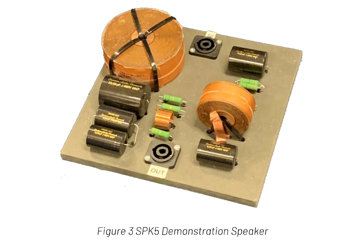

...Here is the Purifi 6.5 two-way reference XO, nice wax and copper foil air core inductors, but those green resistors look like metal thick film to me. Does anyone know if these are premium resistors, and what brand?
ALL crossover components are from Jantzen. Then:
Jantzen 5W Superes resistors | Hifi Collective
These are a high quality wire wound, ceramic core resistor rated at 5 watts. With a low noise specification and 1% tolerance they are a great resistor for crossover upgrades.
Characteristics:
1 % Tolerance
Low noise figure
Low inductance less than 0.7 uH
Instant overload capacity
Super heat dissipation, small linear temperature coefficient
Low annual shift
Flameprood and lightweight
Values available are 0.56R to 33R.

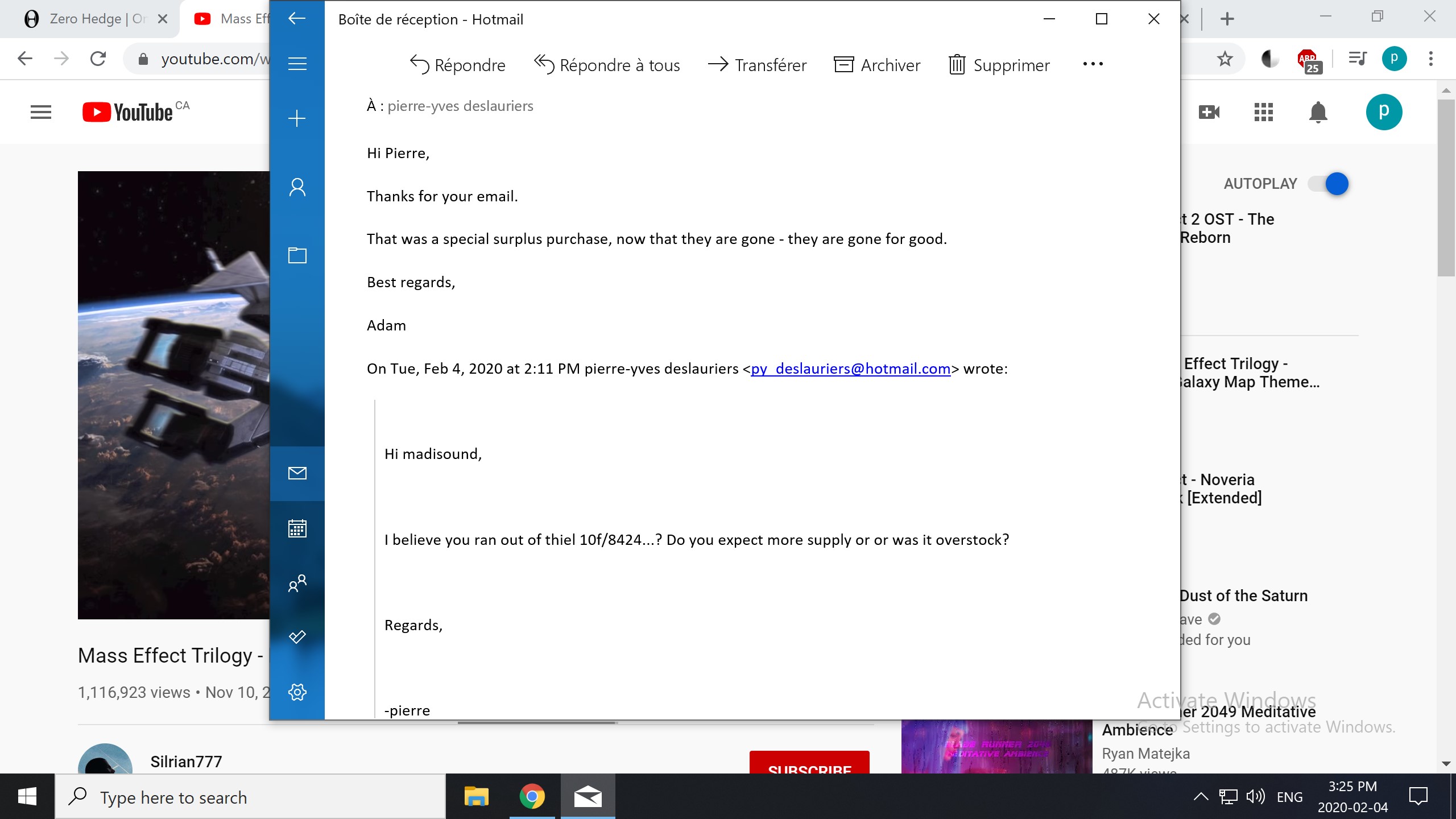

nooooooo the thile 10f disappeared from Madisound! 🙁
(i was about to order them... please come back!!!)
Looks like you can still get them on ebay!
