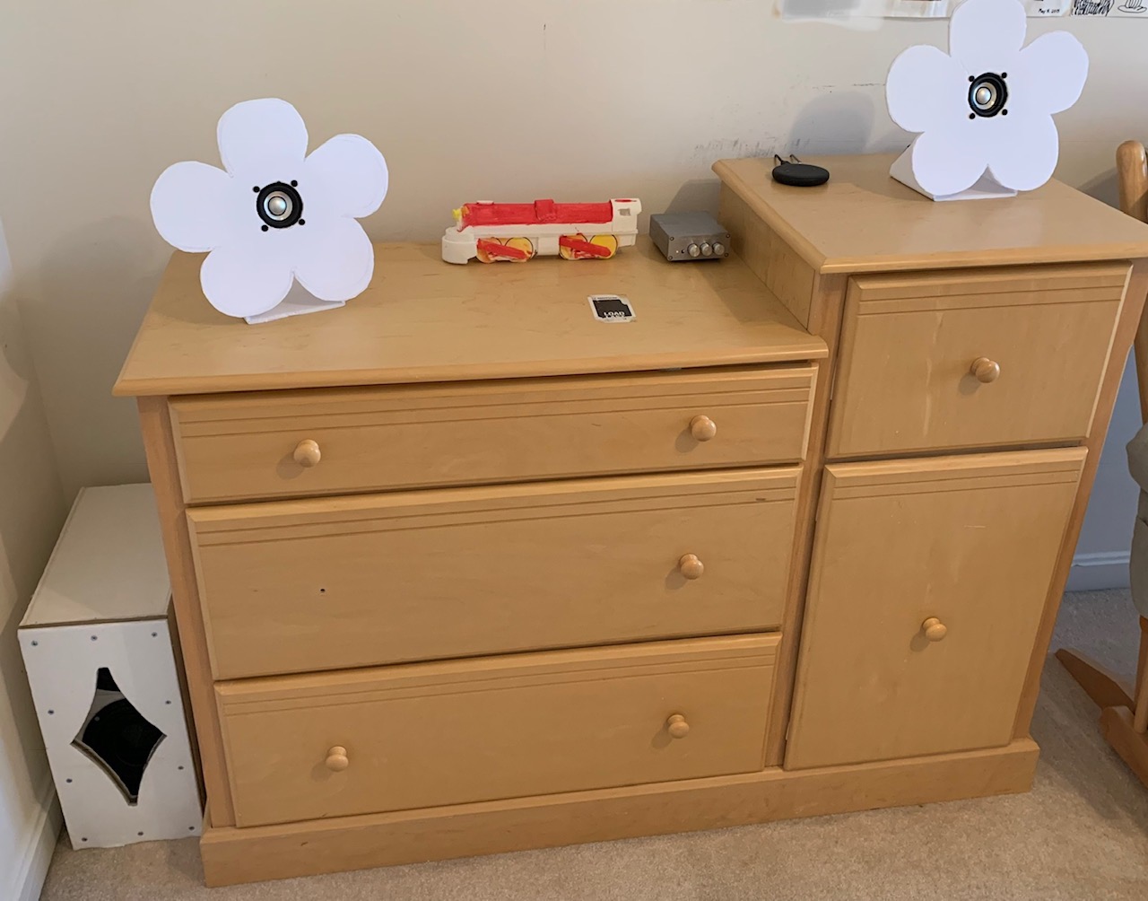

With a subwoofer located farther away, you will need to run then 10F down to 120Hz at least in order for the sub to not be localized. This will cause the 10F to have more distortion as it has to go lower and hence more cone movement. It can still sound very good.
To get a woofer to run down to 120Hz XO requires a very large and expensive inductor. You are better off using a small 2.1 Class D amp that has a subwoofer output with adjustable frequency and gain.
I do this with a small FR58EX in an OB. The same can be done for a 10F - make a small OB speaker with a stand for the desk. It can be a trapezoidal or flower shape or Fibonacci spiral. All of these minimize edge diffraction. Or you can use a Dagger if you don’t want any rear wave action.
760359d1559429986-foam-core-board-speaker-enclosures-11cff3ba-6bdc-4139-a3b2-3bc7bdec286f-jpeg
Here is the example of my flower FAST.
Foam Core Board Speaker Enclosures?
The sub is driven by the sub output of a cheap TPA3116 2.1 amp.

I was thinking a very micro fast version:
Pair of 10f sealed boxes on the desk + single 8" sub under the desk, but in the FAST style of crossover.
It may not be the purest approach but it's close.
Think to get the best feel you virtual listen to a XO-less fullranger system then XO point shall be as low as possible and will mean 10F low end knee is bit too high, its a 172Hz 2nd order butterworth (BW) using datasheet numbers but my own real world pair is lower around 153Hz area, think RS100-8 is your best friend in 1,85 ltr it perform 109Hz reach 2nd order BW and take 14 watt before reach Xmax at 95dB SPL per channel. One can also up volume to 5,56 ltr so you get a Linkwitz riley (LR) roll off at 77,6Hz that will sum flat with sub verse BW that have some ripple or peak in sum of slopes, take 3,5 watt before reach Xmax at 89dB SPL per channel which sound low but should be more than plenty at desk near field listening position, and btw 84-86dB SPL is loudest recommended listening level for a stereo pair and often track material is mastered offset to sound best there relative to our hearing equal loudness curve.
Are you sure that is a "micro fast" and not just a full range with a subwoofer? Its not going to have the major features that X emphasizes on this speaker - the very low distortion, transient perfect, low group delay, etc...
