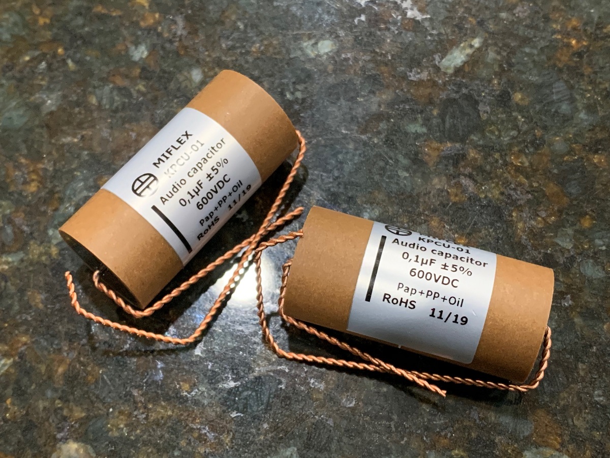

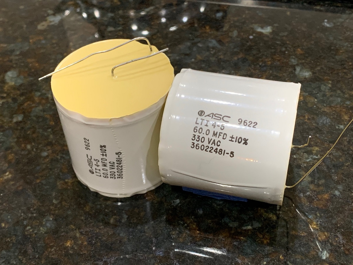

I just got a nice box of goodies from Vunce: a pair of the big fat 60uF ASC film cap, and the magical unicorn Miflex KPCU-01 paper-PP-oil 0.1uF bypass caps that Maty has been raving about. Thanks, Vunce!
Can't wait to try them out in the XO. But first have to do some other work on deadline before I can play with my speakers.
These look way cool! The Miflex exude quality - never had a cap this cool looking before! 😀
The ASC's are about 2.5in in diameter - they are huge!

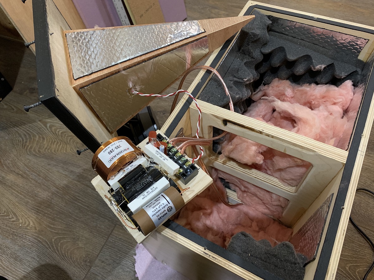

The Miflex copper foil/paper/polyethylene/oil KPCU-01 bypass cap (0.1uF) is now installed in the 10F/RS225F XO (this is my original, pre-PCB XO). Listened to a few songs and I think I hear a difference. Vocals are warmer and more resolving, imaging feels very precise. Nice caps. I have to thank Vunce for giving me a great upgrade to the sound.
With very good recordings and high DR the difference is amazing. Acoustic and electrified instruments with voices without Autotune. Of course, if you listen to studio recordings like Billie Elish... 😡

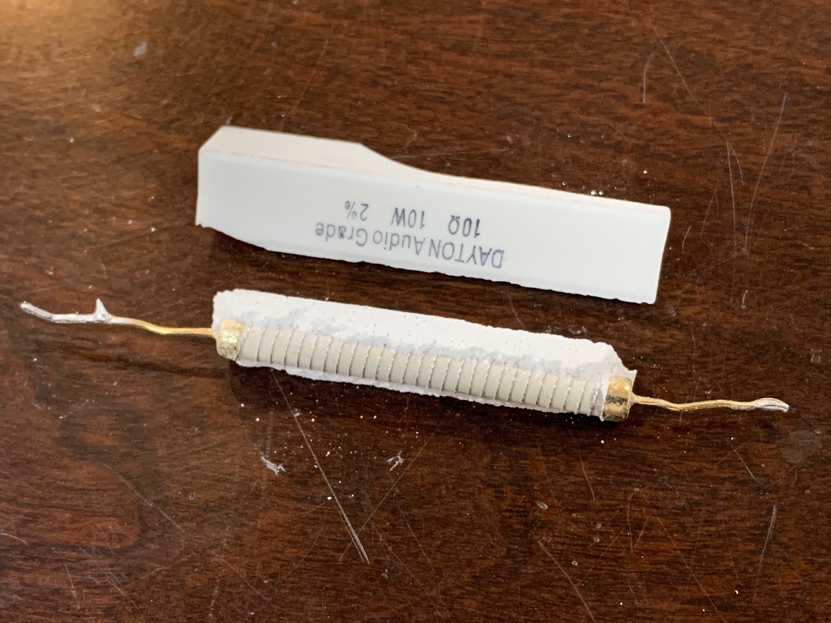

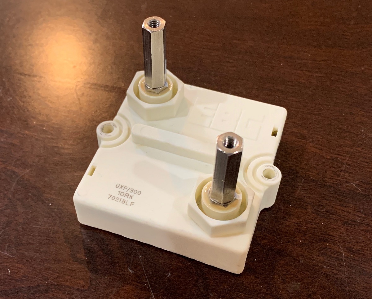

I have heard Mills resistors are very good for XO's - are they non-inductive? The basic Dayton Audio "Audio Grade" 2% tolerance cement filled resistors I have been using are supposedly non-inductive. I should measure one on my LCR meter and crack it open to see what is inside. I have used little green ceramic Vishay and they turned out to increase THD when used as source resistors on an amp. The best source resistors I have so far are KOA Speer BPR's. I might have to try getting a bunch in typical values needed for XO's.
So I sacrifieced a Dayton audio grade 10R 10W 2% XO resistor to the vise and see that the inside is a wirewound element. It measures below 0.050mH with the DATS LCR so technically, it is "non-inductive" and does not show up at the rather high 50uH level associated with practical speaker crossovers. I do know that wirewound resistors tend to be higher distortion than metal thin film or carbon film or carbon composition. I should compare this 10R Dayton with my reference ultra low distortion 300W EBG UXP/300 10RK resistor someday. But I think in terms of speaker distortion at the usual -50dB levels, this type of resistor is not going to matter. For a driver like the Purifi 6.5in midbass woofer that I will be getting (a reported -75dB aucoustic THD at 2.83v), perhaps the best resistors will ne needed to achieve the lowest possible THD?
Here is the teardown of the Dayton "Audio Grade" 10ohm 10W 2% resistor (which measured in at 4% tolerance, btw):
Here is what an ultralow distortion 10R 300W resistor looks like (normally bolted to a heatpipe CPU cooler with a fan):

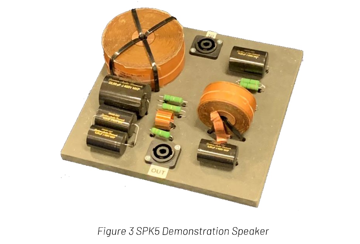

Here is the Purifi 6.5 two-way reference XO, nice wax and copper foil air core inductors, but those green resistors look like metal thick film to me. Does anyone know if these are premium resistors, and what brand?
I thought those were KOA SPR series 5w carbon film, but looking more closely at them, they don't have quite the right shape.

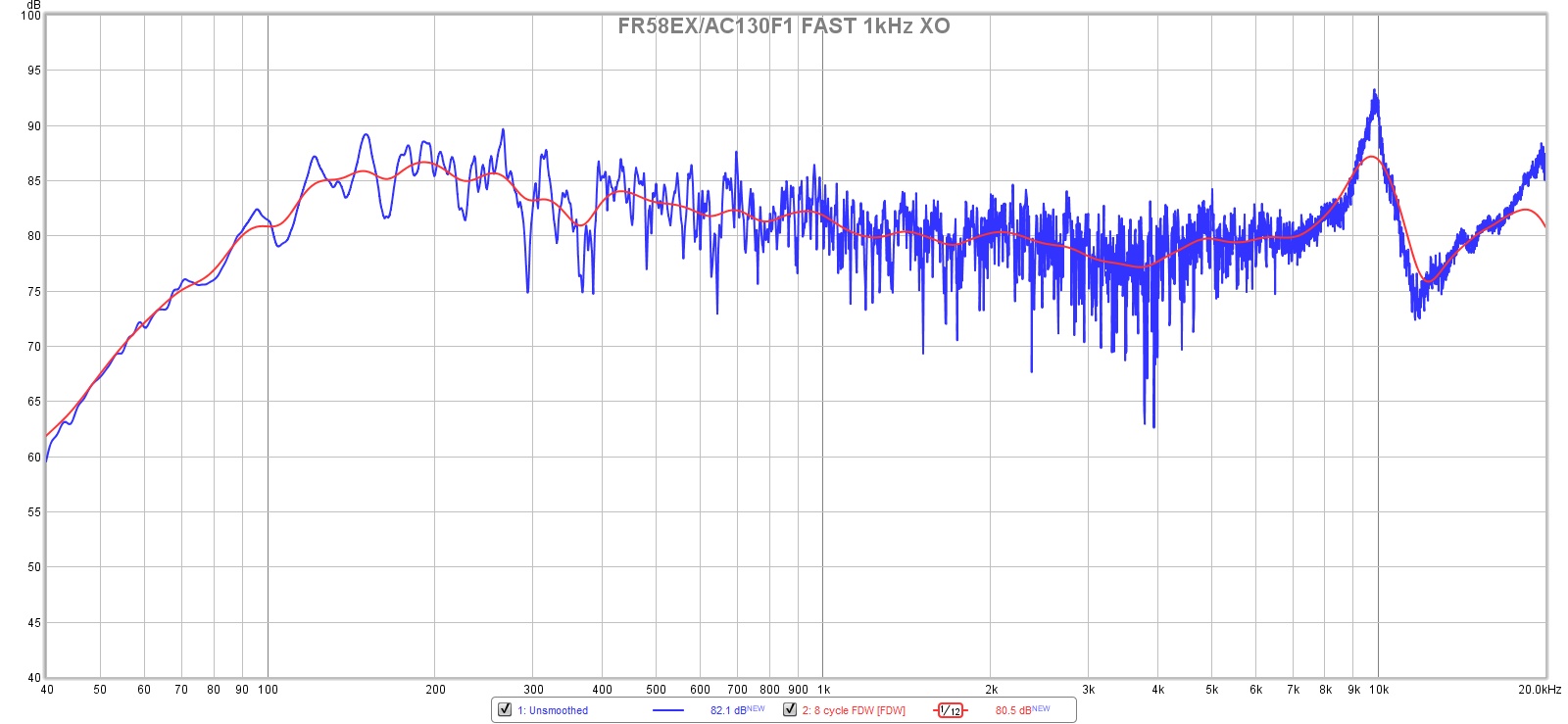

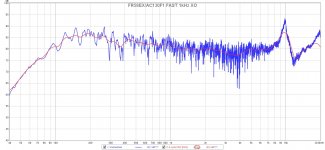

Are the fast fluctuations all long a product of mic or real measurement?
By the way the way, i recently got my hands on these little bugs...thay have the fastest more agile bass i have ever heard in any driver, ran fullrange (form limited experience i admit), but they sounds a little bit «weird», in closed of ported box, and i wonder if it it not the continuous sharp dips and spikes seen in the graphic joined.... (most pronounced around 4Khz)
