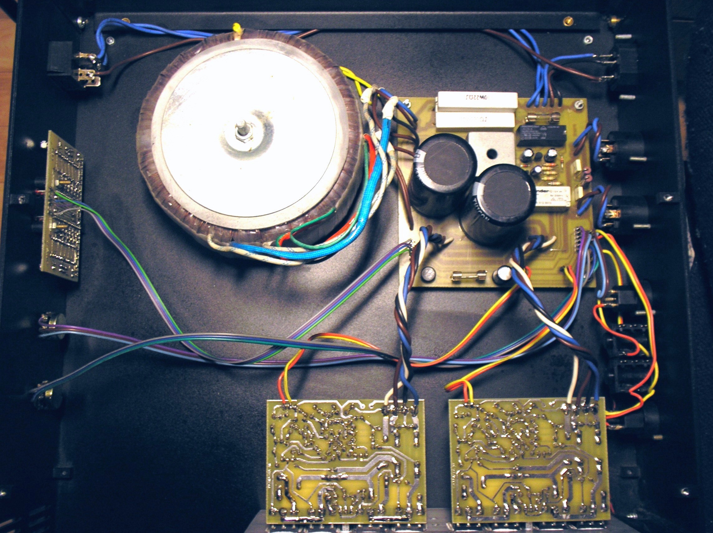

A100 pcb
Hi Apex-jr, Could you give me a little more information about the A100 pcb. Is it single sided or dual layer ? Sometimes the picture does not tell the whole story ect... Thanks Thor61
I'm Mile Slavkovic - apexaudio not Apex-jr,Hi Apex-jr, Could you give me a little more information about the A100 pcb. Is it single sided or dual layer ? Sometimes the picture does not tell the whole story ect... Thamks Thor61
Pcb for A100 is single side, and you can find it in my thread:

Looking at the 150W MOSFET Amplifier with IRFP250x2 is post 34 the one you speak of ? And is it correct to assume one should construct there own pcb's ? Also when using the 2SB1560/2SD2390 combo do I install them in the Q11-Q12, and Q13-Q14 positions ? Please accept my apology for the name mix-up Mr Mile Slavkovic ! Again thank-you for any or all help provided !
Use pcb design from http://www.diyaudio.com/forums/solid-state/163159-150w-mosfet-amplifier-irfp250x2-4.html post #34, like 'engel dela pena' post #147 in this thread,Looking at the 150W MOSFET Amplifier with IRFP250x2 is post 34 the one you speak of ? And is it correct to assume one should construct there own pcb's ?
Regards
Use 2SB1560 instead BDW84D, and 2SD2390 instead BDW83D,Looking at the 150W MOSFET Amplifier with IRFP250x2 is post 34 the one you speak of ? And is it correct to assume one should construct there own pcb's ? Also when using the 2SB1560/2SD2390 combo do I install them in the Q11-Q12, and Q13-Q14 positions ? Please accept my apology for the name mix-up Mr Mile Slavkovic ! Again thank-you for any or all help provided !
Regards

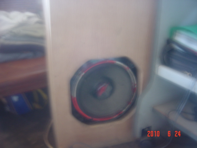

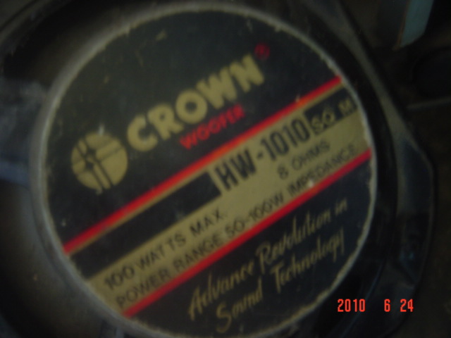

apex,
the speaker is load at the side and with 8'' long port 2'' (o.d.) at the back
sorry for darker images

You can compare sound of two different amps on your speakers, but you must get better speakers for listening all sound quality of Ultimate Fidelity Amp. This Amp is result of over 20 years research brand amps and service manuals with listening (blind test) most of them. I design this amp on single side pcb without dual FET or dual transistor on input stage, and without OP amp for DC servo. There is no SMT parts, and any diyer can build this amp, and compare with brands.apex,
