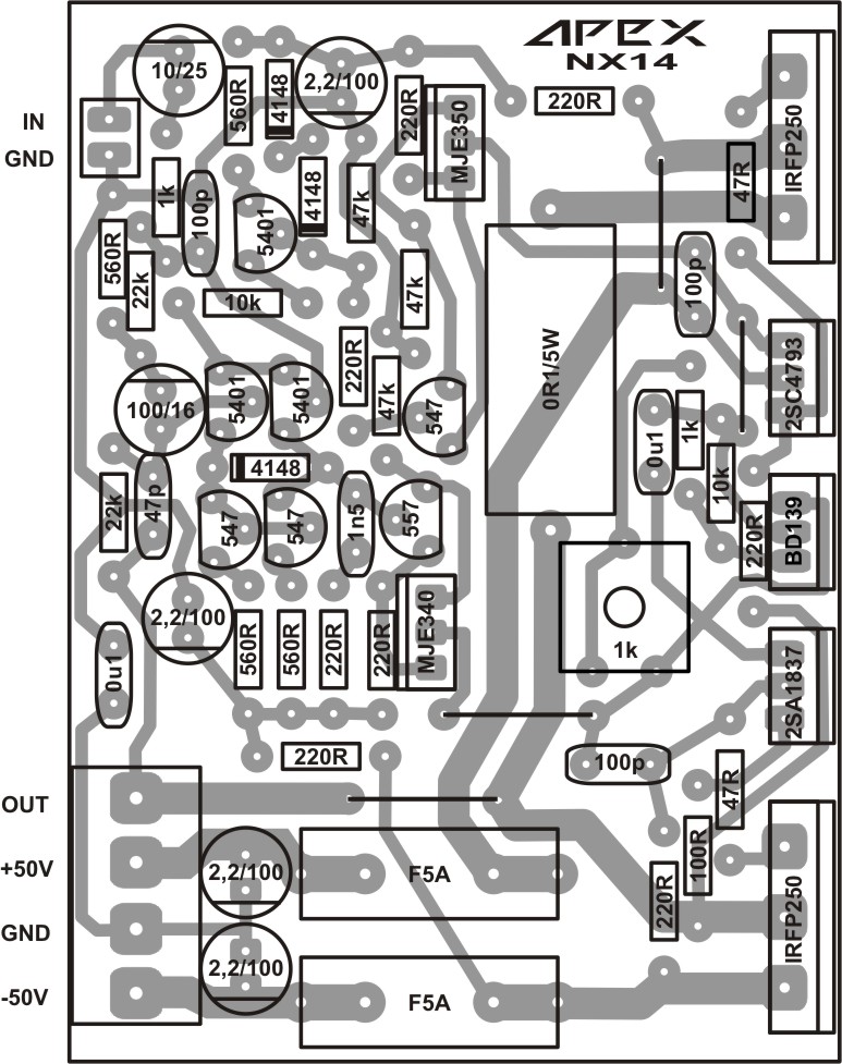

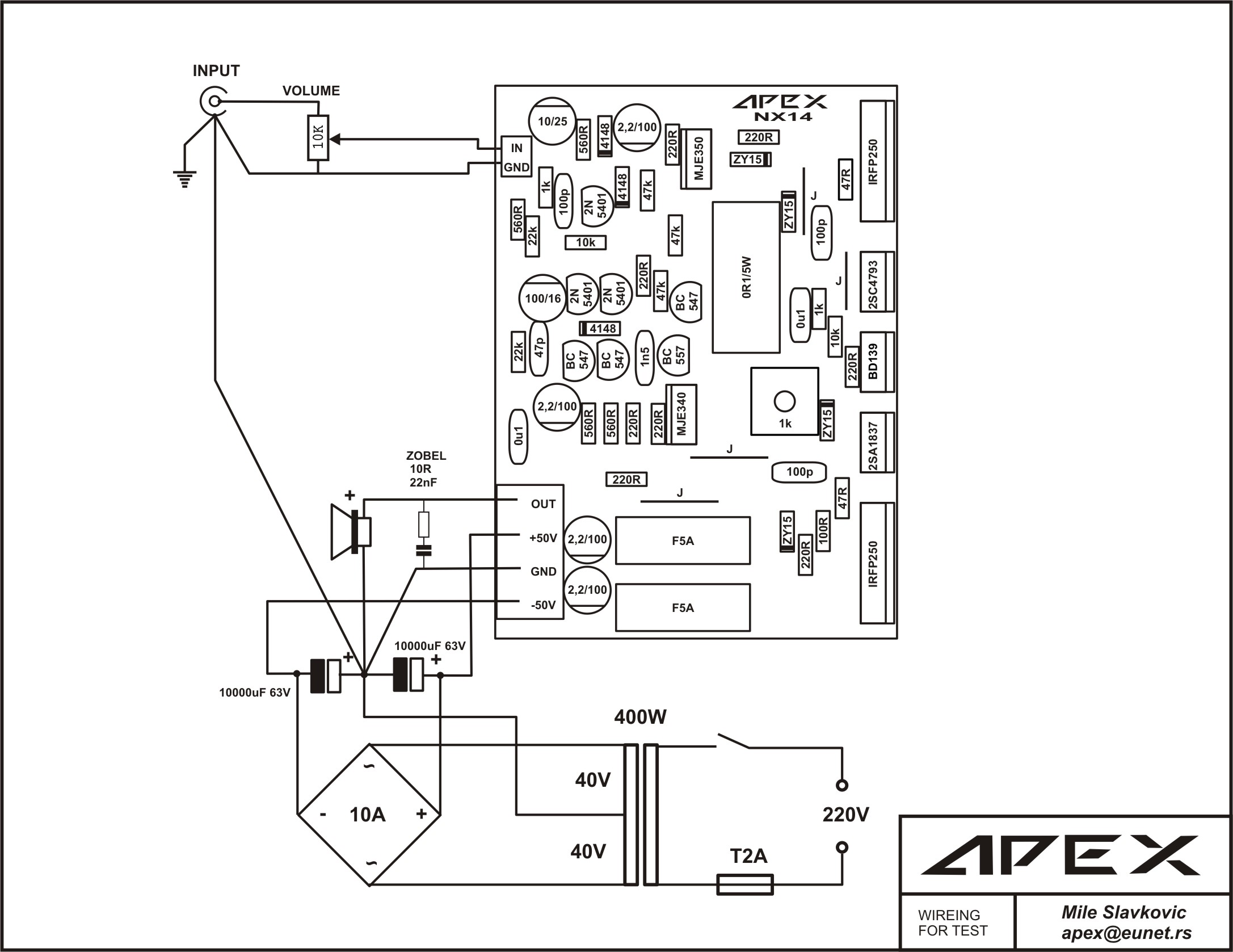

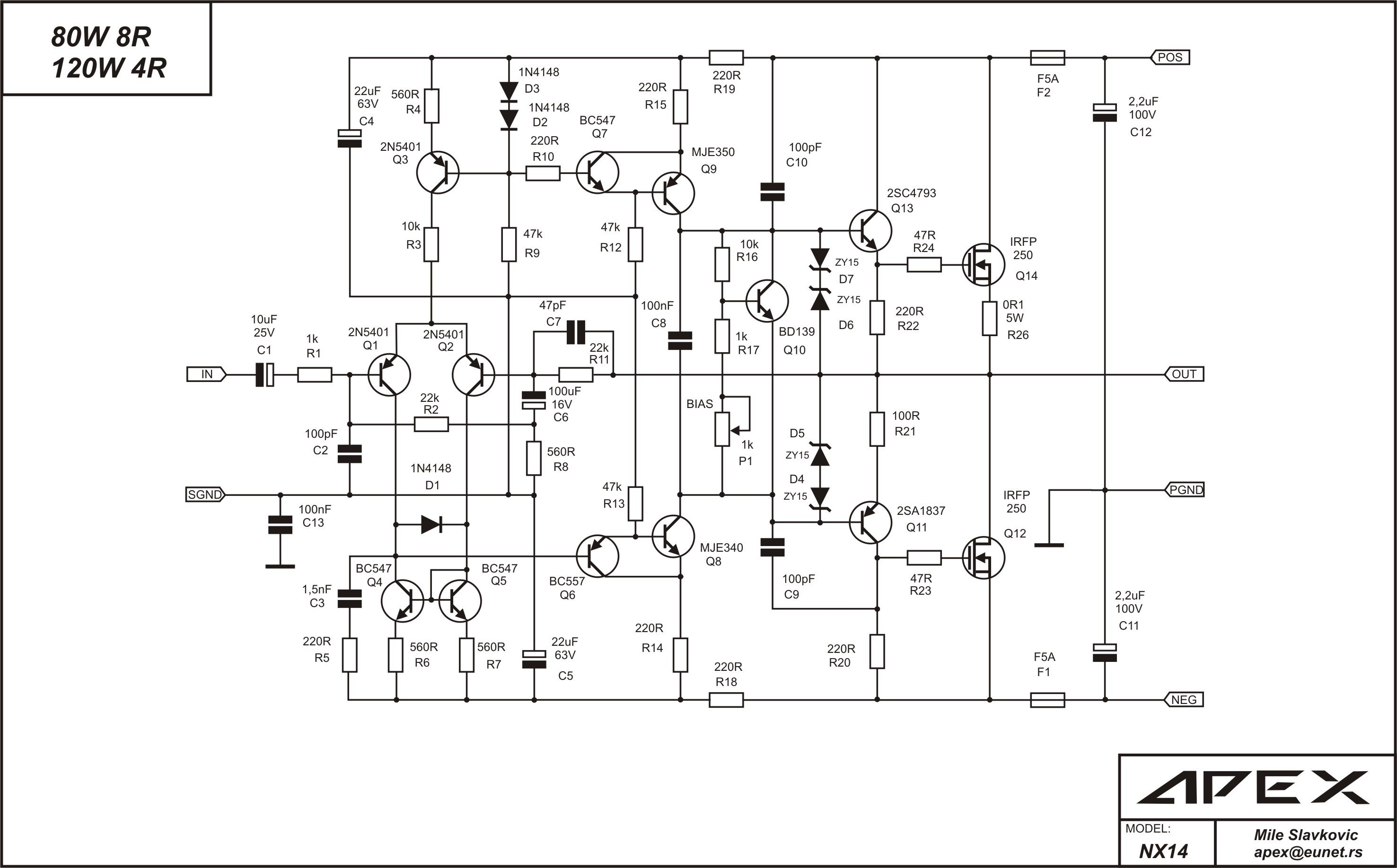

If you connect amplifier to PSU, you have DC offset on output becouse input GND must be connect to the PSU with separate wire. You can add 10R for test, and there will be not DC on output, but litle hum is posible.
If you replace R7 with a 1K preset it will null out the dc offset.
Yes that will be DC offset adjust, but I mean on reff GND for diff input, if amplifier have not input GND offset will be about 15V. Amplifier without offset adjust have only 6mV on output, 1k trimpot can oxsydate in time, and than you have higher offset than 6mV.If you replace R7 with a 1K preset it will null out the dc offset.
Regards
For 100W/8R you need 80Vpp (28v RMS), if you have +/-56V rail voltage you don't need drive MOSFETs to saturation to get that, this is HI-Fi amp extra eficiency is not important.Sorry, but how will You drive output Mosfets near limitation? Saturation voltage will be about 6-9V (Ugs needed for Id about 8A, You can not reach full output swing.
Regards

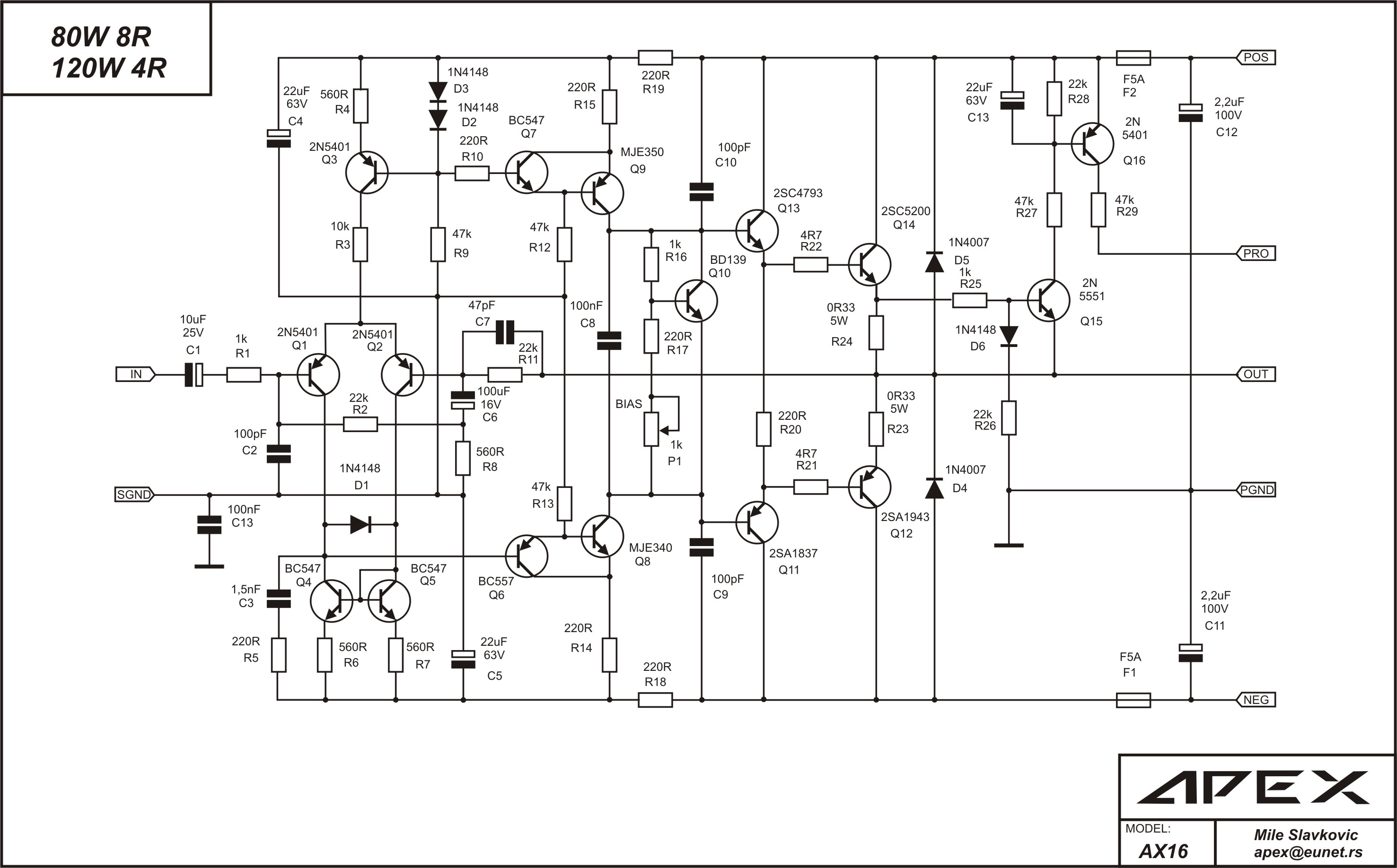

Upgrade with separate rail voltage for VAS can be done (only for FX14, for NX14 you need boostrep in positive rail), just disconnect R18,R19 (220R) from rails and connect to +/-75V DC stabilised if is posible, and you can drive MOSFETs to the saturation. I give simpliest version with available parts, but amp without upgrades and best quality parts still is Ultimate Fidelity with high performanse.
It is impossible to do it so simply in this schematic, look at driver transistors (quasicomplementary output..) Maybe with complemetary (N and P) Mosfets, but drivers must be conected to higher rails, too.just disconnect R18,R19 (220R) from rails and connect to +/-75V DC stabilised if is posible, and you can drive MOSFETs to the saturation.
Are any measurements available?
That is problem with upgrades, when you started never ending, and at the end you get new amp. You are right for drivers, but who want to upgrade amp know all that very well. Who want just to built this amp better don't change anything. I want to give ordinary diyers chance to build simple but high performance amp, that is not easy, some compromise must be done without lose sound quality. Compare with brands, and be better. Most diy amps just work, and not realy better than Pioneer, Technics, Sony... exsept for people who build it and love it becouse of that.
Regards
Regards

AX14 is 'Ultimate Fidelity Amp', FX14 and NX14 are MOSFET and QUASI (NMOS) variation with same VAS, all work great. In many threads people argue BJT vs MOSFET or vs QUASI, but with different VAS, speakers... I build and test AX14,FX14 and NX14 listen and compare sound on same speakers with same PSU, and I don't want share expiriance about that, it's your own to find.
